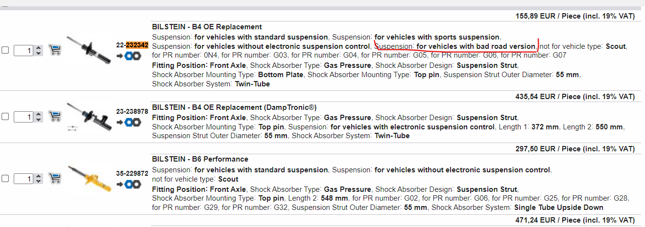

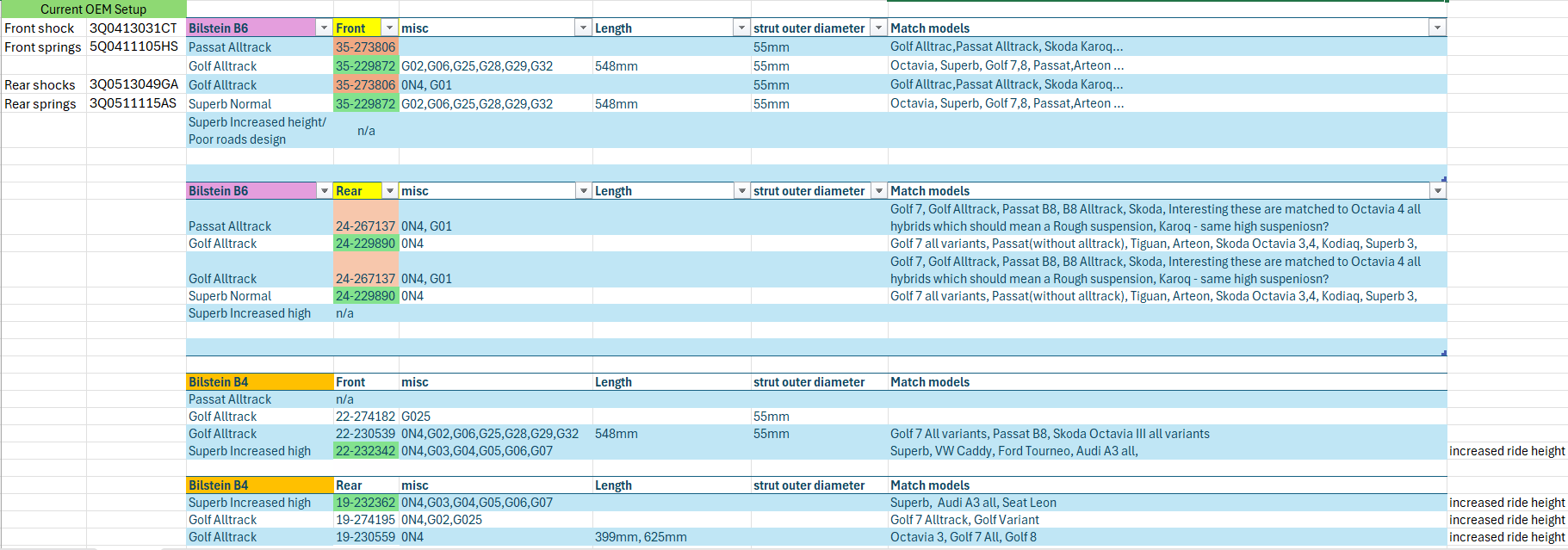

  10. The above tables doesnt mean much for me. As far as I can see there are lowering springs. I am trying to stick with the OE height - i.e. Raised than the standard one. Just receive another response from Bilstein team that states - the Scout was tested and they did not have any shocks for it 😞 Its a non ending nightmare with this suspension...
  11. Nothing again for the Alltrack shocks... Only the front says 55mm which is listed everywhere. I can imagine that all of the website are importng data from the offical bilstein database.

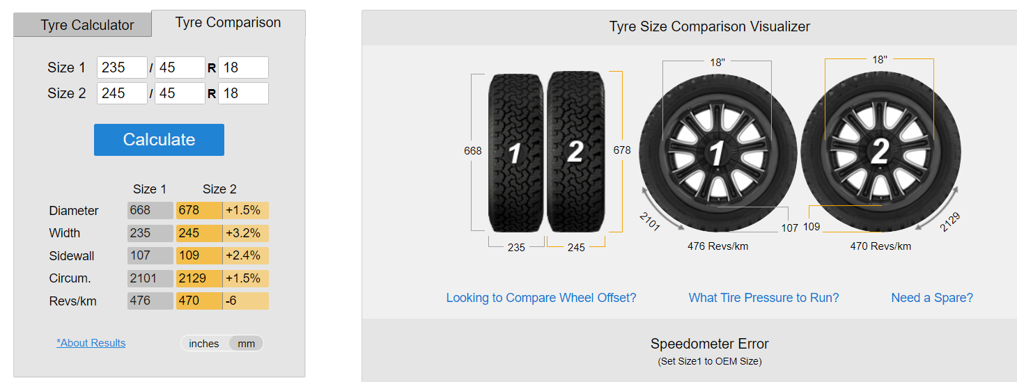

  13. That one sounds reasonable and expected to be. However, my doubts were exactly on the techincal side and due to the 100% missing technical specifications from Bilstein. Its hell of a mess with the details, fitments and part numbers. Theoritically - how do you think that the differences in the shock lenght.bump stops is going to be feel in the real driving of the car? I think you are right - the 151mm height is given for the standard suspenions but all the online catalogs are just copy pasting stuff. It is very difficult to find a correct data. So the clearance should be 166mm - this is still a difference with the Passat Alltrack but this is due to the difference in the used tyres. I think we can add some 10mm more for the passat only from the tyres. Superb 235-45-18 Passat 245-45-18 One of my latests question and theories. How would you interpretate that when we load the car 2 adults, 1 toddler and full boot space, the car ride and handling become terrible. All the road imperfections are being feel much harder and uncomfortable. The car leans much more. Does his behavior correspond to weak shocks and stiff/longer springs ? And that should be much better with a Bilstein B6?

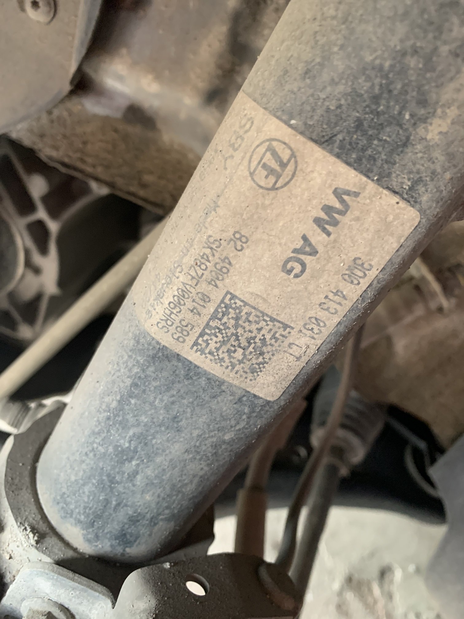

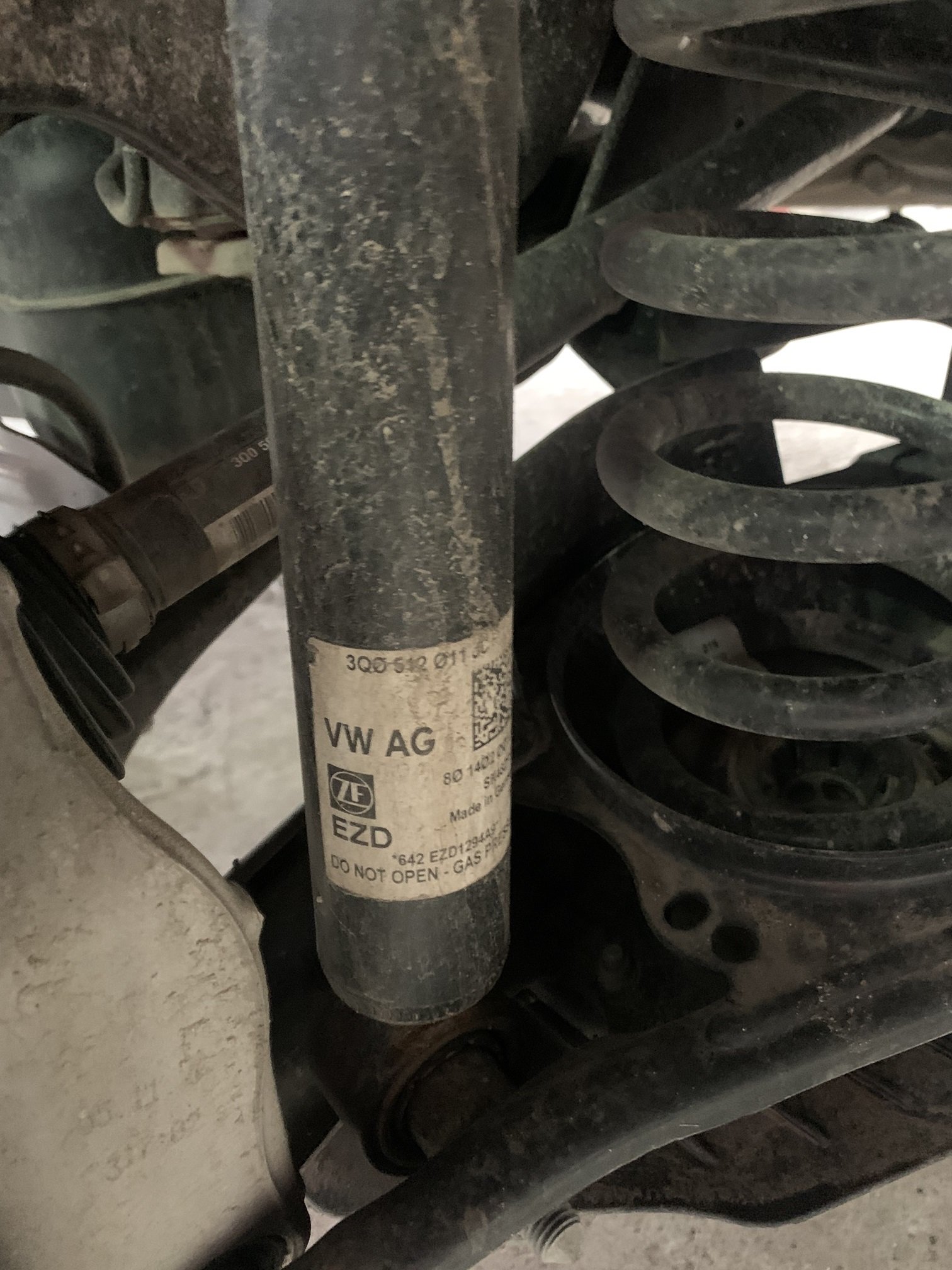

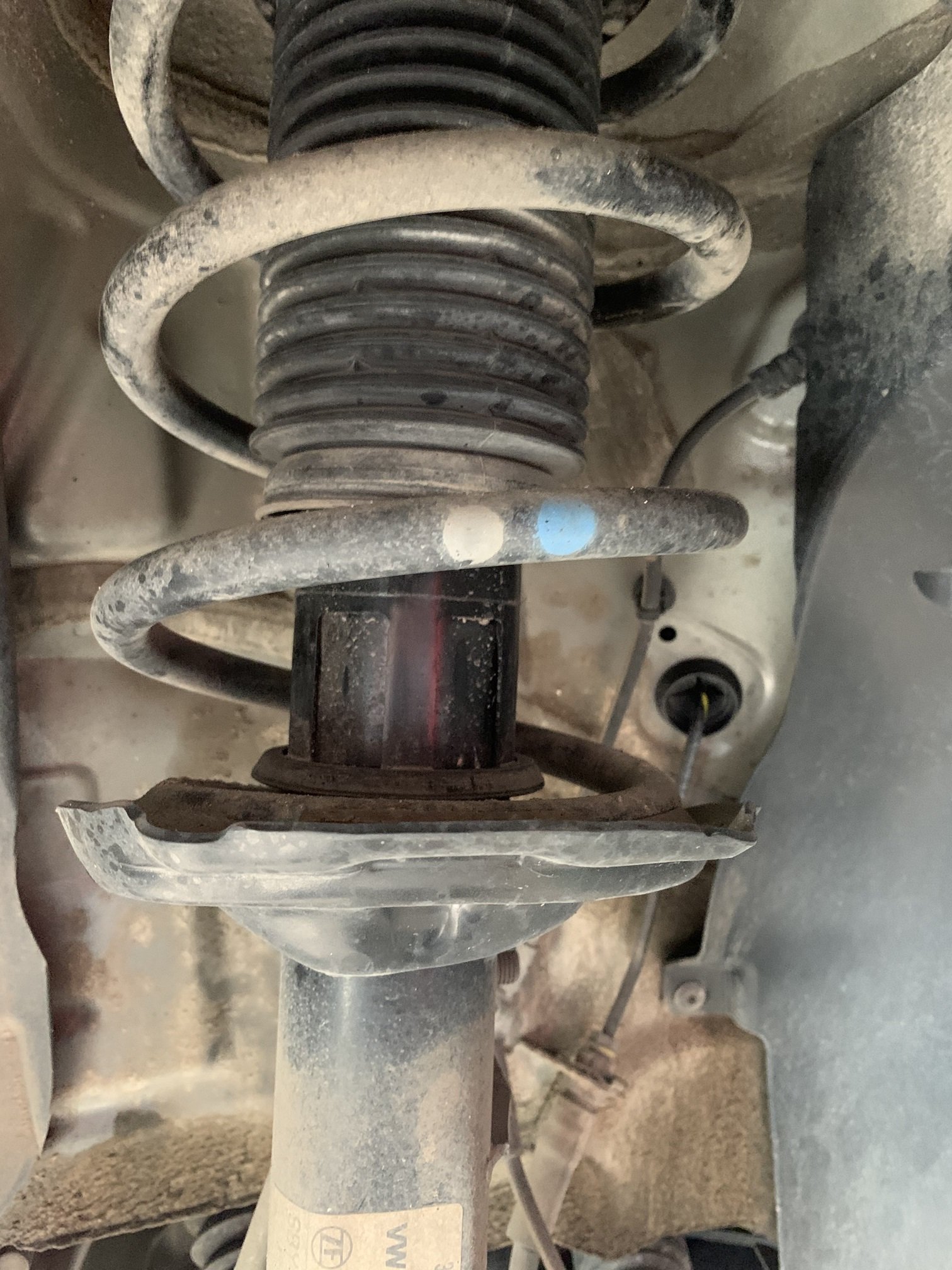

  15. A little update and info from my side. I did go to the dealer and asked what are my current suspension setup and I asked for a prat numbers: Front shocks - 3Q0413031CT Front springs - 5Q0411105HS Rear shocks - 3Q0513049GA Rear springs - 3Q0511115AS According to the front shock number - this clearly matches the Bilstein B4 but again nothing for B6... I am sure that Bilstein doesnt even know that the Scount is just a Superb with a rised suspenions/bad road. I am attaching a few pictures that I got in the past from beneath the car. Front one seems to match but am I wrong that I see a different part number on the rear shocks ? It clearly can be seen as - 3Q0512011JC by ZF ? I am confused now. According to the above information, which bilsten B6 will be most suitable to order for my Scout ?
