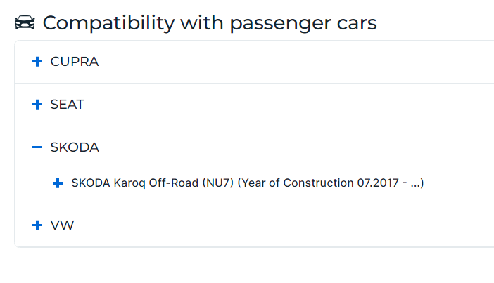

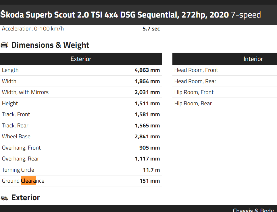

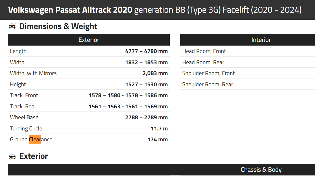

Is there any possibilities that the passat alltrack B6 version is logner than the Skoda Superb standard ride height one? I am curious from where the differences in the ground clearence comes for the Superb Scout, Passat Alltrack and Skoda Karoq: Karoq 172 mm Passat Alltrack 174 Superb Scout 151 mm There is clearly something related between the Karoq and Passat - just as it is stated and pointed that the Bilstein B6 35-273806 is for. Hows that possible that there is not a single word about the technical data and size for Bilstein suspenions? Do you think there can be any major differnces in the sizes between the two versions B6 - Skoda Superb standard height and the passat/karoq? -

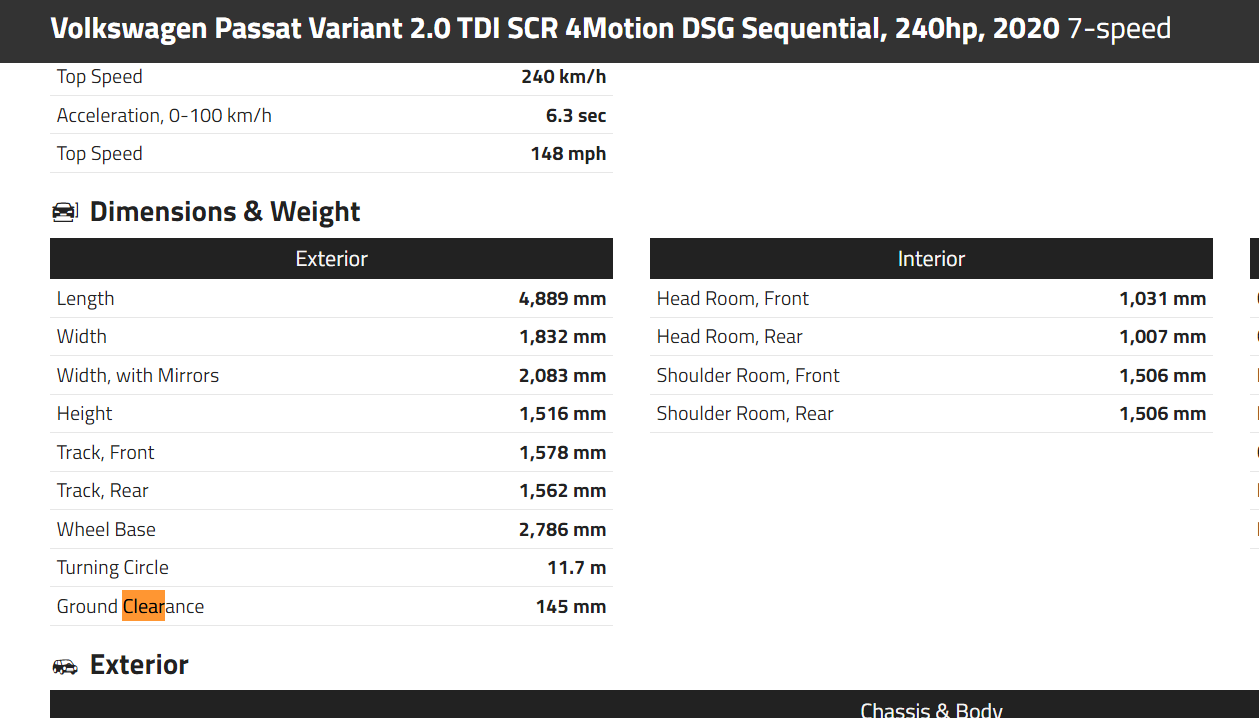

I am not sure that the comparision between Alltrack and Scout is correct because as far as I have seen an Alltrack - it looks higher than my Skoda. Also the regular Passat estate is also lower than the Alltrack: Now, about the link above for the Alltrack version of B6. Its strange that according to the site above, the shown B6s are fitted to VW Alltrack series eg - Golf, Passat, even Tiguan, and for Skoda - only for Karoq. So considering that the Passat Alltrack is higher than Skoda Scout, and the presented part is also fitted to a SUV like Tiguan and Cupra Forementor, Seat Ateca - can we judge that this is not proper replacement for the Superb even with higher suspension ? May be the 'normal' B6 version for Skoda will be better approach? Sadly, It seems there is no website containing that Bilstein B6 Alltrack dampers what size are they to compare with B6 for Skoda Superb - even the official Bilstein site... -

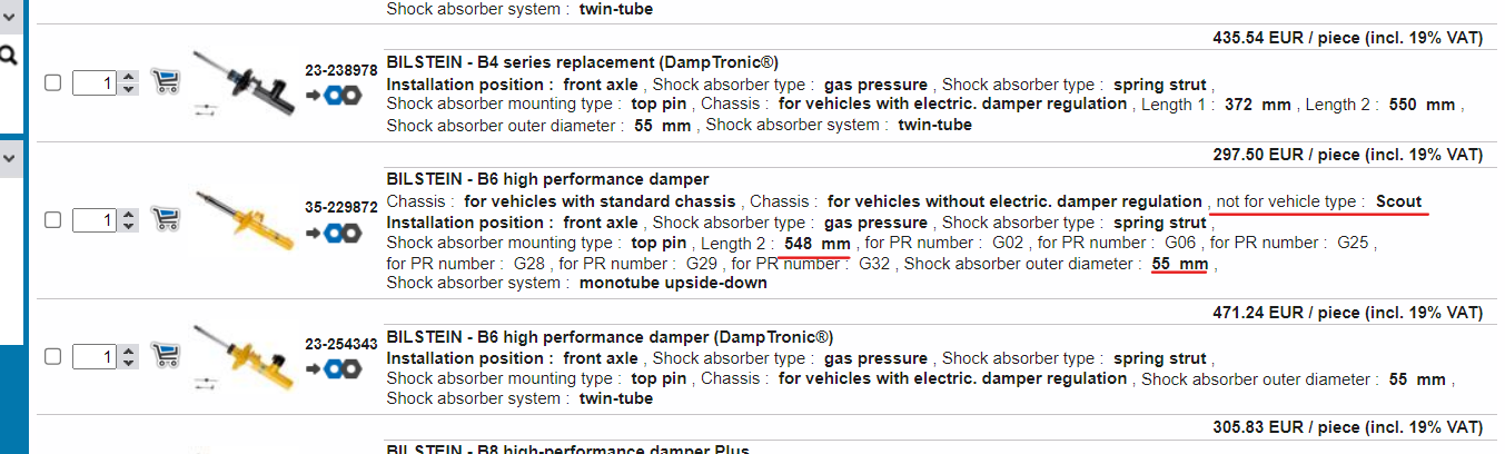

Tonies replied to Tonies's topic in Skoda Superb Mk III (2015 - 2023)

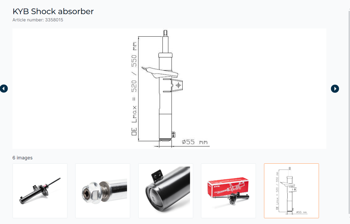

As far as I can see for Bilstein - this is the part number that is needed for my Wagon - 35-229872. I did some research and we can see the sizes here 548mm: Also we can notice the specified NOT FOR - Scout ... However, According to the sizes because If I compare it to the KYB 3358015 above front size is from 520mm to 550mm (550mm that is supposed to be the size for the Raised vehicle ) - it means that B6 should also fit on the OE springs ? -
