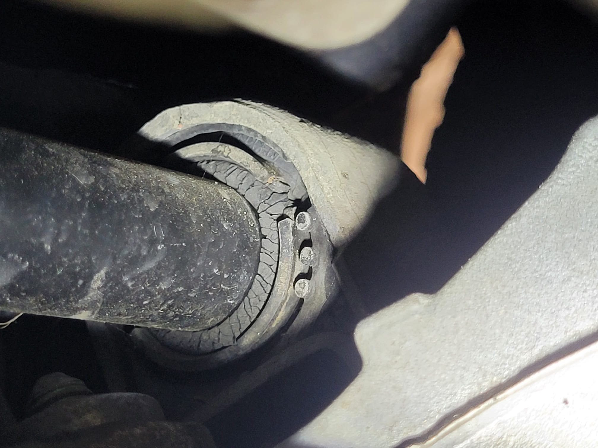

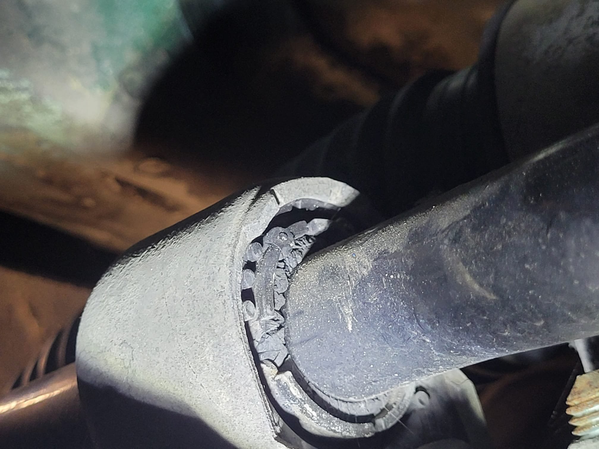

  1. So I checked some more components. Looks to me like the steering shaft has play and this is possibly causing the noise (see video). On top of that the anti roll bar bushing are shot (pics), though I'm not sure if that's causing the noise (I tried prying at the roll bar with a pry bar at those bushings and there was no movement - maybe this is not enough though). I'll keep looking into this and update when I know more. WhatsApp Video 2025-02-17 at 23.59.43_50ba850b.mp4

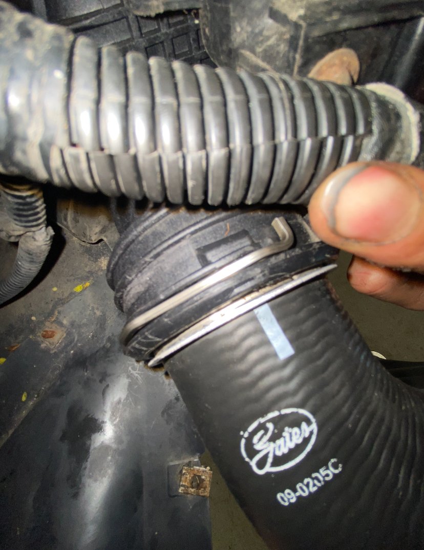

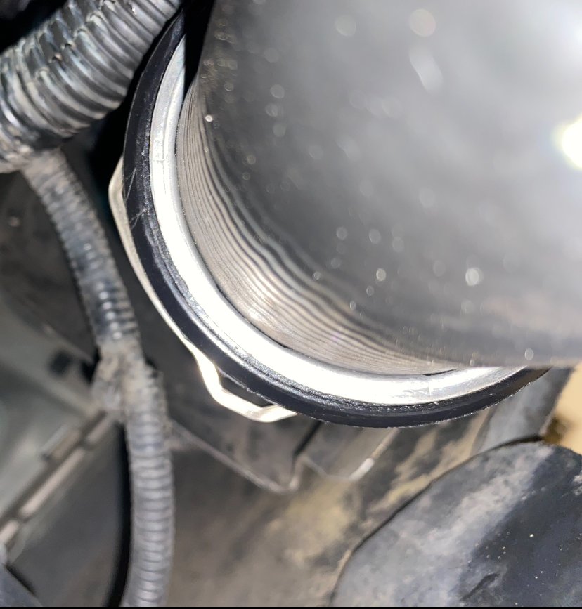

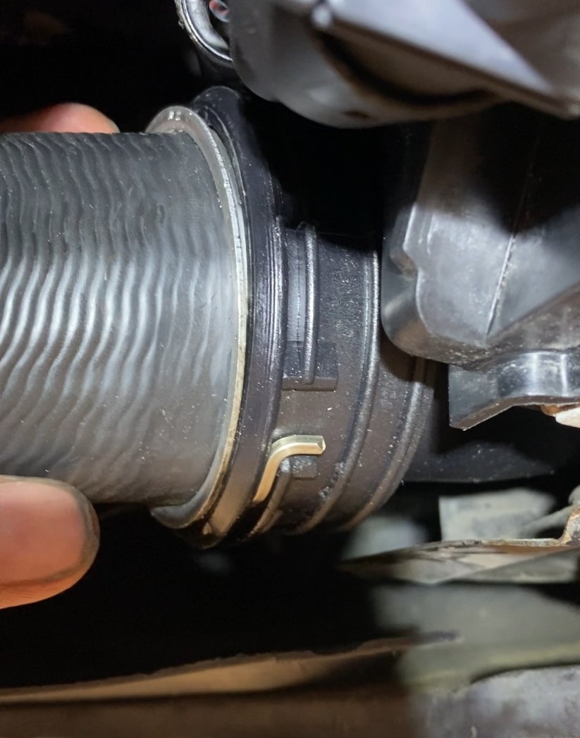

  6. Hey, I need to change the right hand side driveshaft in my 2006 Octavia mk2 DSG BKD. I know there are several types of driveshafts/CV axles used on these models and as far as I can tell mine is "CV outer joint, tripod inner joint housing bolted to transmission drive flange" as Haynes puts it. Here's what it looks like: I know the bolts are single use and I need new ones, unfortunately my new driveshaft came with a new hub bolt but not the six gearbox flange bolts so I need to buy replacements. I've measured them and they're M8 and around 33mm total length. I've now spent hours searching and still I cannot figure out what the correct VW part number is. According to this parts diagram it would be N90991002 but that can't be right because it's an M10, not an M8. I've been able to find some M8's but then they're too long, 50mm for instance. Can anyone help me figure out what part number these actually are? Thanks
  7. Turns out that both the clips the shop used (presumably came with new intercooler they installed?) AND the new clips delivered with my Gates boost hoses were not the right size, just a bit too small. I looked up the exact part number clips for my car, then based on that I found and bought Febi Bilstein 49756 and those fit perfectly.
