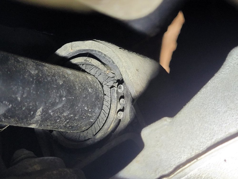

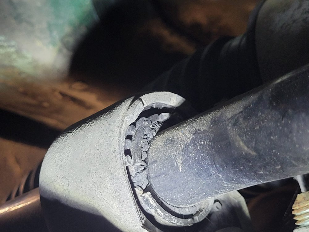

On top of that the anti roll bar bushing are shot (pics), though I'm not sure if that's causing the noise (I tried prying at the roll bar with a pry bar at those bushings and there was no movement - maybe this is not enough though).
I'll keep looking into this and update when I know more.

Bushes look a bit past it but if theres no movement should be ok. About as good as mine and they got through an MOT The clunk is when you turn wheel when stopped so doubt it would be them. Best option is to get someone else to listen around car to pinpoint area its coming from. Check its not a top mount as well. Have had a few that click and clunk especially at low speeds/parking
