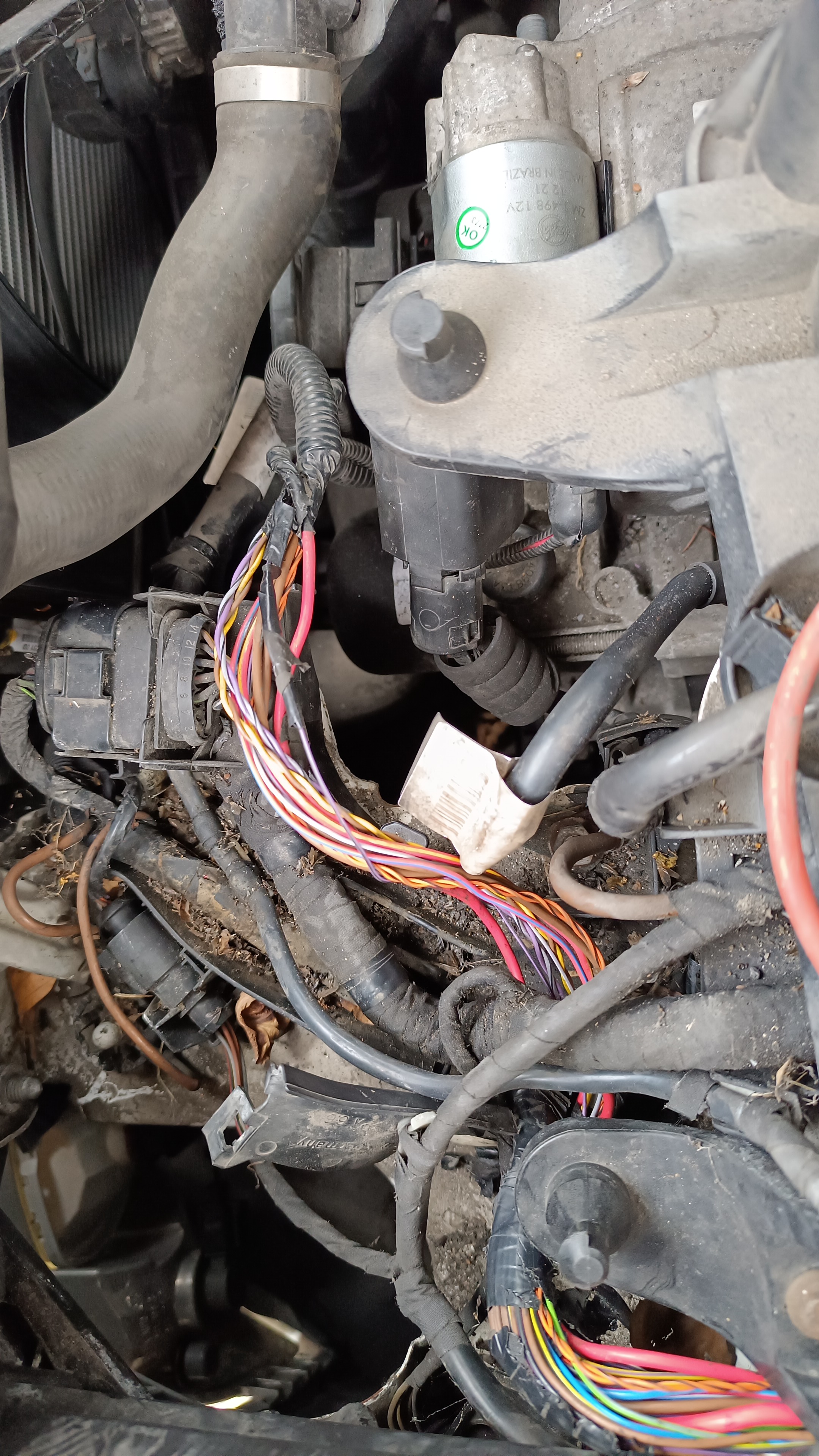

  1. The starter relay, apparently located under the dashboard, has been known to cause problems as far as I know. I had a very similar problem a few months back and it turned out to be a broken wire in a look down in front of the starter motor. I posted a thread about it here....

  4. Yeah the loom runs alongside and below the starter so my best guess is I disturbed it just enough to get it to start and throw me off in the wrong direction in diagnosing the issue! A bit of a strange one and very frustrating to figure out so hopefully this saves someone else the heartache in the future.

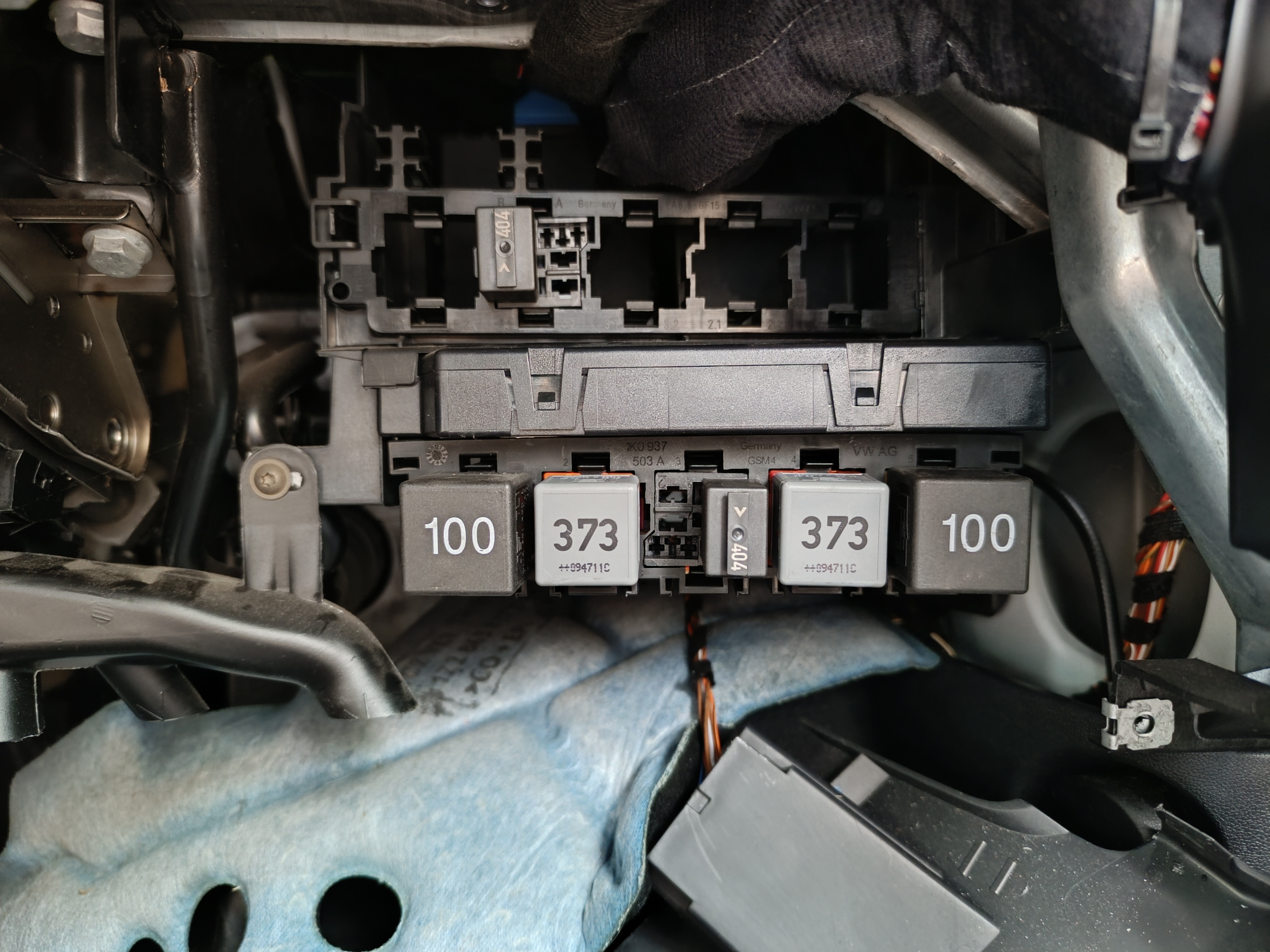

  5. Quick update for anyone else who comes across a similar issue. I think I have mine sorted now. Was checking the wiring in/around the starter and peeled apart another loom. Just happened to spot a broken wire in a loom leading towards a block connector in the gearbox. Joined the wire up and the car fired up straight away. Hopefully that's the end of the saga now. I'll post a photo below showing the wiring loom in question
