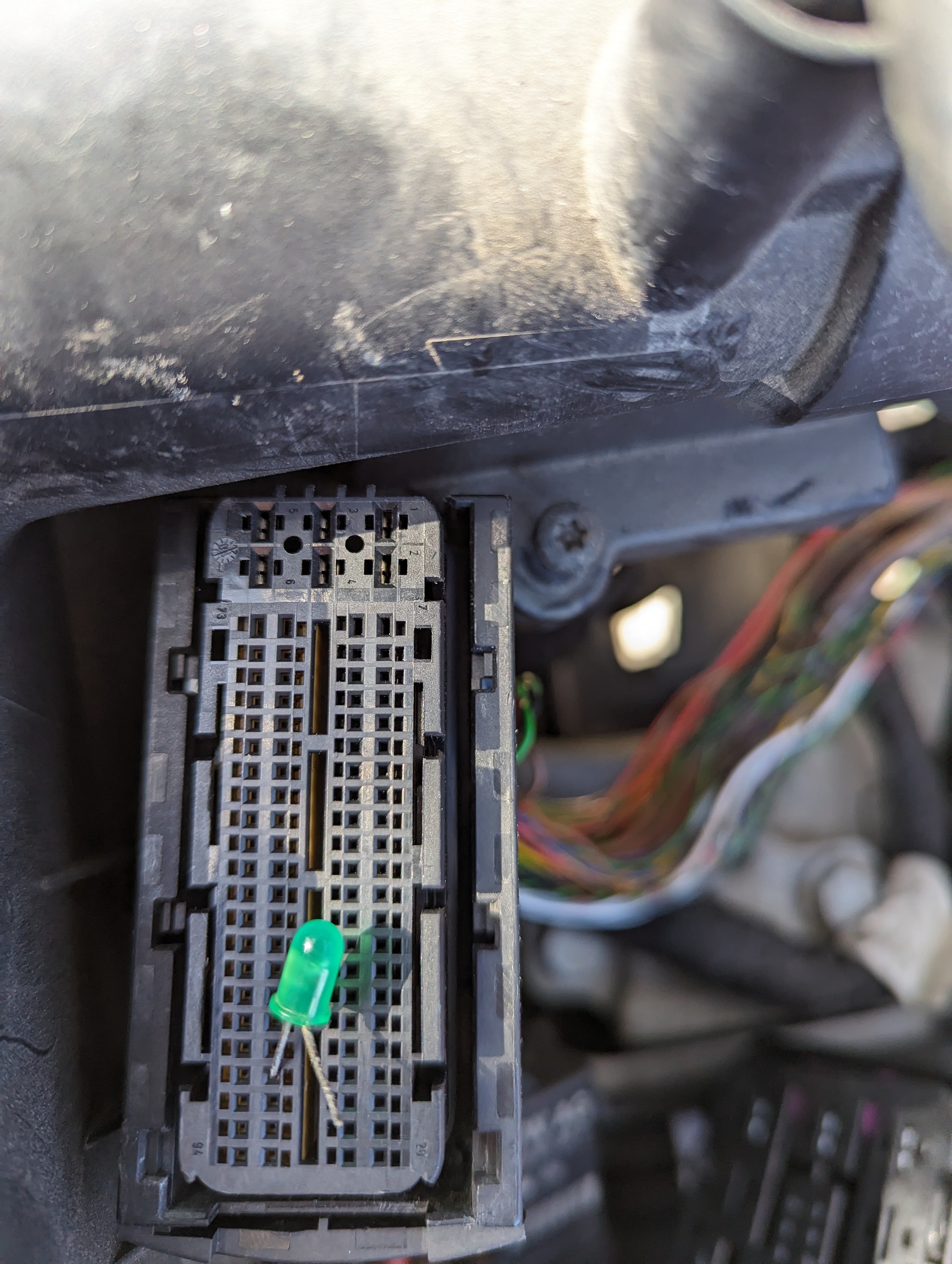

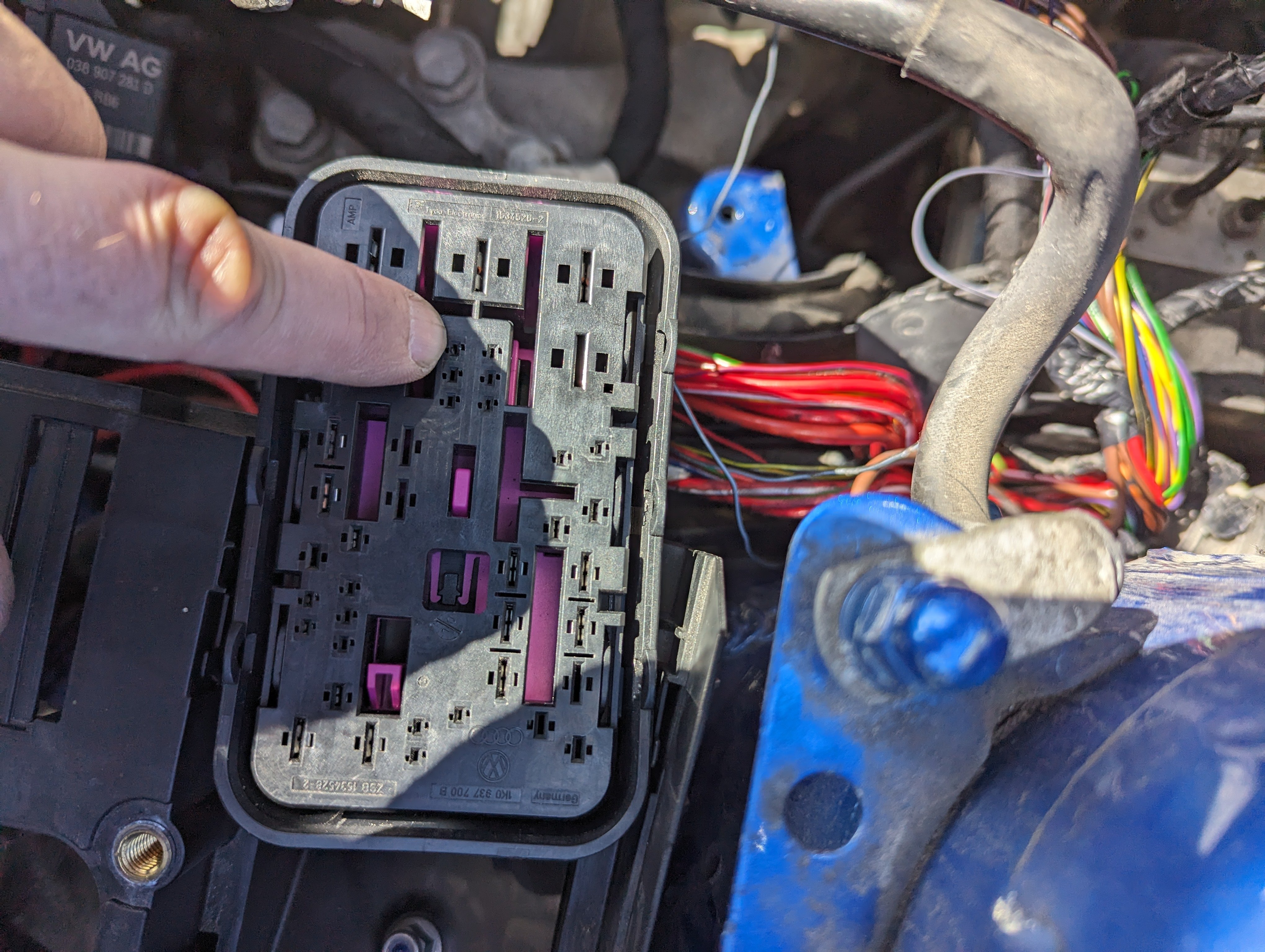

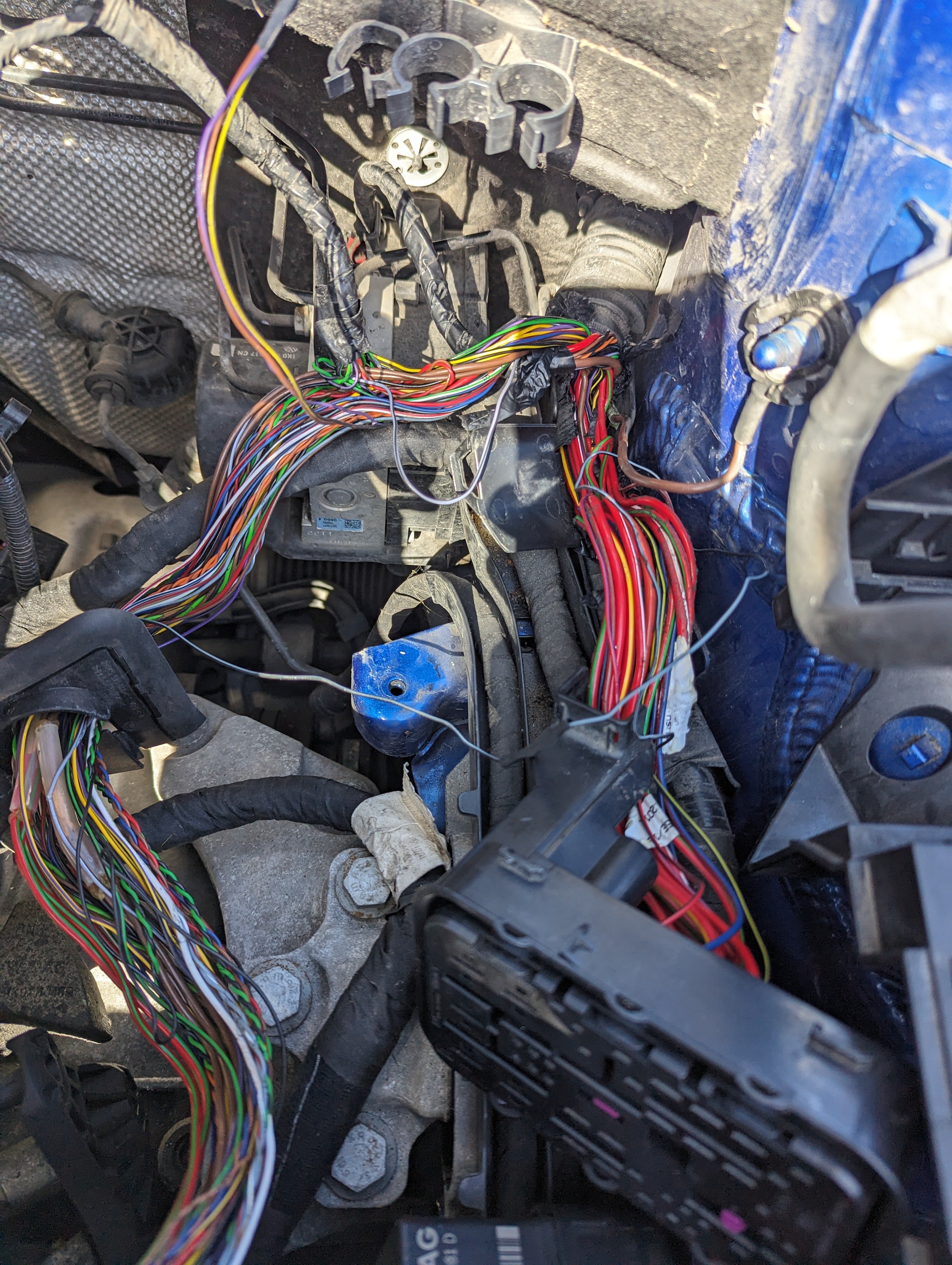

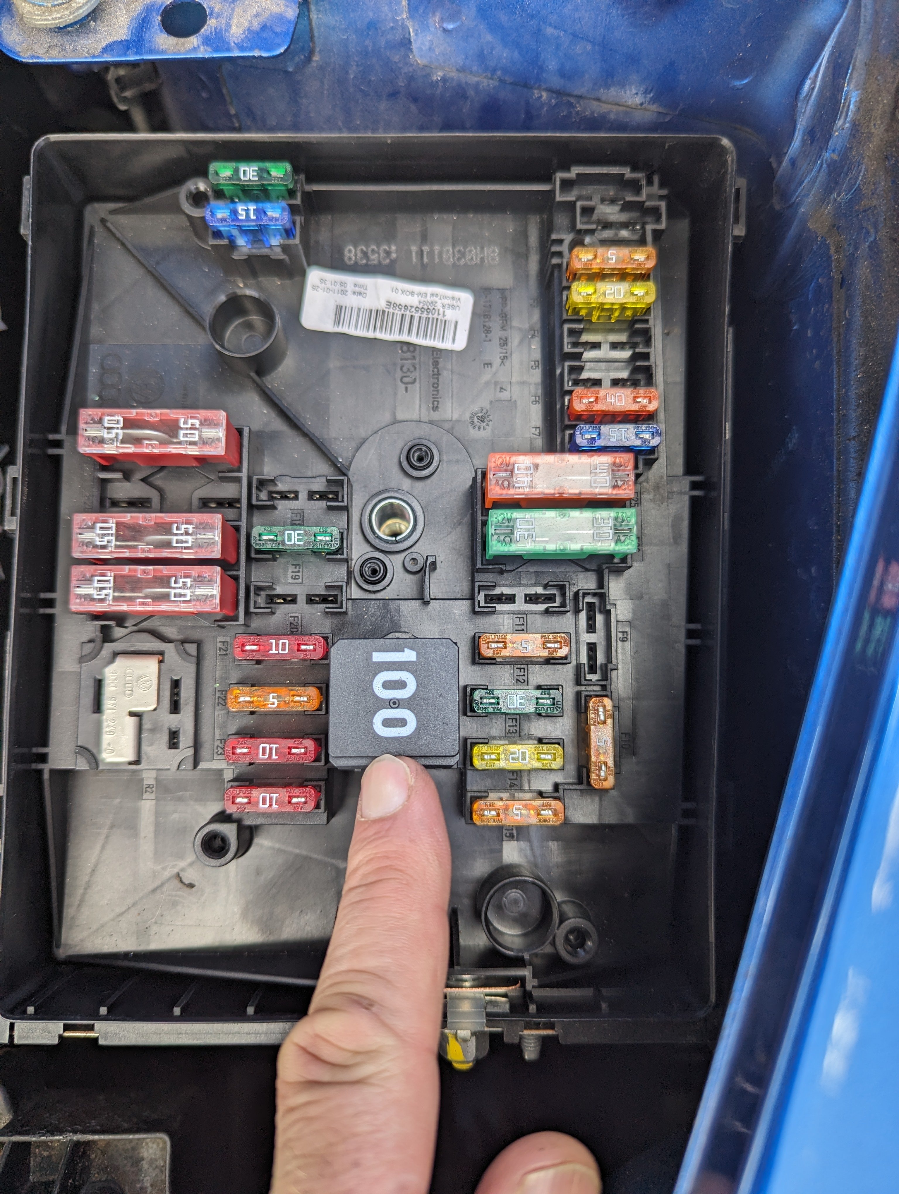

I just wanted to put an update here to the issue. What started as an intermittent millisecond power loss and then a no start, no crank is now resolved. I didn't have a negative switch to the main relay under bonnet. Traced the negative switch from Black and grey wire 4th pin as shown with led leg, this goes to the large connector on ECU. The other end is under main fuse board under bonnet.There was two brakes in cable, I re soldered and taped the connections and fixed the issue. Hope this helps anyone else with similar issue. PXL_20240424_135928432.thumb.jpg.0f88dbad4c90a5667f9bfd1f38209688.jpgPXL_20240424_135941470.thumb.jpg.9284614f2c8f92aa3b5cd98f9e1d7320.jpgPXL_20240424_135941470.thumb.jpg.9284614f2c8f92aa3b5cd98f9e1d7320.jpgPXL_20240424_135916959.thumb.jpg.d81d2101ee6da26f919204eb0736c537.jpgPXL_20240424_135928432.thumb.jpg.0f88dbad4c90a5667f9bfd1f38209688.jpg
