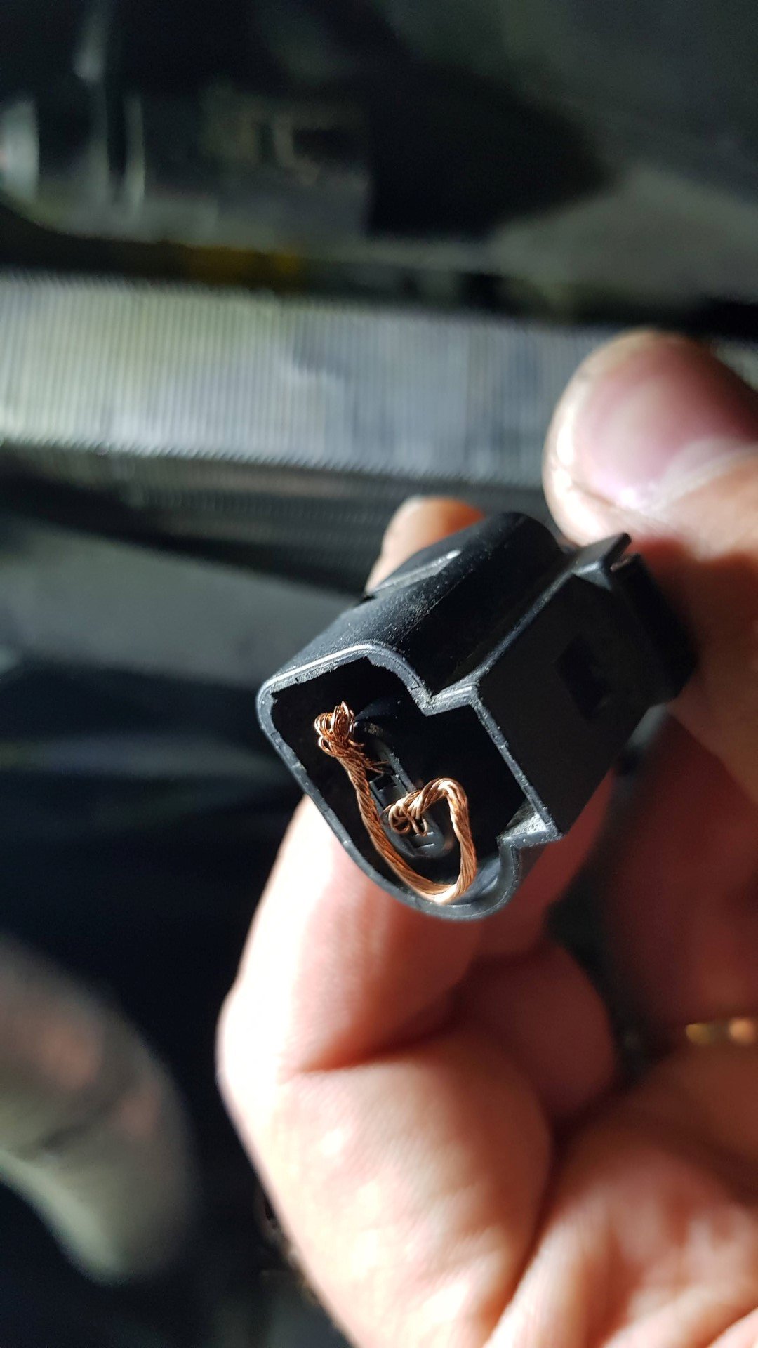

  4. Wipers problem has been fully solved. As I mentioned before, in my opinion right arm in relay was sticked to uper (ground ?) terminal. And my wipers didn't work in Intermittent mode because somebody made jumper in hood switch. He probably was faiting with wipers problem and wanted to cheat the system, but did it in opposite way. After remove jumper all wiper modes work properly. Hood switch is also good. Thank you guys.

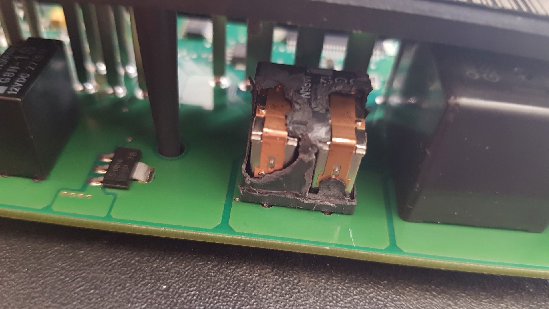

  6. I opened relay body. In my opinion one terminal was sticked to ground terminal. After some pushes it sarted move. To make sure I cleaned termainals with 2000 sand paper, there wasn't oxidation on paper, and finally wipers work on second and third gear. Don't work on interruped gear. I have this car for two days and I don't think it has automatic wipers, which on only when it's raining. How to check if car own automatic wipers, or what else can be broken? Car has standard manual mirror without any sensor/cables.

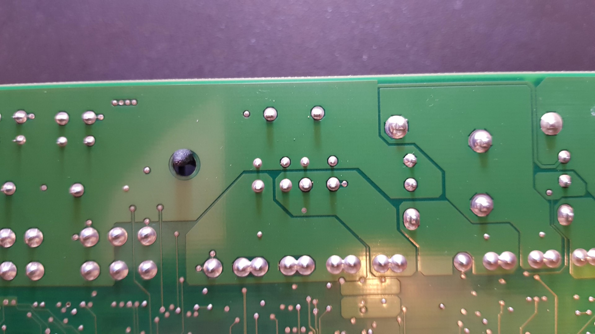

  7. Board 6Q1937049F looks much less safe to solder than older ones. Probably i will buy used 6Q1937049F - cost around 50 Euro.

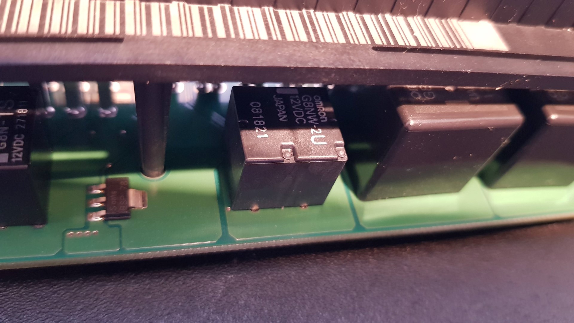

  8. Do 6Q1937049C and 6Q1937049F use the same relays inside? 6Q1937049C is much cheaper than 6Q1937049F and probably it would be a good part donor. @Breezy_Pete, did you open relay wihout desoldering it from board?
