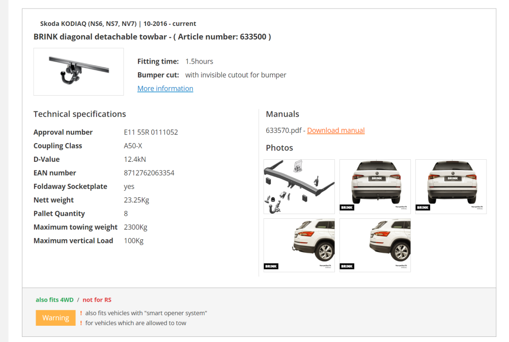

So went into the towbar shop today to order in the actual towbar, which was going to be a: Brink SKU BR-633500 https://brink.eu/en-gb/search-results/ about $750 Aussie and $360 for the install. But at the 11th hour they checked the specs and it says "not for RS". Which has me confused, it can fit a sportsline but not an RS? The rear spoilers are largely the same. They found me another one, but it is almost double the price and can't see how this would differ from the Brink version. https://etowbars.com/au/Towbars/Skoda/Skoda-Kodiaq-Towbars-Australia/Skoda-Kodiaq-RS-Invisible-Towbar-Oris

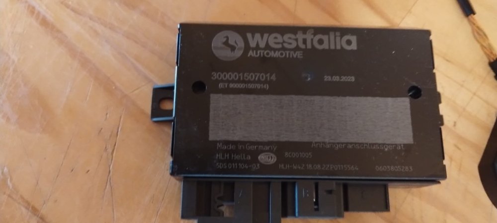

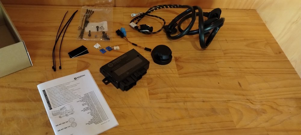

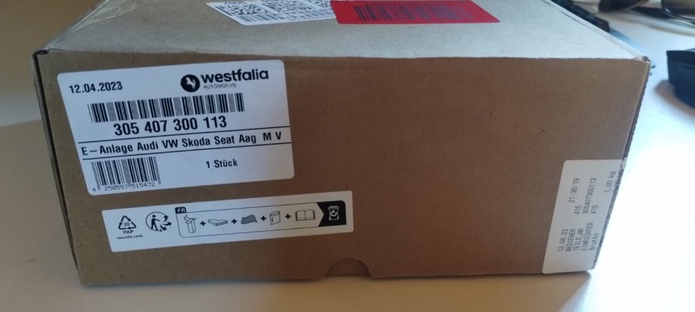

Recived the amazon package today : https://www.amazon.com.au/gp/product/B019IPYWQA/ref=ppx_od_dt_b_asin_title_s00?ie=UTF8&psc=1 Looks legit, lets hope it includes everything thats needed.
2021 Kodiaq RS - Towbar
Spoke to other VW/Skoda service center and they also quoted me $2600. He seamed embarassed at how expensive it was. Spoke to the tow bar specilist and said he could wire/install the offical module/wiring if I obtain it at no additonal install cost. Also familair with coding them in if needed, says its a mixed bag. Sometimes just work straight away, sometimes need some coding. So found this on Amazon https://www.amazon.com.au/gp/product/B019IPYWQA/ref=ppx_od_dt_b_asin_title_s00?ie=UTF8&psc=1 Part number checks out, but the images don't. Lets see what arrives in the mail. Around $250 delivered vs closer to $600 locally. Crossing fingers, but my total price will be around $1400 now, still much better than $2600 through Skoda.
