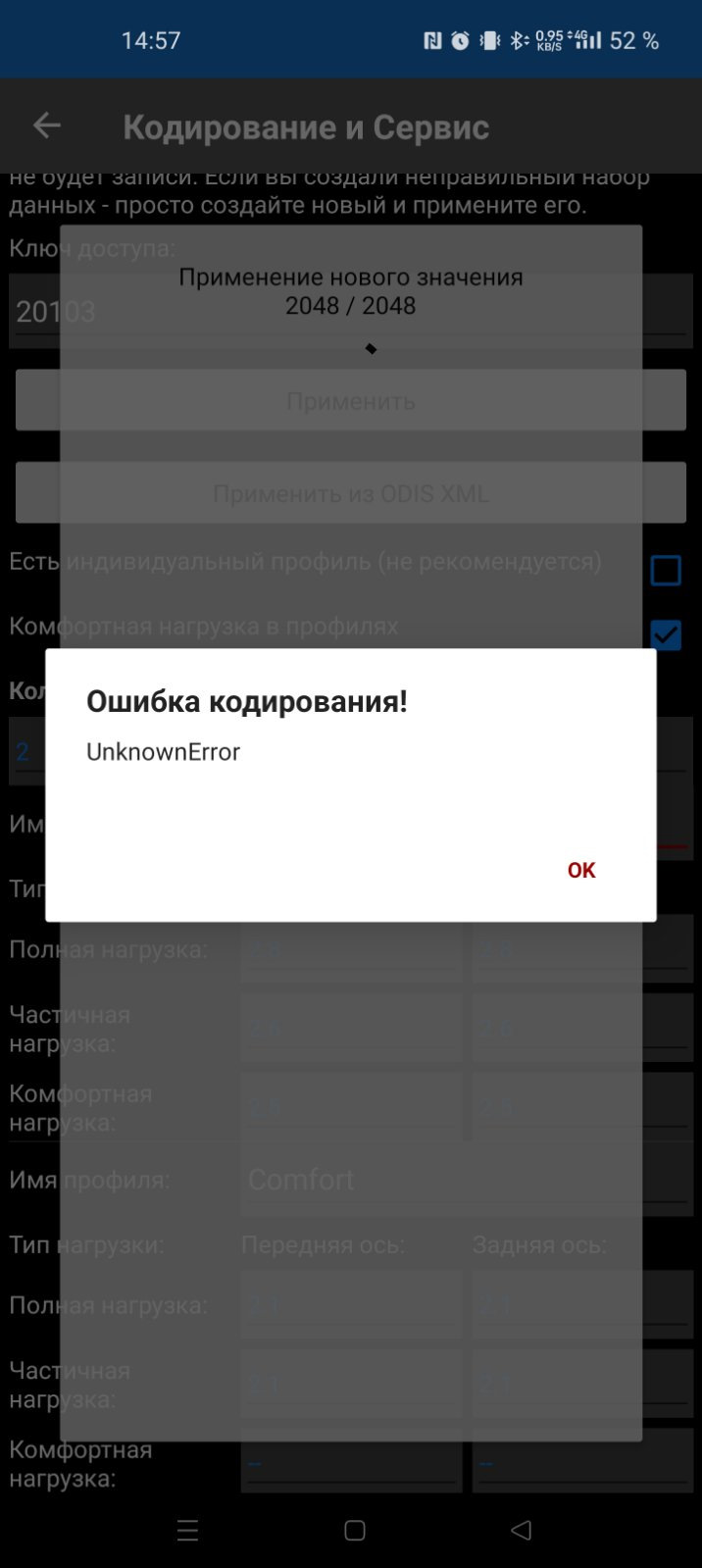

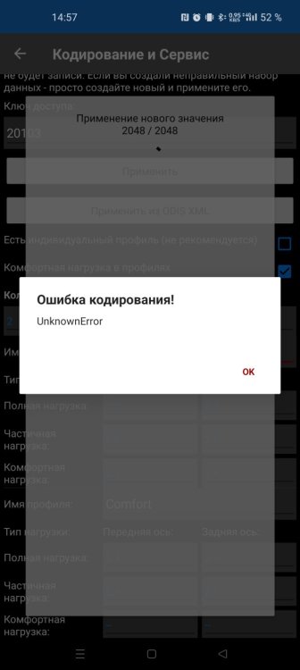

  1. Come on, give me some credit. English is not my native language, so I might have gotten something wrong. basically, i followed the instructions from here https://www.drive2.ru/l/598688480444299059/ and from here https://www.drive2.ru/l/598758024554753329/ so i changed everything in accordance with the instructions, therefore i cannot really answer to the question what exactly i changed. I used car scanner pro to upload the info, again, with the instructions from the second link. Regarding TPMS data set, this is what I did not really understand. I think the data set is also in the second link. The TPMS set was purchased on aliexpress, but it worked with other cars, as per site i gave you earlier. there was one fault, when i was trying to upload info. it does not say what exactly was the error, but it says "coding error". I hope this time I answered all your questions, so I tried to help you yo help me. Thanks
  2. I backed up with car scanner pro Than reversed the changes, but nothing changed The data set was uploaded by myself. Control module number is 5Q0907273B
  3. Dear all, the other day I installed TPMS on my 2020 Skoda Superb Estate. i mean, a service man wired everything and I tried to do the software part in order to connect the hardware with the car after i finished everything, the car saw the sensors and showed the pressure. But, the picture of the car with the tyres' pressure dissapeared. i can see only the pressure figures. the same on the virtual cockpit, it does not show the car. also, the car is not reading traffic signs anymore for some reason and the navigation doesnt start. what can i do? thanks
