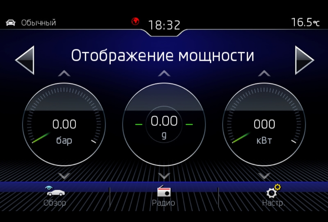

Hello, how can I turn on SPORT / PERFORMANCE MONITOR, with the coding in the video below, I did not succeed.
SUPERB 2.0CRDT 12.2022
Thank you.
AFAIK, this is only possible for Sportive versions. Not available for other ones. I've tried unsuccessfully on my MY2018 L&K.
the SWaP/FEC codes cannot b activated using ur standard VCDS or OBDEleven tools.
u need specialist tools for that, ur MIB unit needs to b hacked, and patched with the appropriate files too.
Edited by JR RS
2.0 tdi, super sport🤣. I did it on my car.
Edited by igrozan
54 minutes ago, igrozan said:
super sport
Mon smartphone automatically corrected « Sportline » into « sportive »…. 🙄
What’s the trick to do it on a non-Sportline version? TIA… 😉

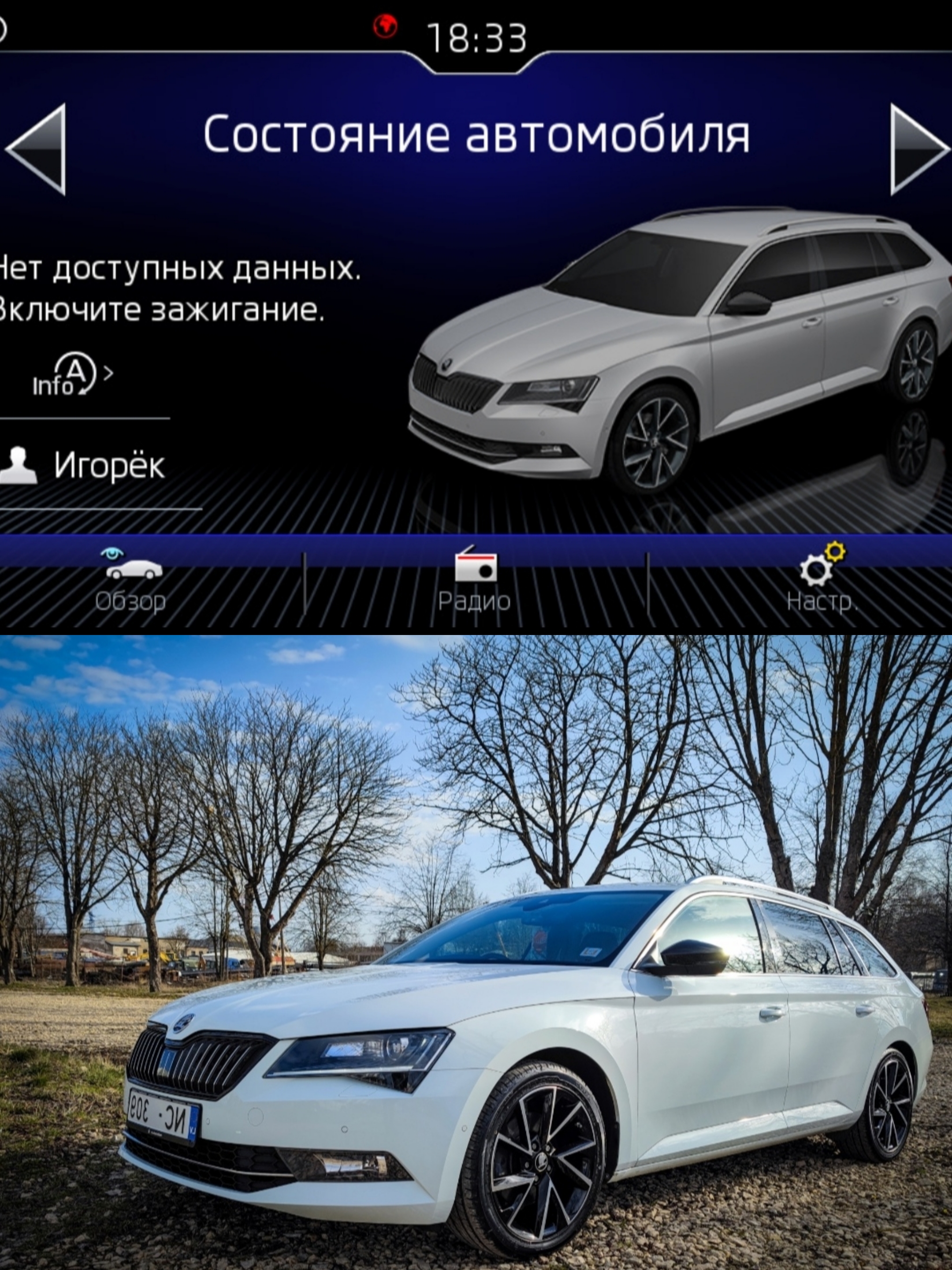

The main thing in MIB was navigation.  Then the toolbox is installed.  The patch is stitched and the swap is transferred.  Everything is working.
Here I changed the image in the "Car" menu
@igrozan
2017. isn't FL, about which is current tread
p.s.
i haven't seen yet Mib-Toolbox for Mib3
Which toolbox and patch are you talking about? Do you mean you´ve uploaded a new software/firmware?
