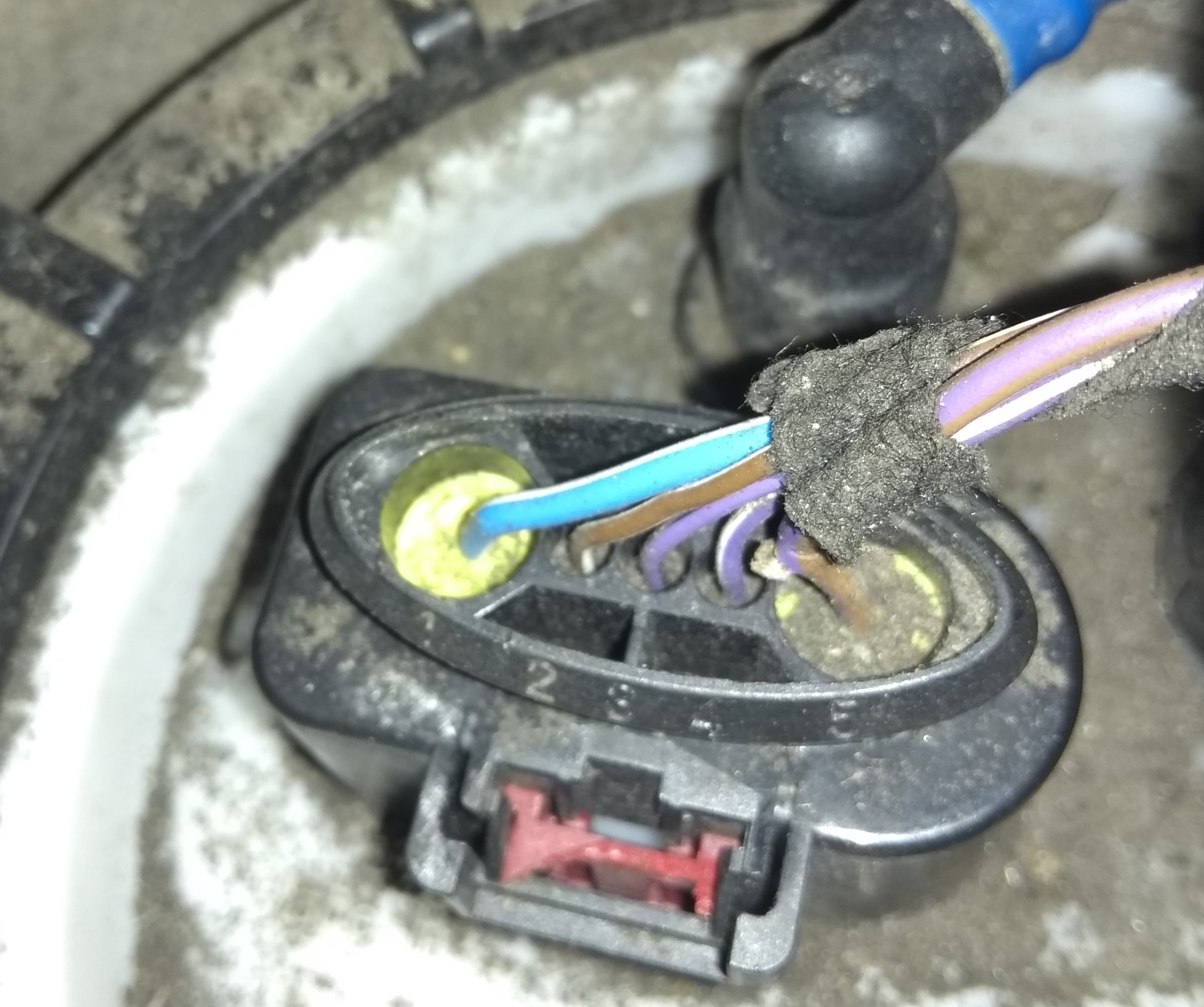

fabia 1.2 htp fuelling issues/ fuel pump relay location / type ?
quick update on this, been a long day stuck upside under a dashboard. (relay plate is horribly inaccessible). vehicle now runs though. fuel pump relay checked out ok when removed and tested (relays usually pretty reliable and this is just the most basic four terminal (SPST) jobby). fuel pump and car ran ok when pump hard wired to battery via a manual switch. concluded that there must be a break somewhere in the wire from the relay output to the pump, spliced in a new section of wire to bypass the split and all good. switched output from FP relay (position 7 in dash) is a thick blue wire, now connected by new wire section to the Fuel pump feed which is thinner blue/ white stripe cable - would like to confirm by checking wiring diag that this is ok (well it works).

ok thanks will check all those fuses, this website seems to broadly agree with the numbers youre coming up with, though the relay info doesnt match. relay numbers are embossed into the plastic ? https://fuseandrelay.com/skoda/fabia-2.html Yes was planning to make up a link to short the relay contacts, and no, Ive not yet heard the pump run. and we're not getting volts to it (as above, assume they're the thick wires of the 5 that go into the pump, colours brown (pin 5 earth ?) and blue/white (pin 1) see photo. thanks chap.
