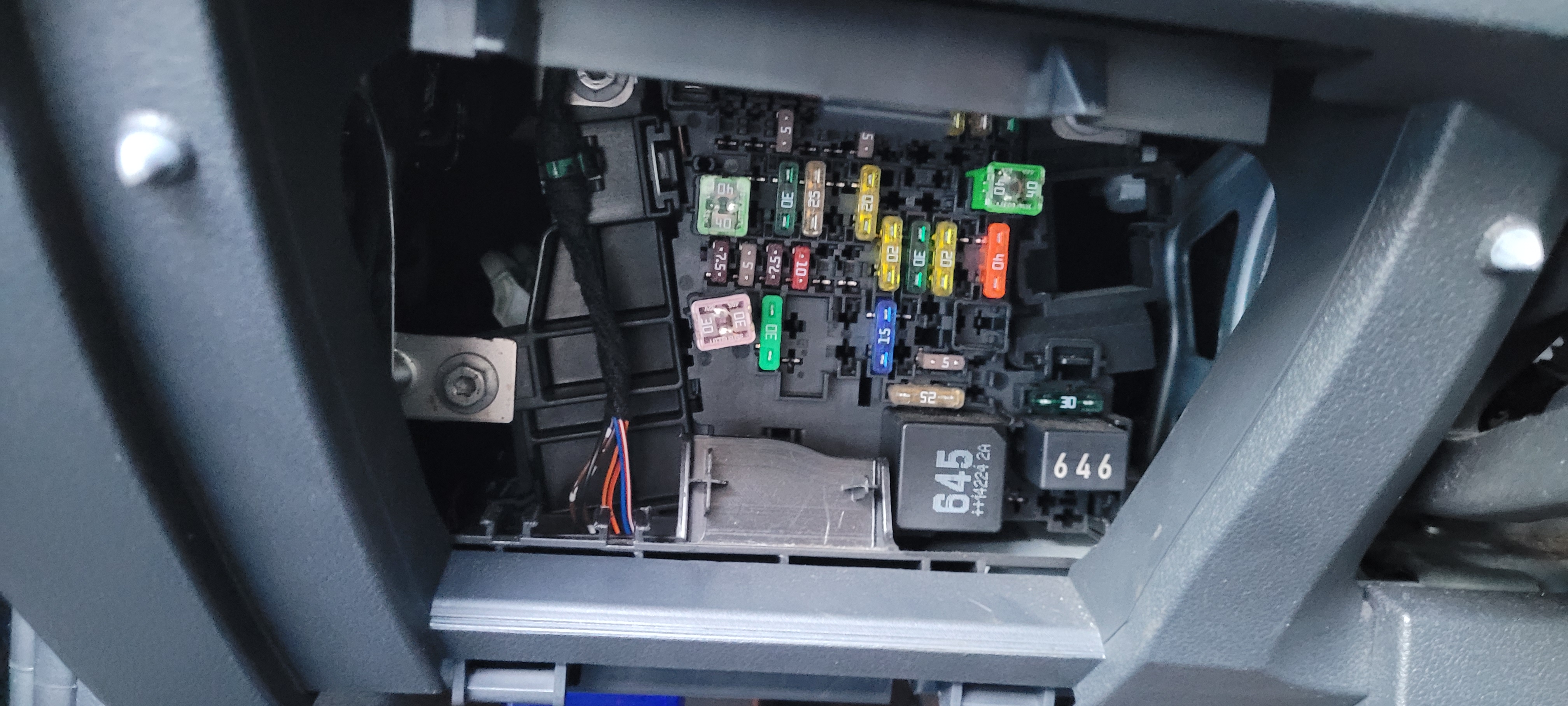

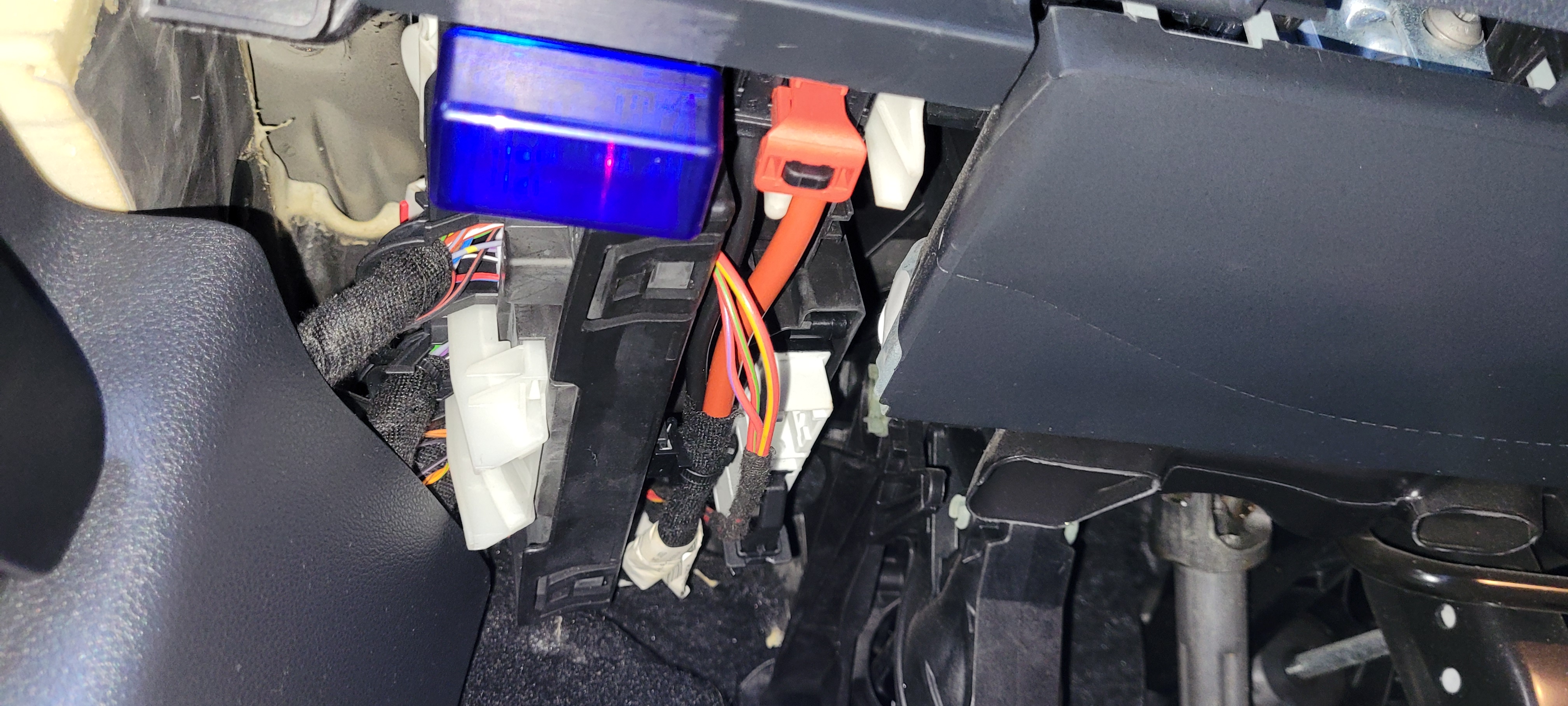

  2. I have measured the voltage of all the 7 connected pins. They all have power to them (except the two grounds, of course). I have tried two different bluetooth OBD readers that both work in a different mk3 Octavia... I have checked the fuses. I have tried many many times, with different apps, different protocol settings etc.. I tried disconnecting+reconnecting the battery Nothing's worked so far. Does anyone have any advice? i have no more ideas other than go to a mechanic and see if they can read any error codes. Thanks

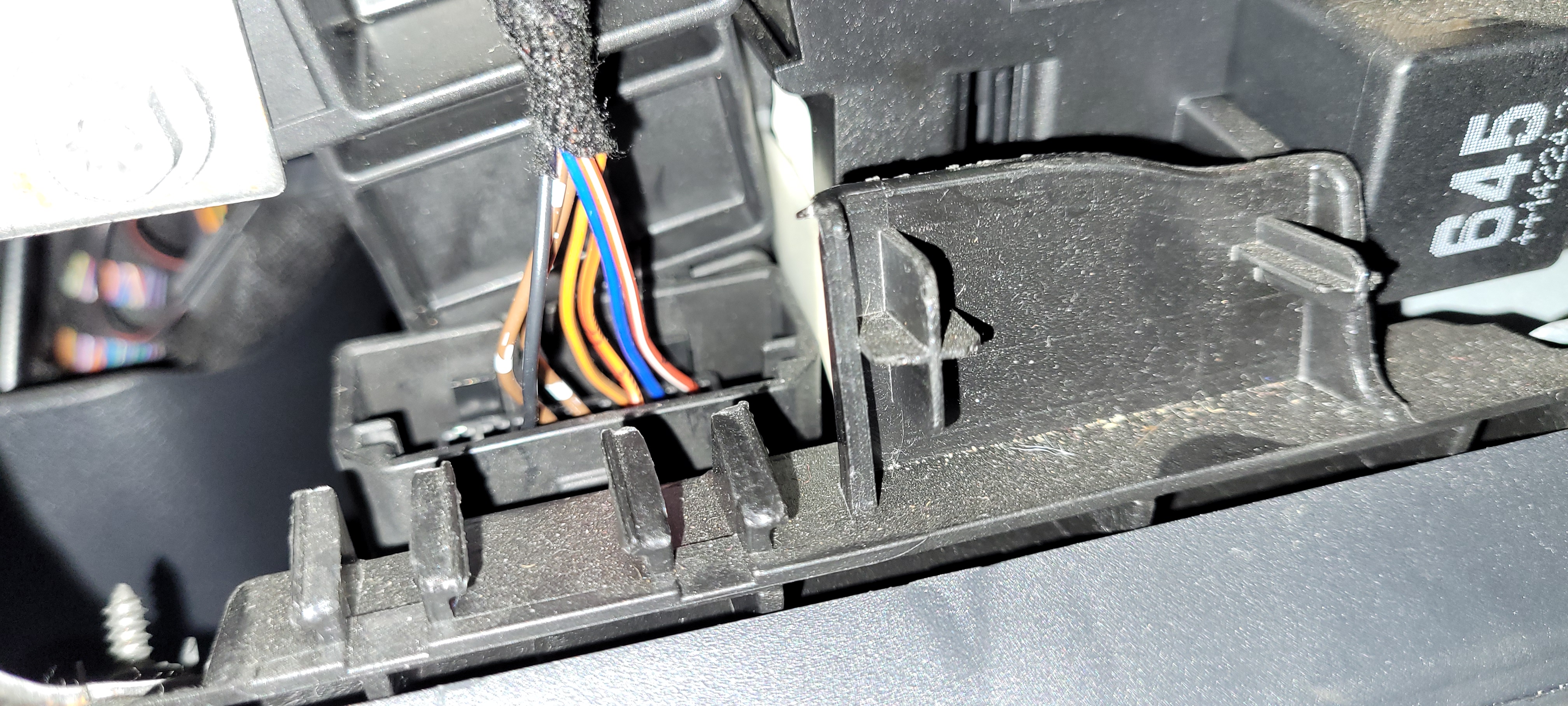

  3. It is a tight fit. But pushes in quite far and does draw power. May not connect all pins though, I'd like to pull out the socket to look closer. I don't know what readers have been used on it by various mechanics. I know it worked when I bought the car using a professional cabled reader, but that was like 4 years ago. Thanks so far, fellas
  4. Hello skoda experts. Sorry if this has been asked before. I have a mk3 Octavia and I am trying to read the error codes for a EPC error. My OBD port doesn't work. I know the (although cheap) reader is OK because it worked in another mk3 octavia. I know the phone is OK because it worked in another mk3 octavia with that same reader. I know the fuses are ok. I have tried many many times in different combinations and sequences. The reader gets power and connects with the phone but can't connect properly to the car. It reads a voltage of 12 if key is turned to power and about 14-15V if engine is running. I tried pushing the wires around a bit to see if it was a loose connection but it doesn't seem to help. Maybe I need to take out the socket to really investigate, how is that done? I have also read that I can try resetting it by taking the negative terminal off the battery for a few minutes, but will that have other consequences for the car? Thanks a lot for any advice you can provide!
