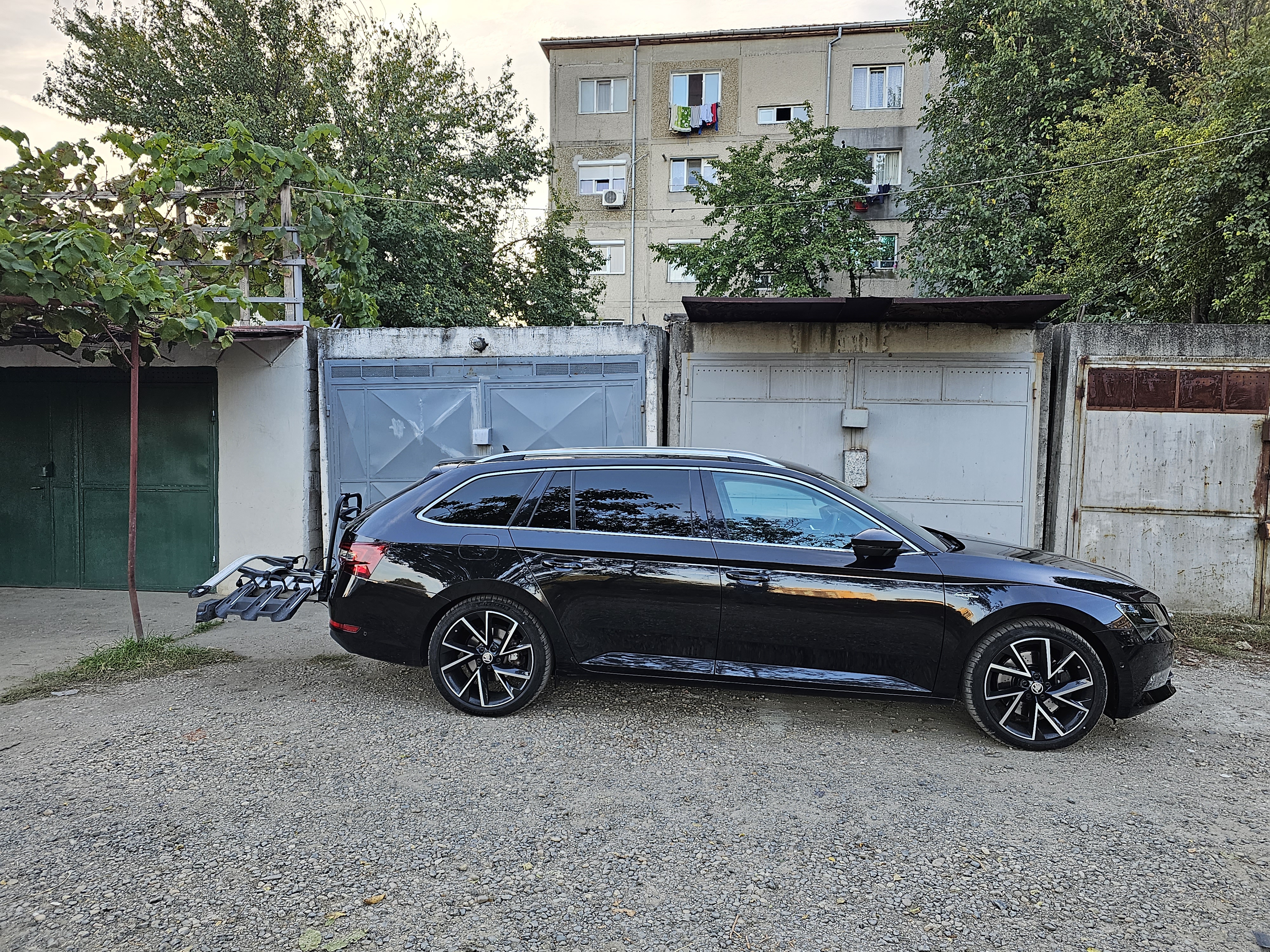

Thats my superb 2019 model pre facelift...4x4 190 hp, dsg 7 speed dq381 Laurin and klement combi model, almoust all options, without panoramic . Changes made it : sport line 280 hp front brakes rotors brembo performamce 345mm, all bulbs led.
