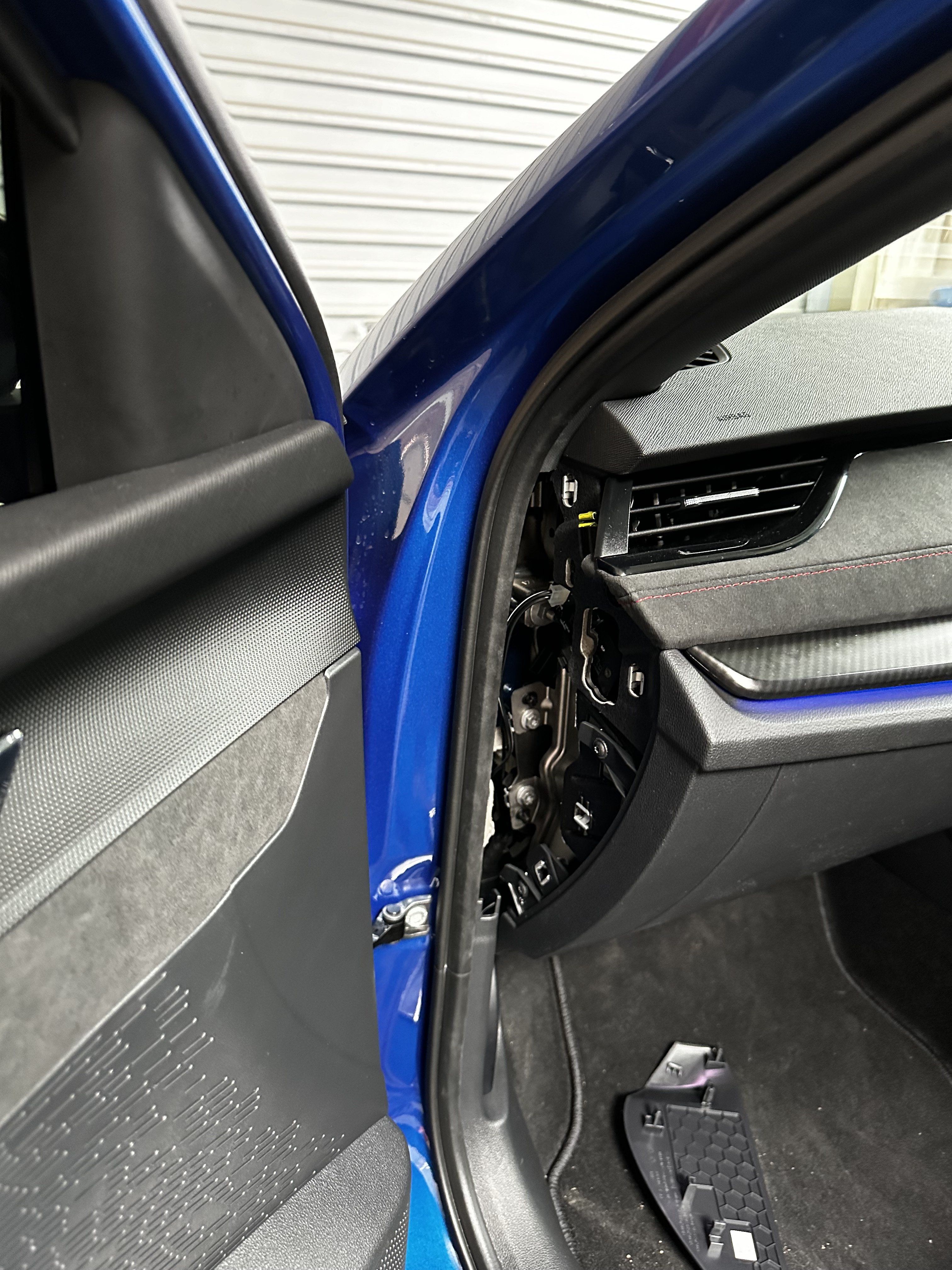

  4. I have been looking at that thread as well but it seems like they have the Canton system so the Q5 sub can be dropped in but from what I can tell the 8 speaker system doesn’t come with any wiring or amp from the factory so it won’t work. I’ve installed the Match PP 8E-Q just because I found it cheap. The issue is this sub is rated for 3 ohms and the Match 5.4 provides either 90 watts at 4 ohm or 160 watts at 2 ohm but it still does support my sub. It doesn’t give me a rating for 3 but let’s say it’s in the middle of the two so around 125watts. I believe for better compatibility and slightly more power I should have bought the PP 7S-D which is rated at 2 ohms. Regarding the placement when the glovebox is off you will see space that can be accessed by removed the trim as show in the photos below. I wrapped the amp in some double sided stick tape so it doesn’t rub against the cars metal frame then zip tied it in to avoid it moving. If you even need to change the amp setting you can easily remove the side trim and plug in the usb cable.
