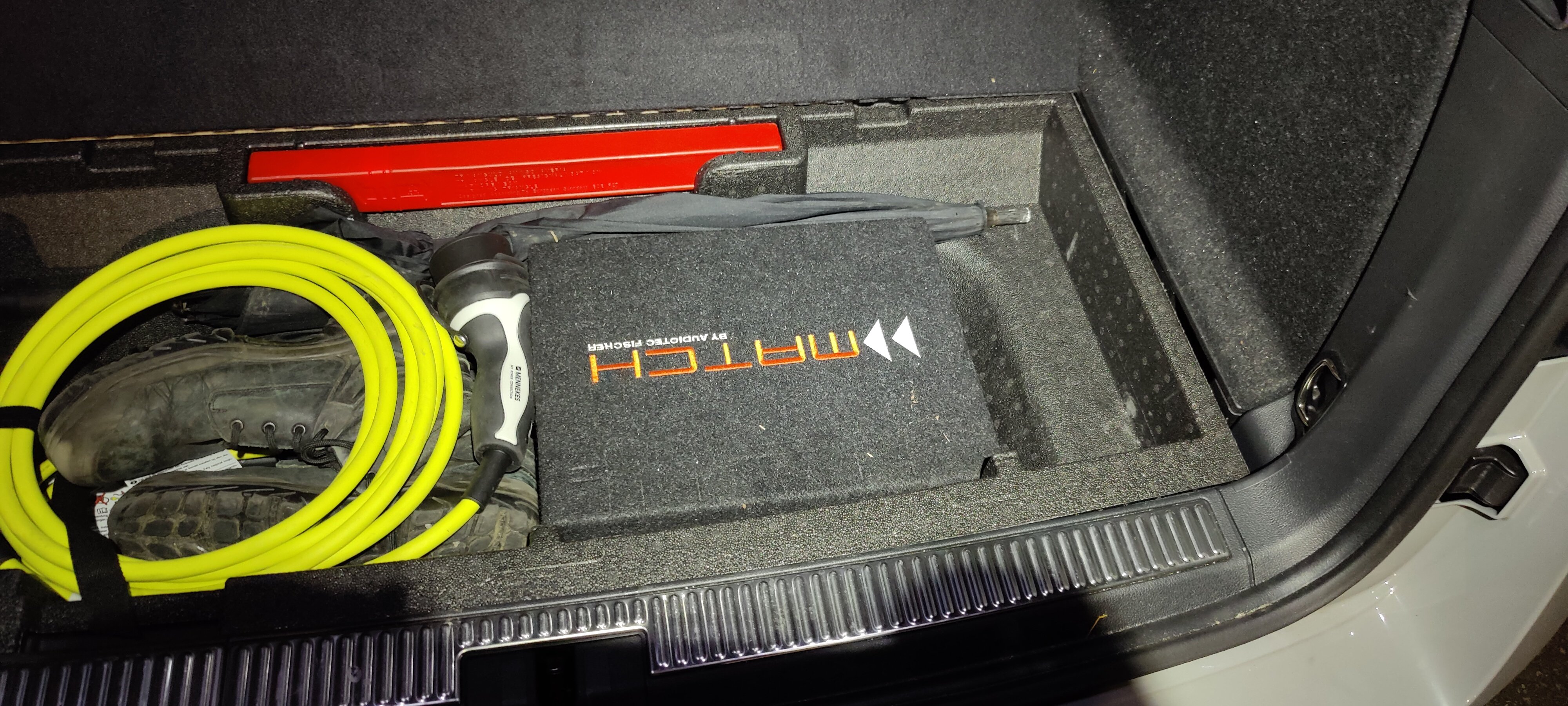

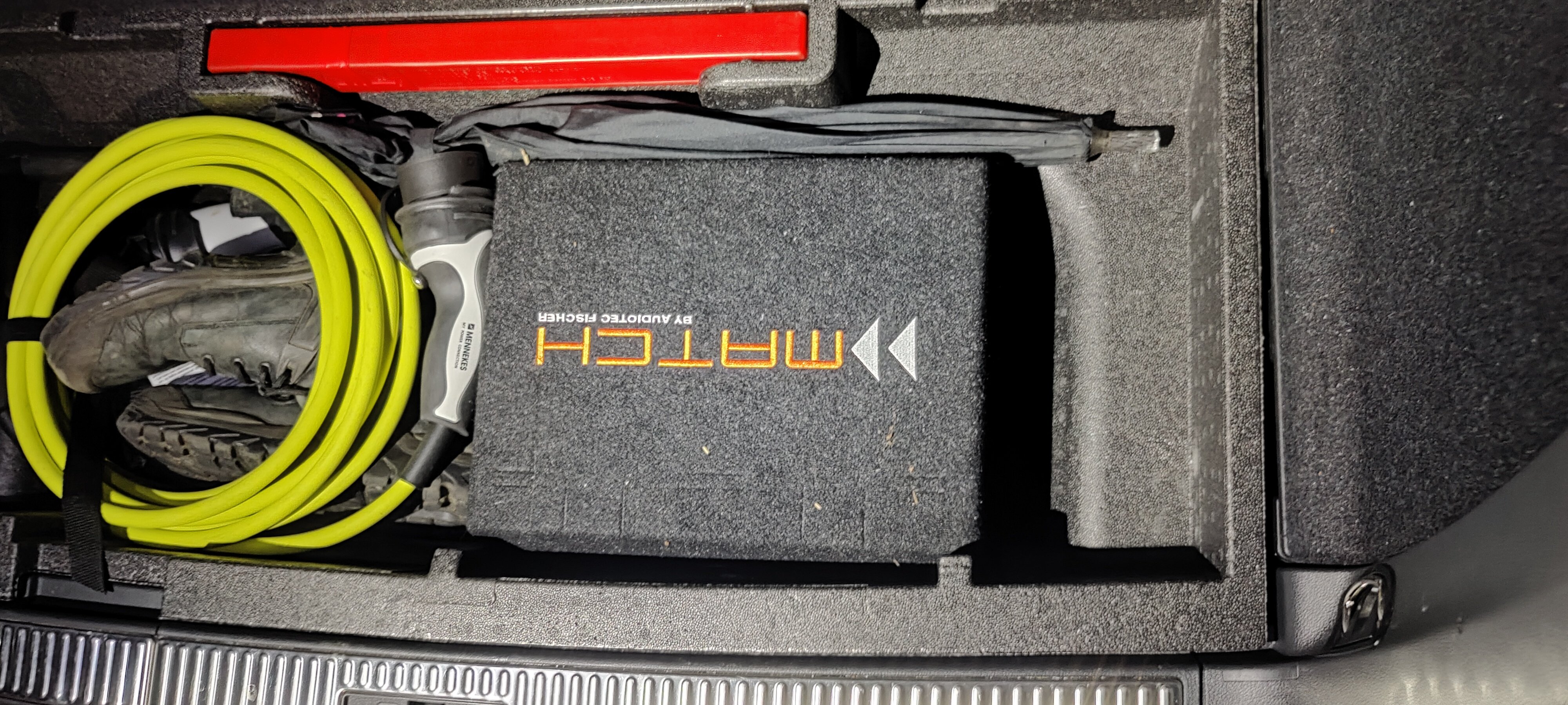

I’ve installed the Match PP 8E-Q just because I found it cheap. The issue is this sub is rated for 3 ohms and the Match 5.4 provides either 90 watts at 4 ohm or 160 watts at 2 ohm but it still does support my sub. It doesn’t give me a rating for 3 but let’s say it’s in the middle of the two so around 125watts. I believe for better compatibility and slightly more power I should have bought the PP 7S-D which is rated at 2 ohms.

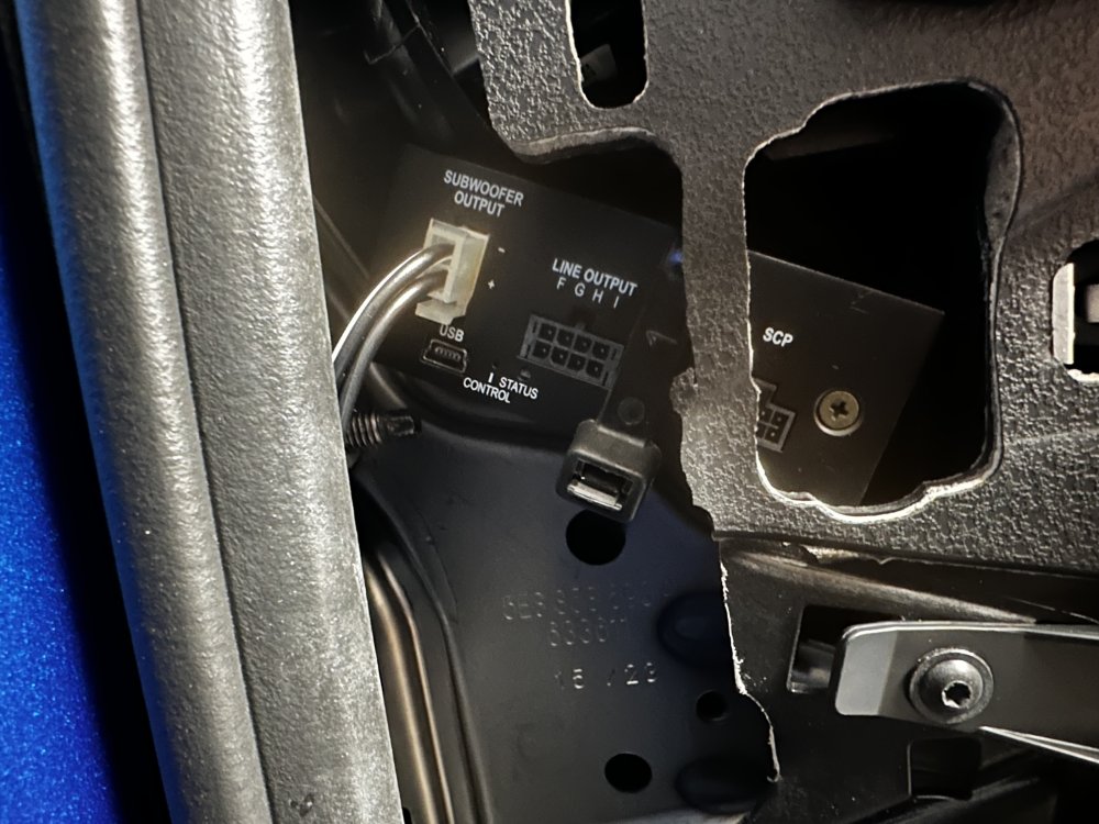

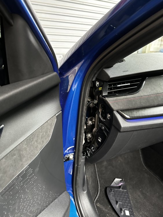

Regarding the placement when the glovebox is off you will see space that can be accessed by removed the trim as show in the photos below. I wrapped the amp in some double sided stick tape so it doesn’t rub against the cars metal frame then zip tied it in to avoid it moving. If you even need to change the amp setting you can easily remove the side trim and plug in the usb cable.

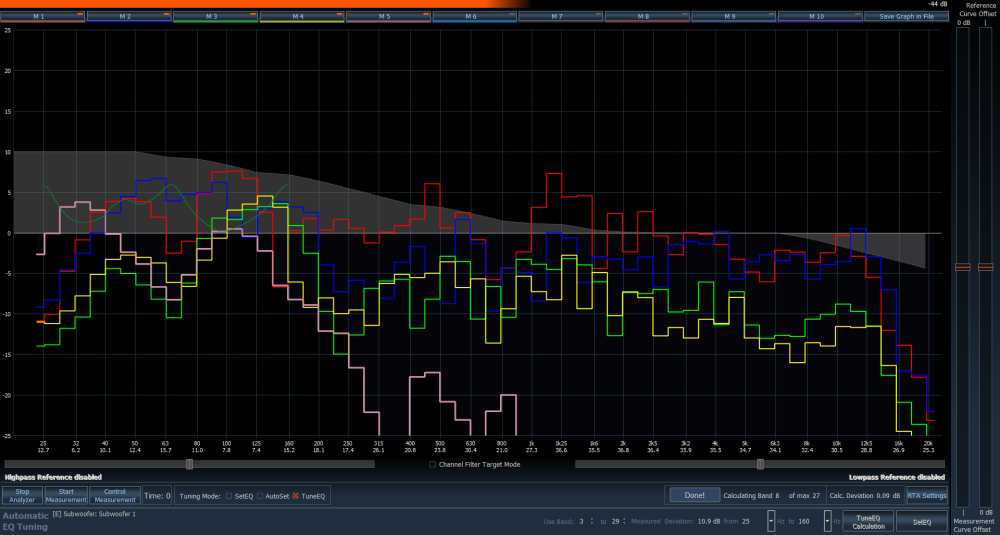

Only got a few minutes, but my experience so far:
The sub makes the difference, giving the door speakers room to breathe for low-mid range.
Things i did:
- Used my Audyssey microphone that comes with many cinema receivers and laptop (disabling al input processing) to tune the EQ with TuneEQ   -> and for Timing
- Got a lot of improvement when i dit the input equalizer, MIB unit messes with the EQ itself a lot.
- Mayor improvement setting the MIB unit to front speakers and routing the Front Inputs to the rear speakers,  the MIB unit does something strange with the rear speakers signal which cannot be compensated for. (Found this on a skoda forum, tried it and was really happy with it :)
- Use the WAV files that come with the software to tune the right things.
Right Order:
-> Timing
-> Input EQ  (Disable outputs in software for a quite time :) )
-> Route front signal to rears (Virtual chanel processing)
-> Output TuneEQ
Was quite happy but still the tweeter was killing me. Could not damp it enough in the match to my liking.
So i had some spare crossovers which have -3db setting on the tweeter, installed this and redid TuneEQ and was much more satisfied.
Have now bought som Gladen CL-ONE crossovers because the ones i had are to big to fit, still have to mount these and test.
-> Bought an Remote to controle SUB and switch between 2 profiles

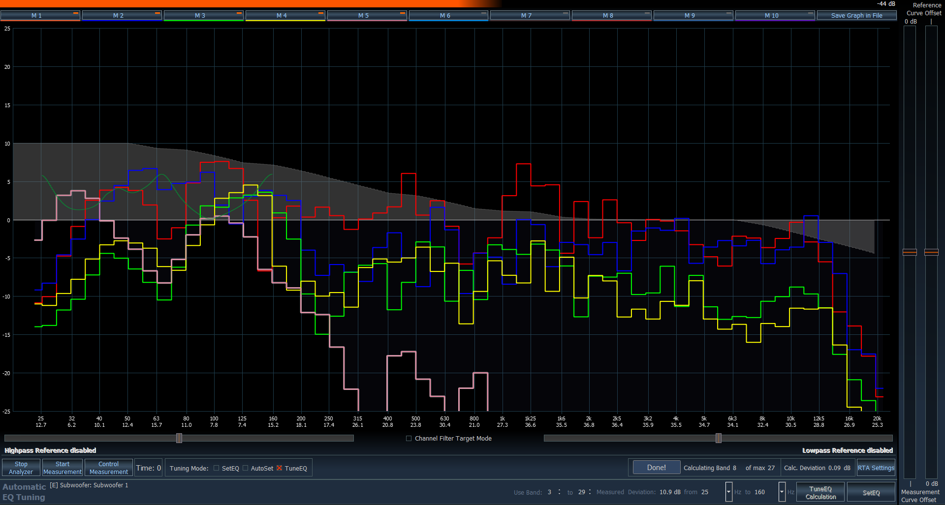

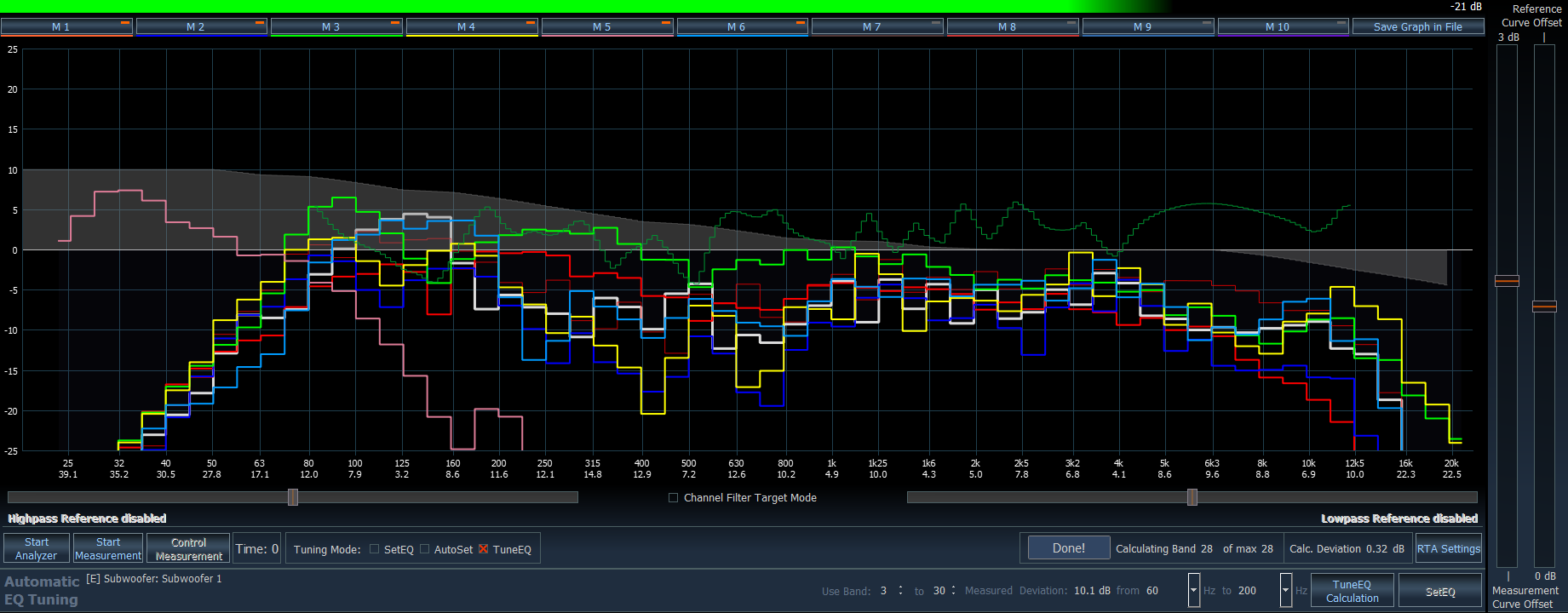

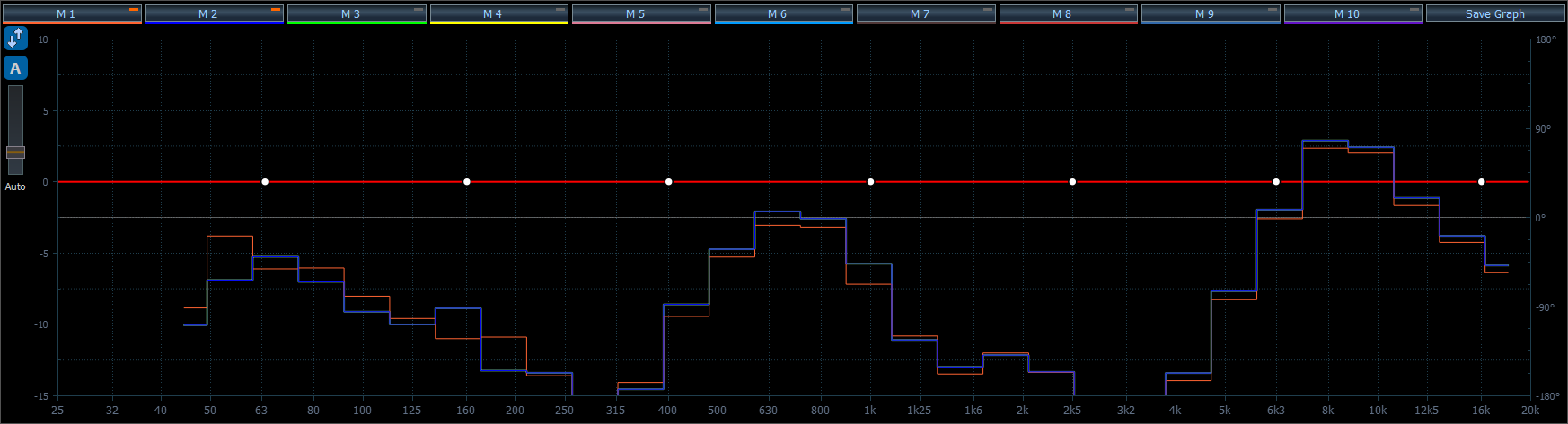

INputs signal readback before filtering (can be done without microphone)
All range -> without -3db crossover
left filtered -> test crossover on left tweeter.
