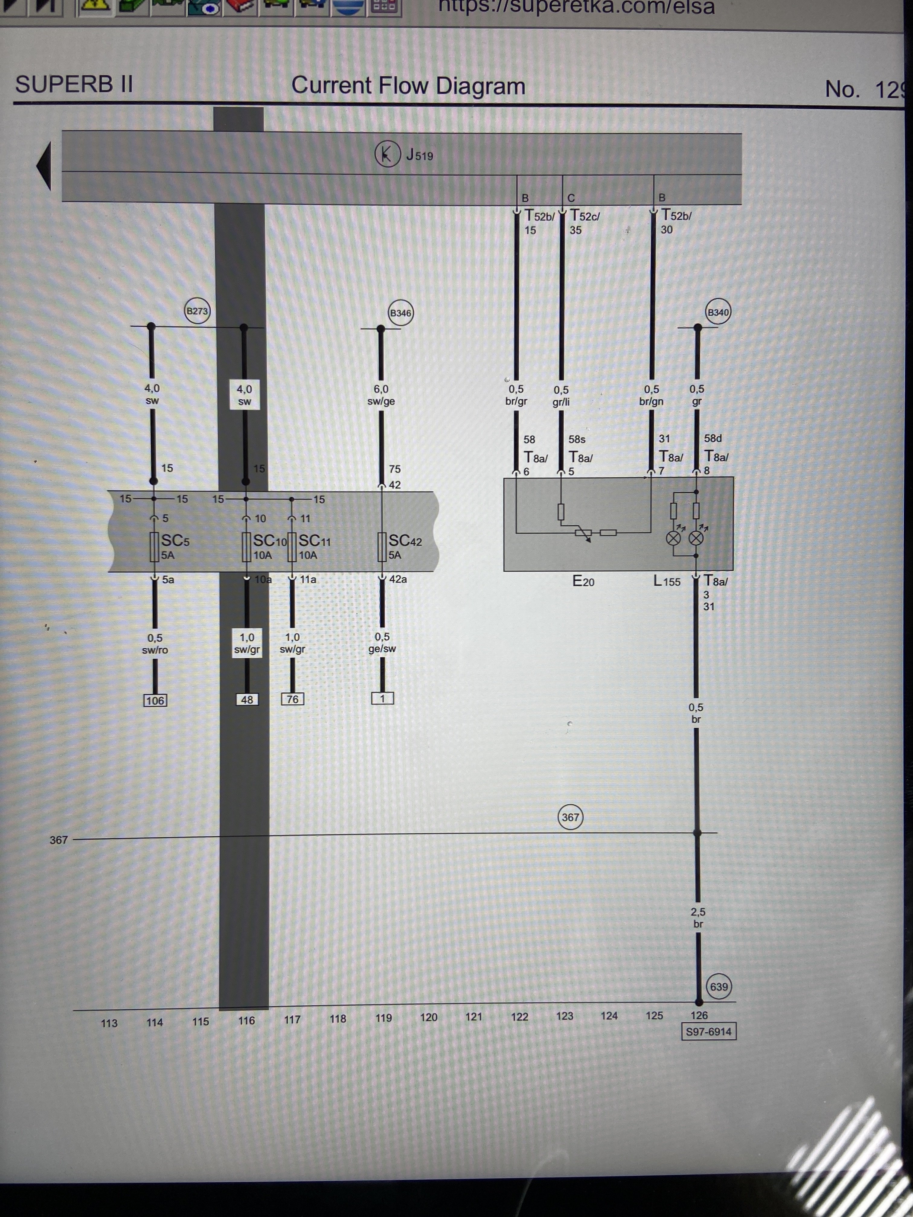

Btw if anyone needs a wiring diagram or parts for vw Skoda https://superetka.com/?cat=etka it’s free and has Elsa and etka hope I’m not breaking any rule … I don’t own the site

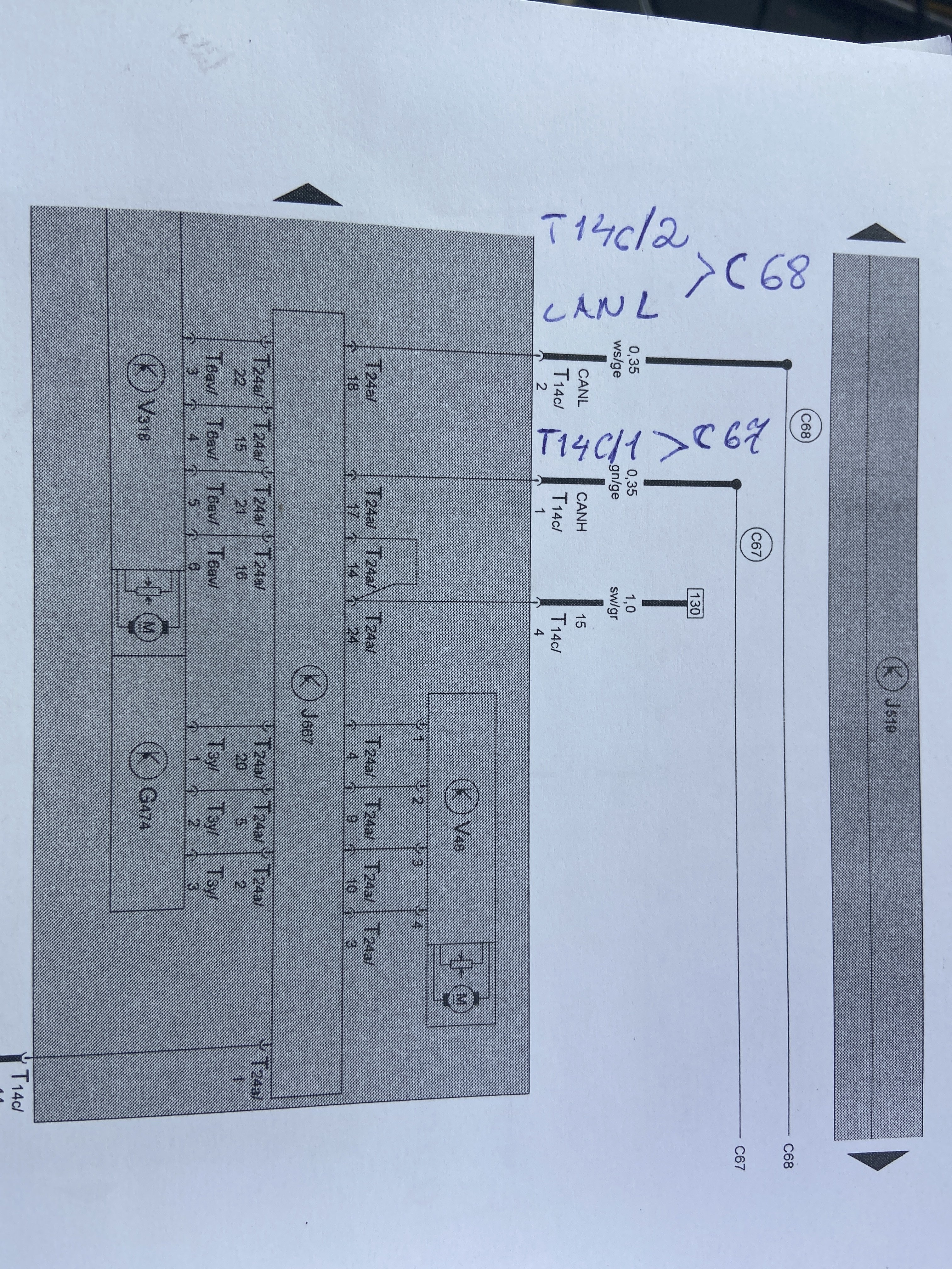

Hi Andrehj, yes you are right I was in a hurry and made a couple of mistakes. I have the afs module ( ads that was autocorrect at his best ) , have the front and back level sensors and xenon modules are attached underneath each headlight. What I need is the wiring schematic ( diagram for the headlight) as at the moment I’m using the car but don’t even have the left right signal working.

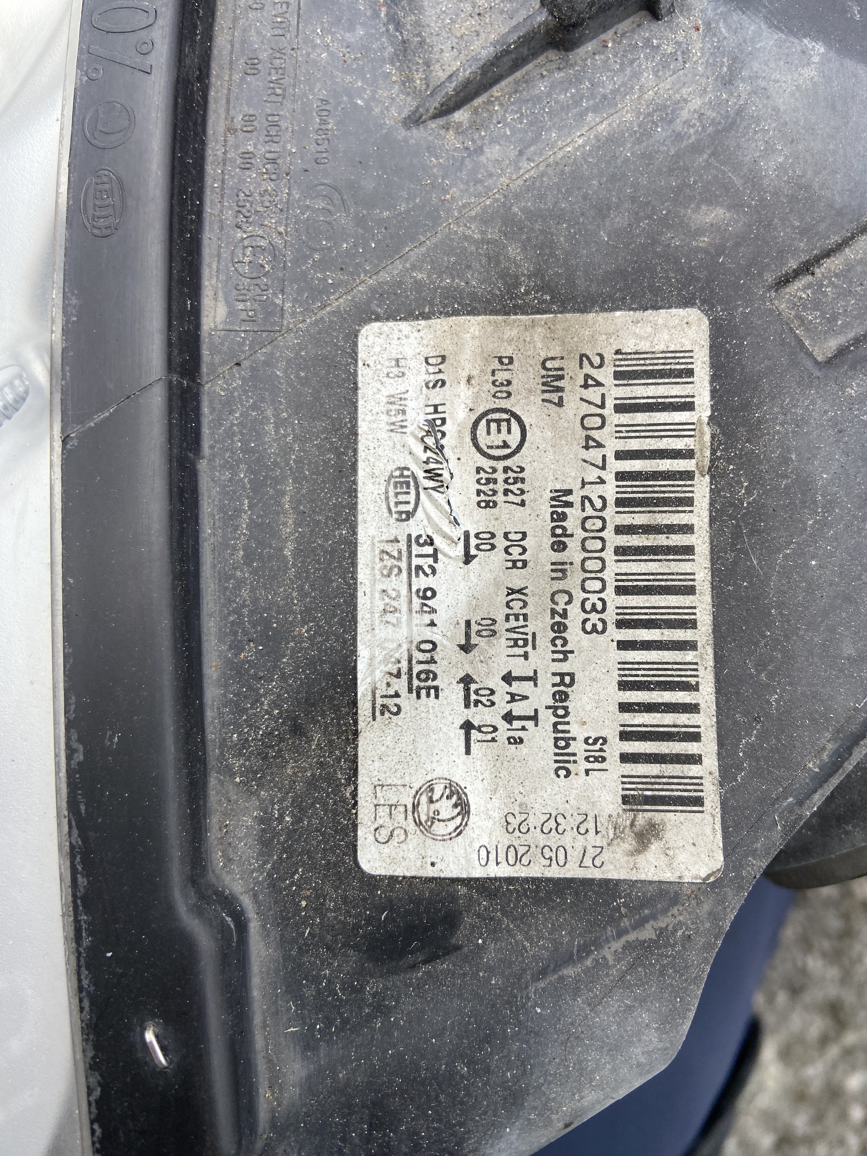

Hi everyone, I just removed the old headlight that had a 10 pin socket and installed the new ones with 14??? is there a diagram around that I can use for this retrofit , but afraid not to burn the ads module. Thank you for your time.
