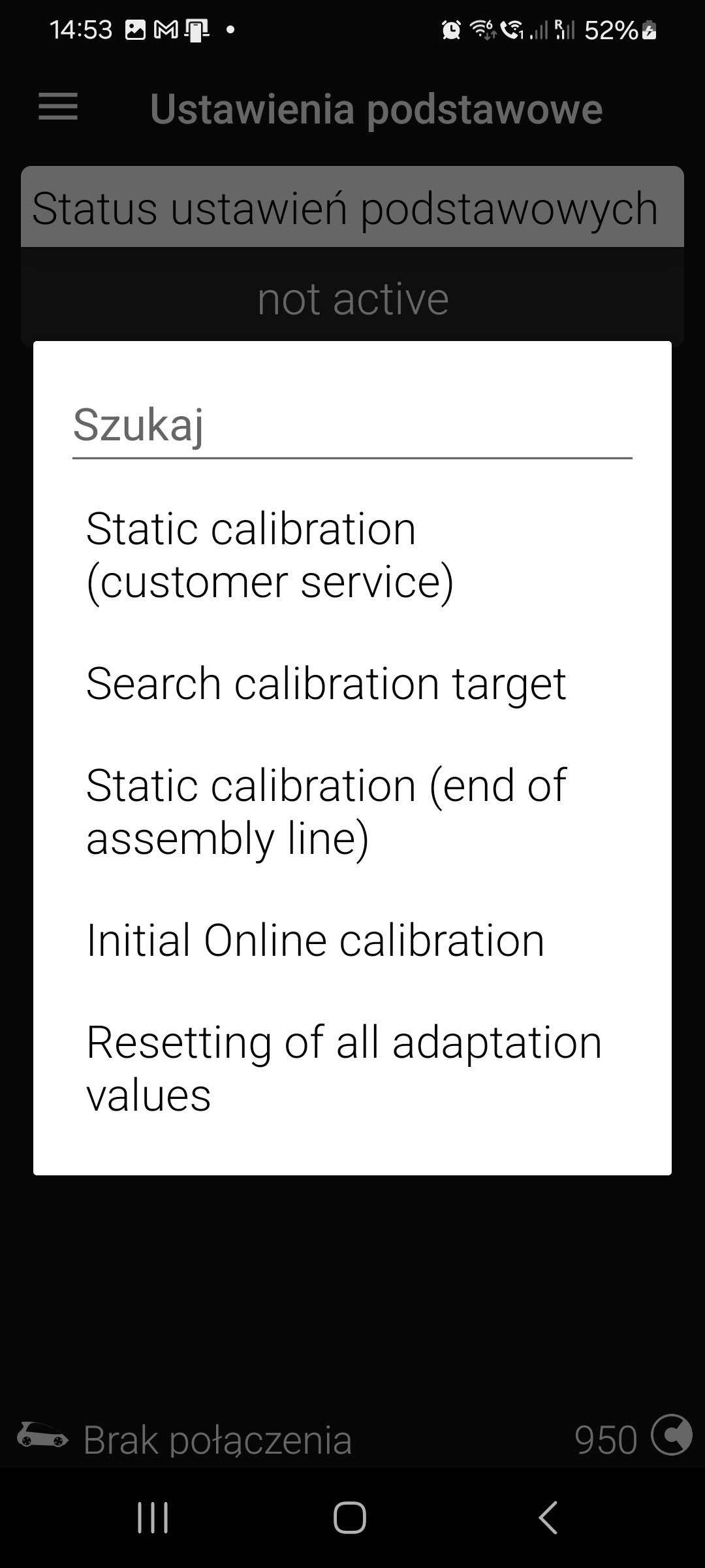

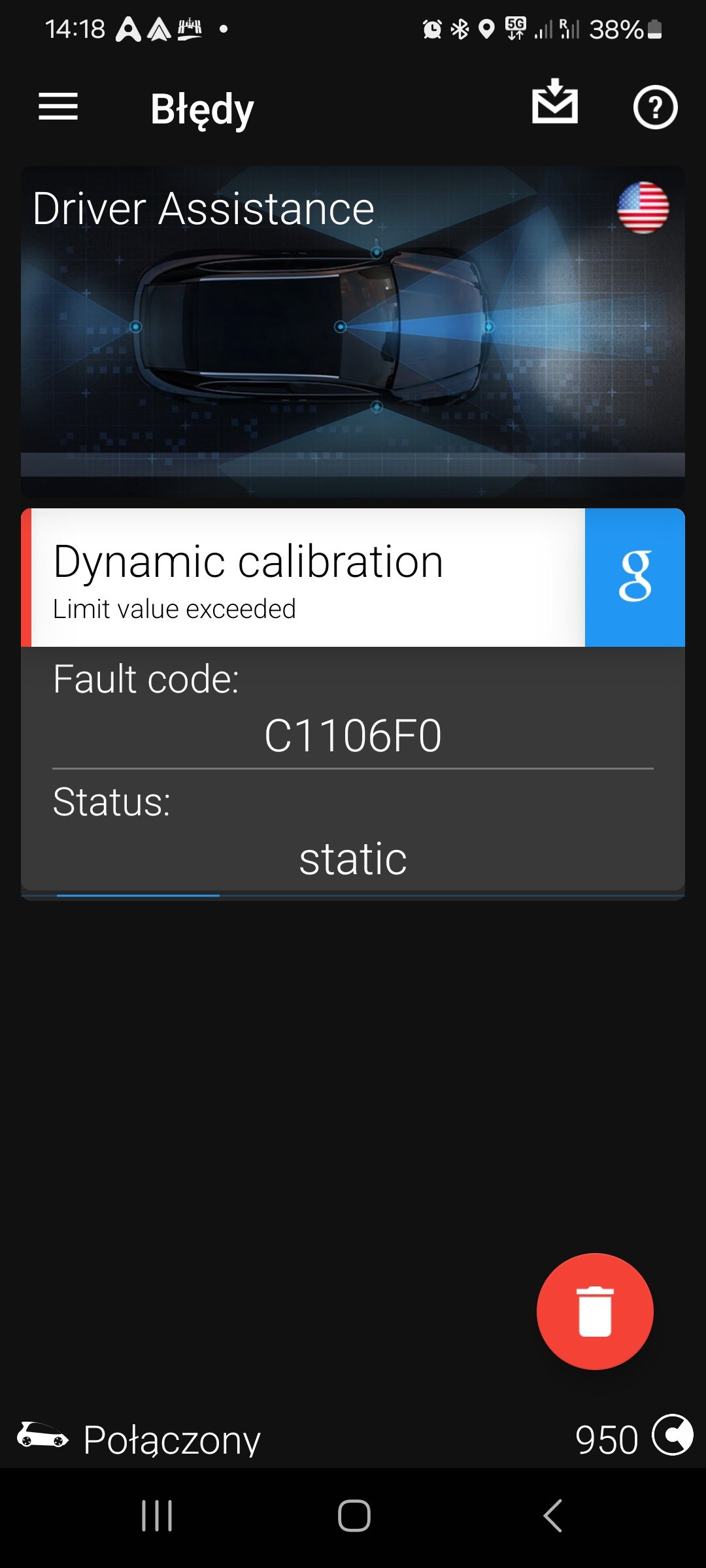

  2. I like THIS car. The only thing that is weak is the electronics on the level of aliex....... Apart from other problems I have error C1106F0. A4 Driver Assistance. Lane assist and traffic signs recognition do not work. Yes. The windshield was replaced but 6 months ago. The only thing I did before was to pump up the tires.... I can do a reset - Resetting of all adaptation valves - after that delete the error that comes back. I understand that calibration is needed - Will I do it myself? How much does the service want for this crap? Thank you .

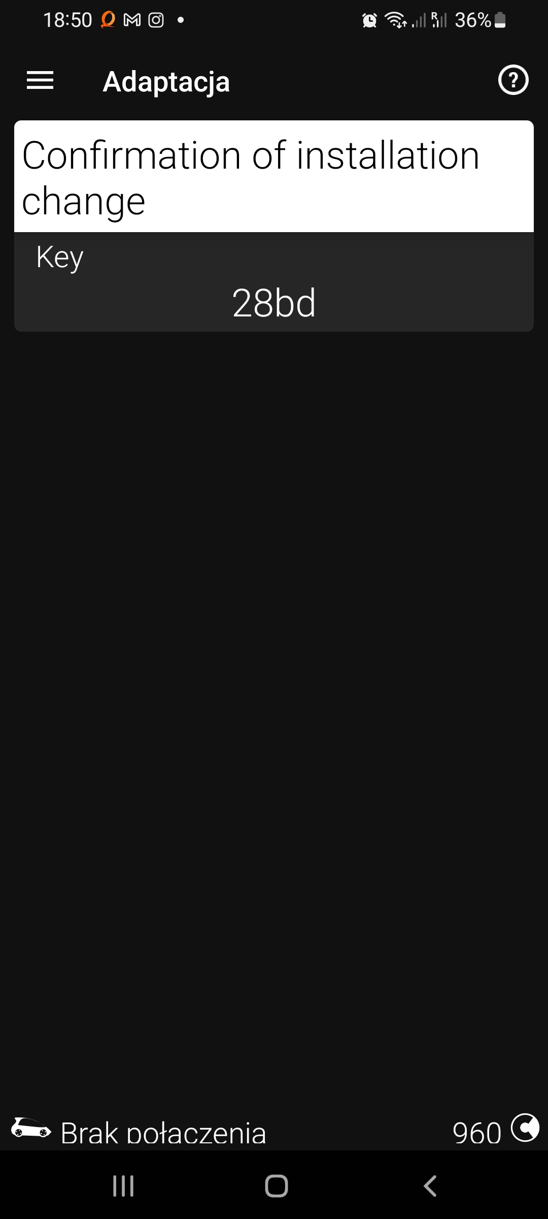

  7. You need to code a new battery if it is a different type. For me it's like this: What type - EFB+ (StrongPRO EFB+) Capacity 70Ah

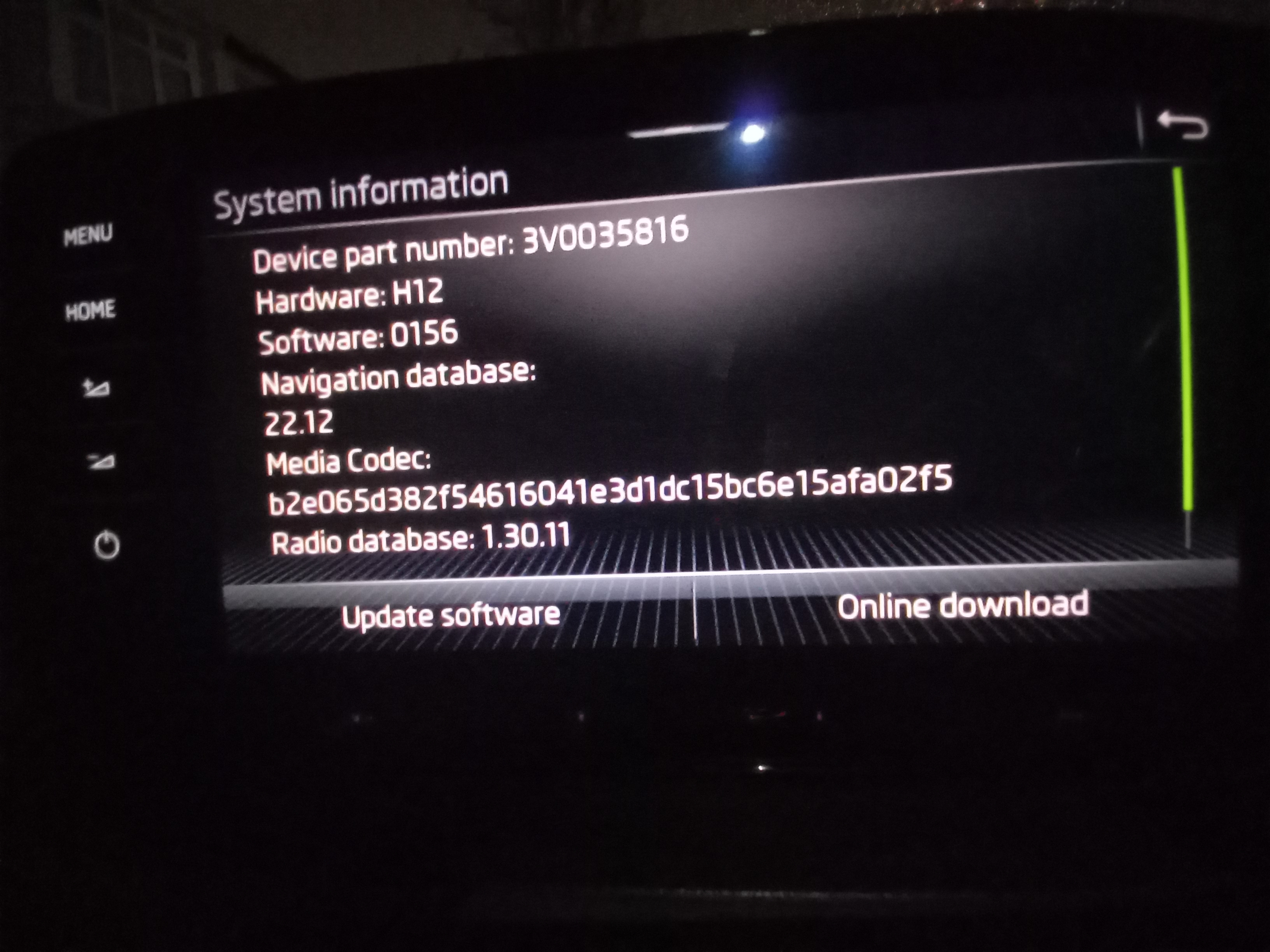

  10. Thanks . The error is gone. I read on this forum that map updates are only available online. Of course not for free. The unit is behind the display. There is no SD slot - Maybe inside?? I don't care about that. I use Android auto - AmiGo - good for me. Speed camera warning and Average speed.... Very good for me. Android auto is now wireless. I bought a cheap adapter on Alliexpress. It worked perfectly with a budget smartphone.... Thank you very much for help . I will keep fighting. https://aliexpi.com/Dy6v
  11. TMBAC7NE5J0312146 . I tried maps from USB but without success.

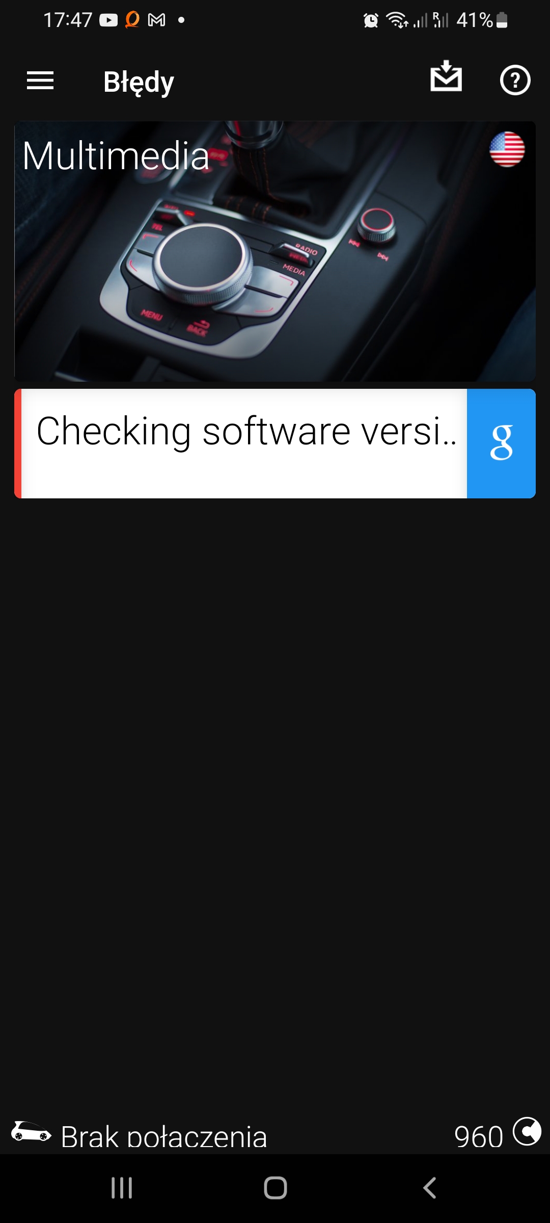

  12. I can't become a first user - Ok I have one key at the moment.. Sometimes it takes a long time to load the user profile. Every few days I get information on the screen that an update is available. I accept, I don't accept. It doesn't change anything. A new map is available on Skoda update for VIN. The update does not start. Smart link via without cable doesn't work - maybe it's not available to me? There is an error in Multimedia - Update needed...

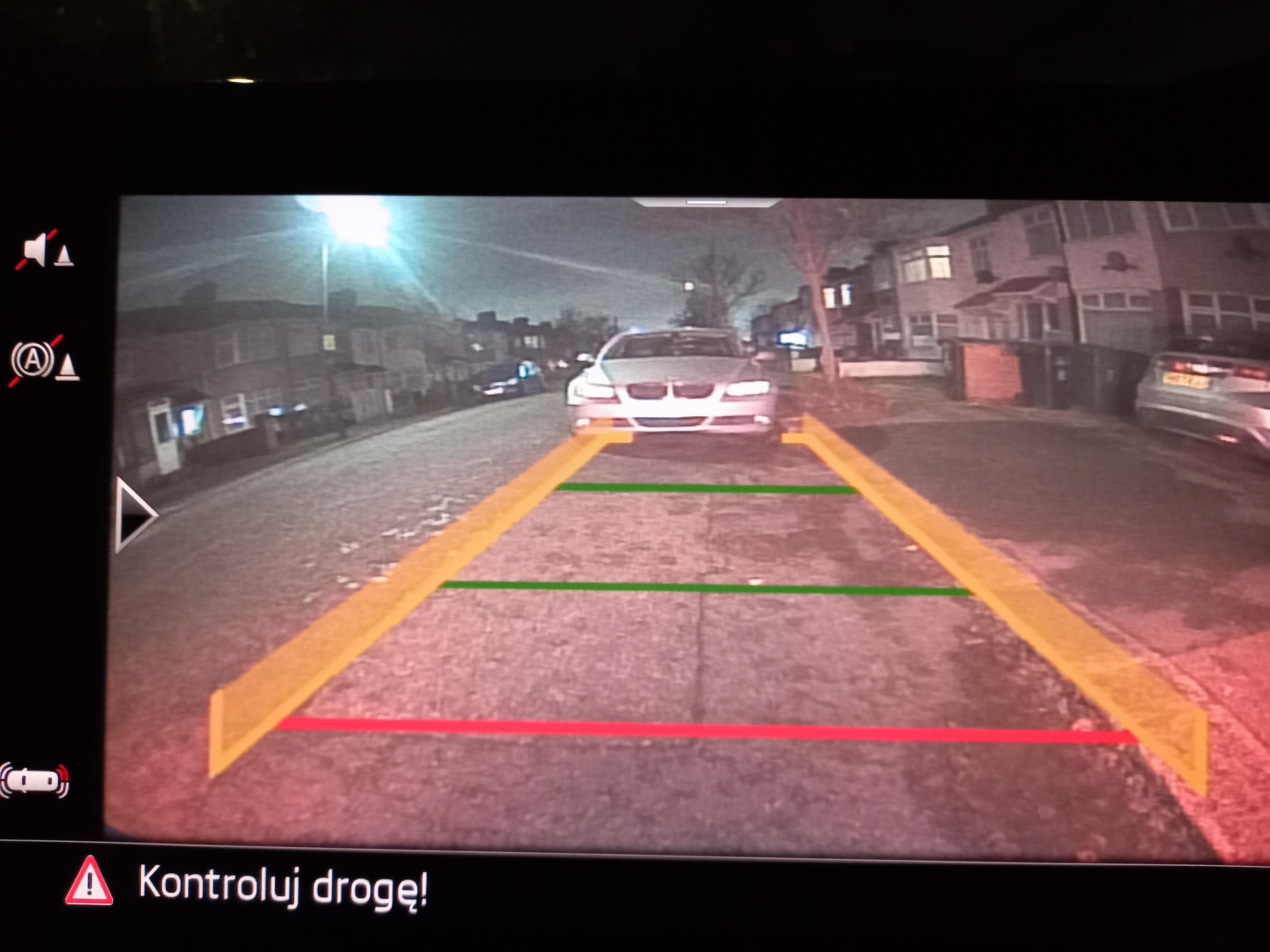

  13. I'm not an expert, but I installed it for Octaiva MK3 and Scala. Both work. Coding was necessary for Octavia. The Scala kit worked without . A link would be helpful. I installed this camera: https://aliexpi.com/9GA3 Scala: first run. Everything connected Ignition on - set reverse gear. Disconnect camera - reconnect The radio/multimedia system restarted. - self The rear camera view works. That's what I did for myself
  14. I bought and installed a reversing camera. with Dynamic Trajectory line. I think it is very well made. Works after connection, no coding required. Good quality during the day and night - Rate the photo. Reversing Dynamic Trajectory Parking Camera Price - quality - very good .
