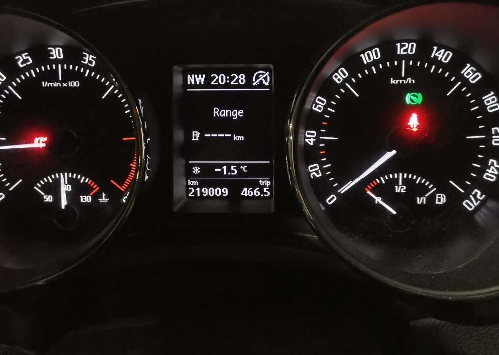

  8. I have little annoying problem with my Superb - sometimes fuel needle drops to zero although I have plenty of fuel. OBDEleven scan shows error: B105A1B - Fuel Level Sensor 2 -Resistance Too High Status: Intermittent MFD shows range as "---". There isn't any more errors on display. It isn't a major issue and most of the times it works but it's still annoying when it happens. Is there an easy fix for this or I should take my car to the mechanic?
