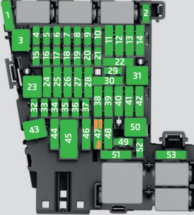

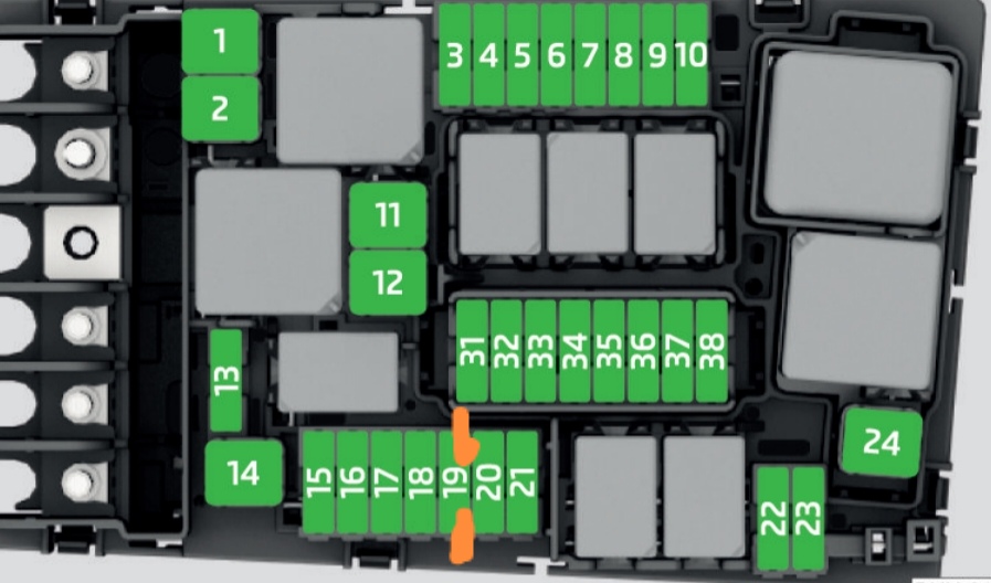

  6. In the manual, I have fuse No 47 for the rear wiper motor. I replaced all the concerned fuses preventively. The front wiper motor (fuse 19) run correctly but the washer does not
  7. I have a problem with my skoda octavia mk3 2019. The windscreen washer don't work alon with rear wiper. - I already checked the fuses they are all OK - the washer pump does not run - measured the voltage at washer pump, I have 0 V with the stalk commanding the washer pump on Any other guidance please
