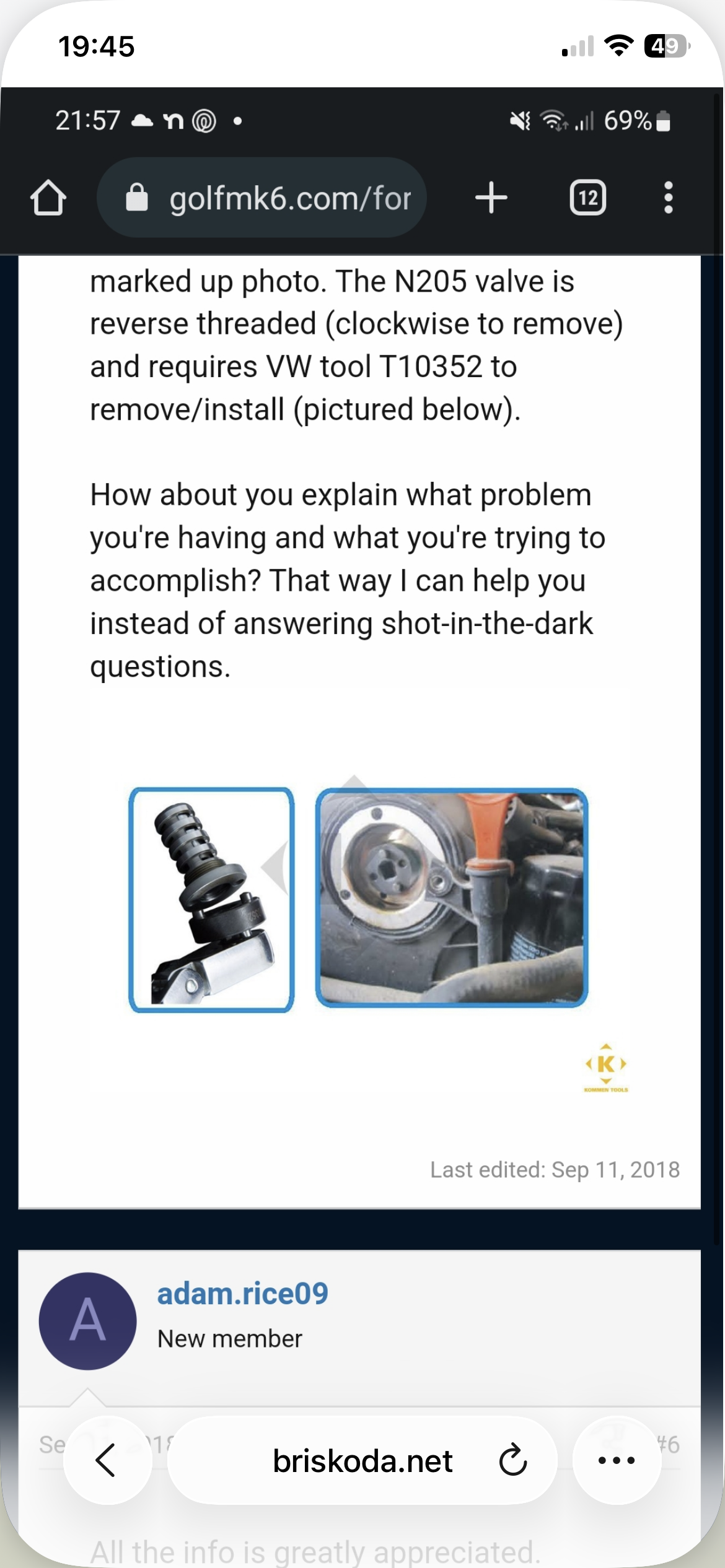

I have the correct removal tool but need to know what the correct procedure is to unscrew the valve . Application of moderate force did not move it even slightly.

I have tried to unscrew the camshaft oil control valve using the correct removal tool but it will not move even using a long torque wrench. I know it is reverse thread. Has anyone done this and is it supposed to be as easy as unscrewing the valve and extracting it? I am at the point of asking my not so local specialist garage to do this job for me.

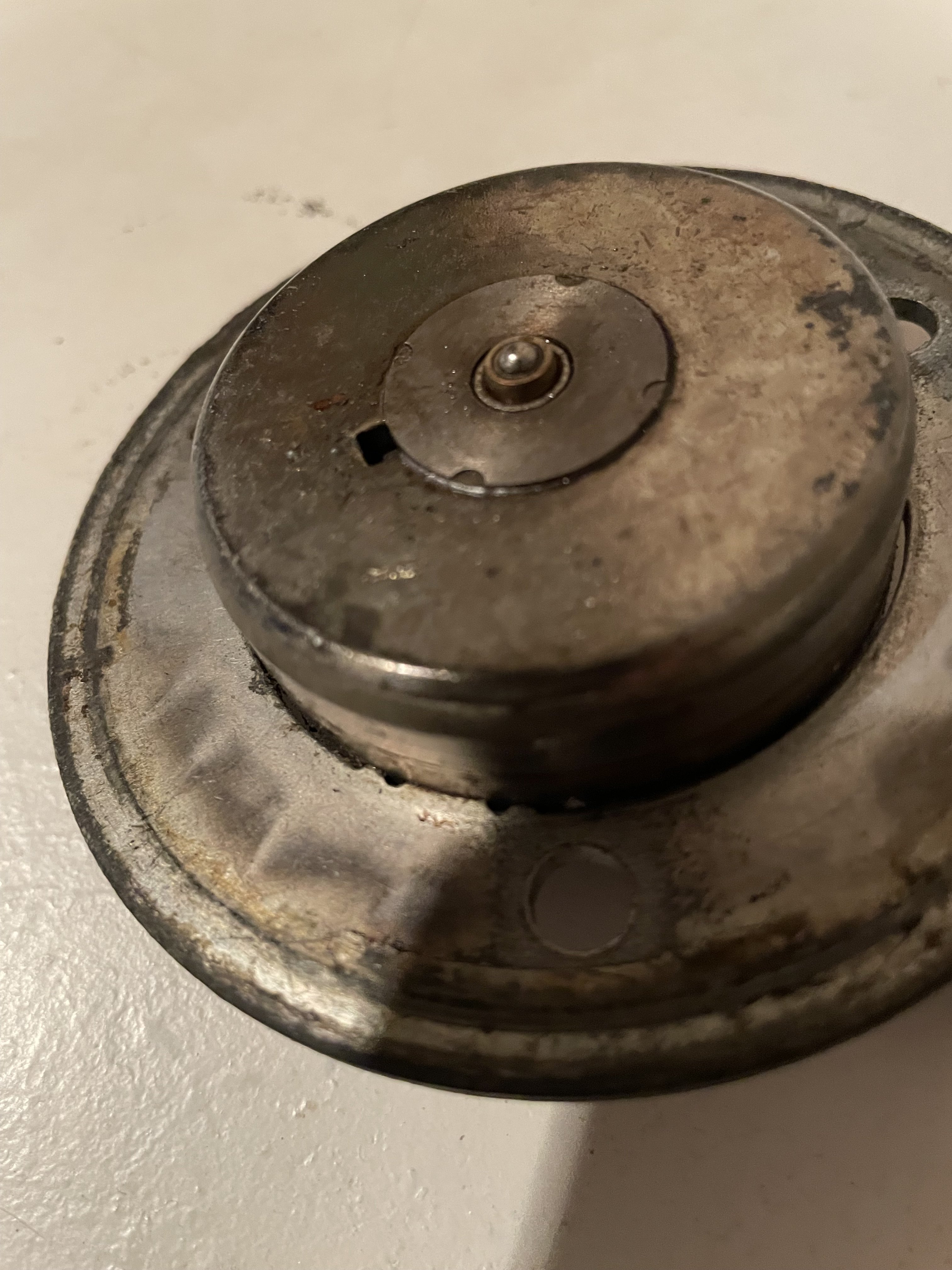

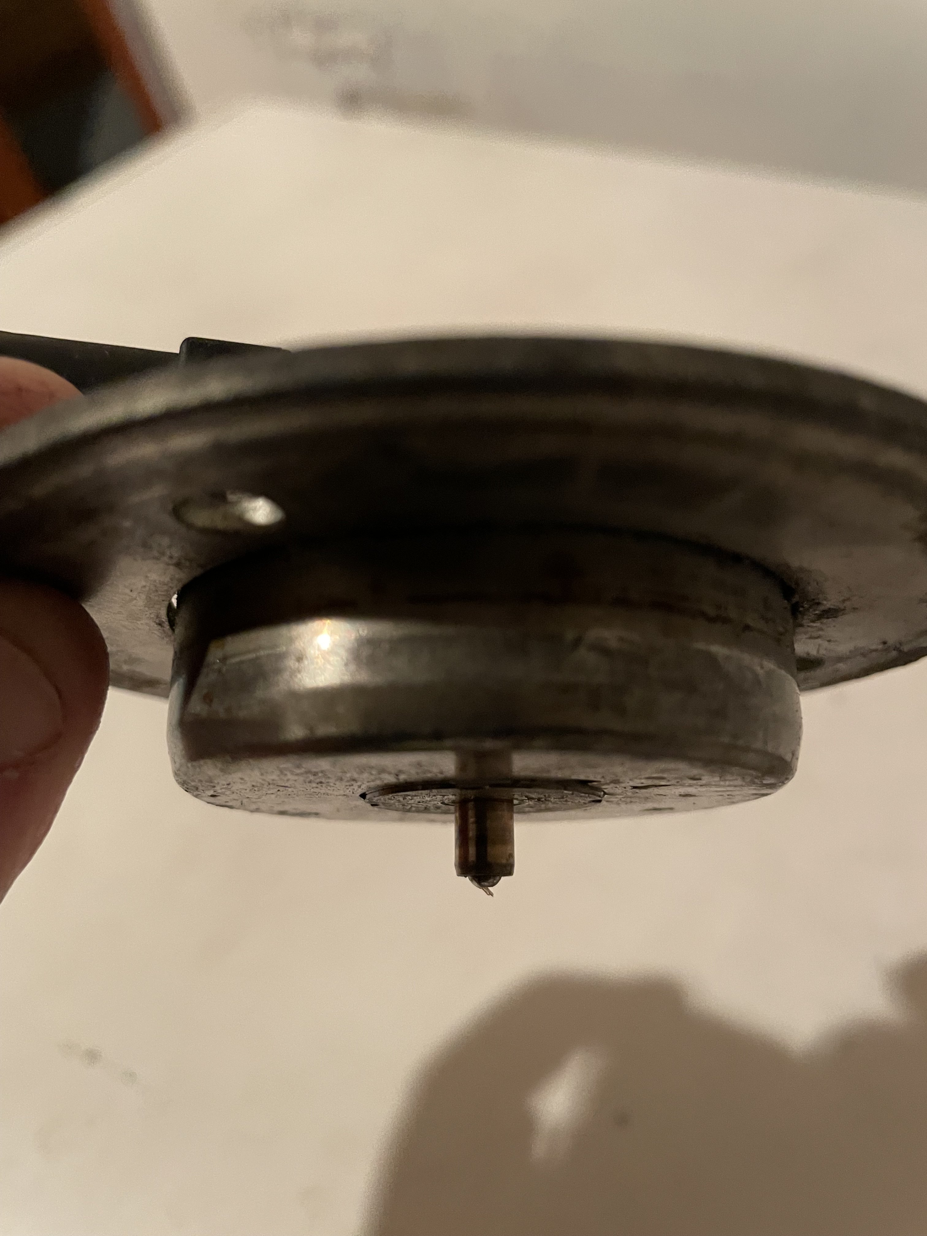

I am now aware that this pin is supposed to move in and out freely per my photos. My next move is to replace the camshaft oil control valve as I believe that is part of the fix.
Suburb 2.0 TSI camshaft adjuster magnet
This is a very obscure question.Camshaft adjuster magnet.The centre pin on my current part does not move in and out when unpowered. Is this normal? I found a used item and an aftermarket item where the pin does move freely in and out when unpowered. Does anyone know the answer to this? Reason for removal is engine does not rev cleanly through the range under acceleration. Thank you guys.
