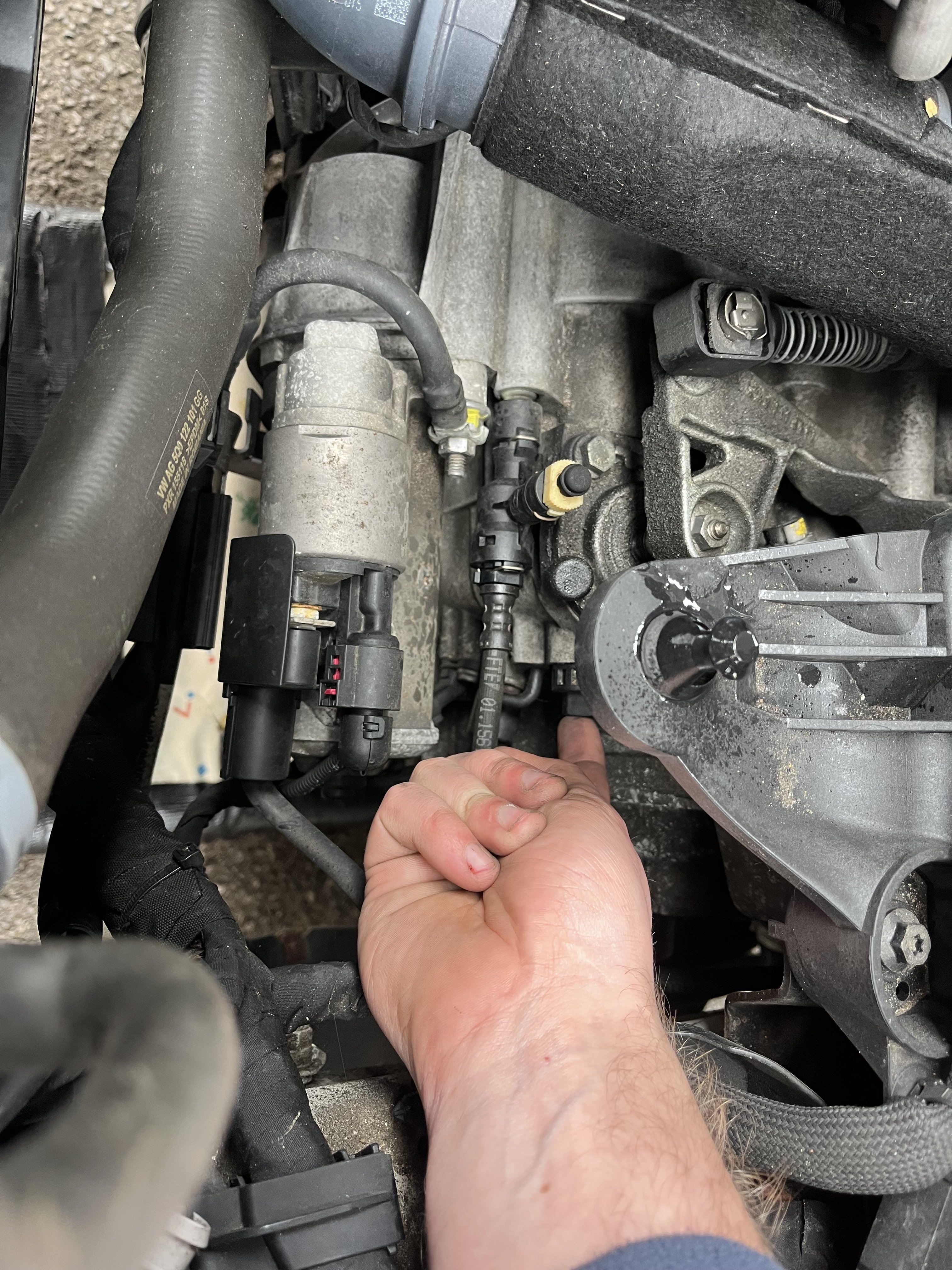

  1. Thanks all for replying especially the guy who put the link to the workshop manual. It’s finally done, I filled the oil after removing this plug- see pic. Fitted a new plug also new copper washer on drain plug for peace of mind and happy days!πŸ˜€πŸ‘
  2. Hi Skoda superb 2018 2 litre 190 diesel with 6 speed manual. I am trying to change the gearbox oil and cannot find the fill plug only the drain plug. My question is does it have one? I found a YT vid for 2016 passat same engine that has a fill plug but on my box casting there is just a flat with no hole in the place where the passat has one... Haynes skoda superb manual is useless just has a generic instruction but it does mention some vehicles are filled from a breather valve hole on top of the box Does anyone have any experience - tips? oh and please dont say its filled for life - I am an engineer and dont believe in fill for life advice, plus i am planning to keep the car for many years Thanks in advance.. simon
