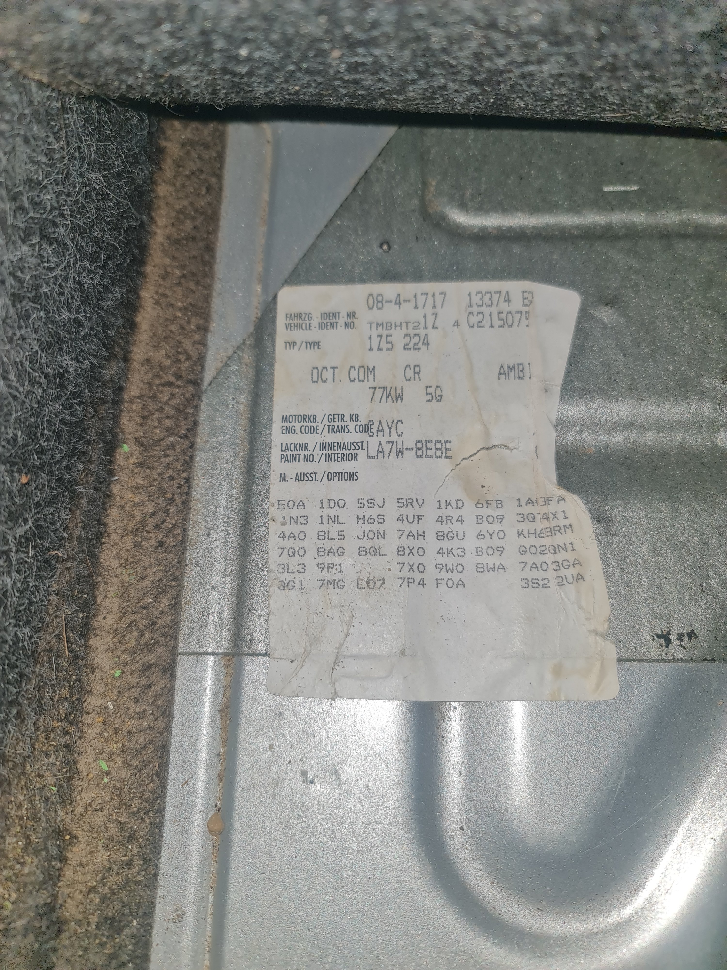

  2. Hey Pikpilot, thanks for replying. We had checked on tester and nothing comes up, has 160k miles 🫣 and I'll upload a pic with the label i found by the spare wheel. Makes no sense tho as today the light didn't flashed... sometimes i can drive for 3 days without the light flashing red 🤦‍♂️🤷
