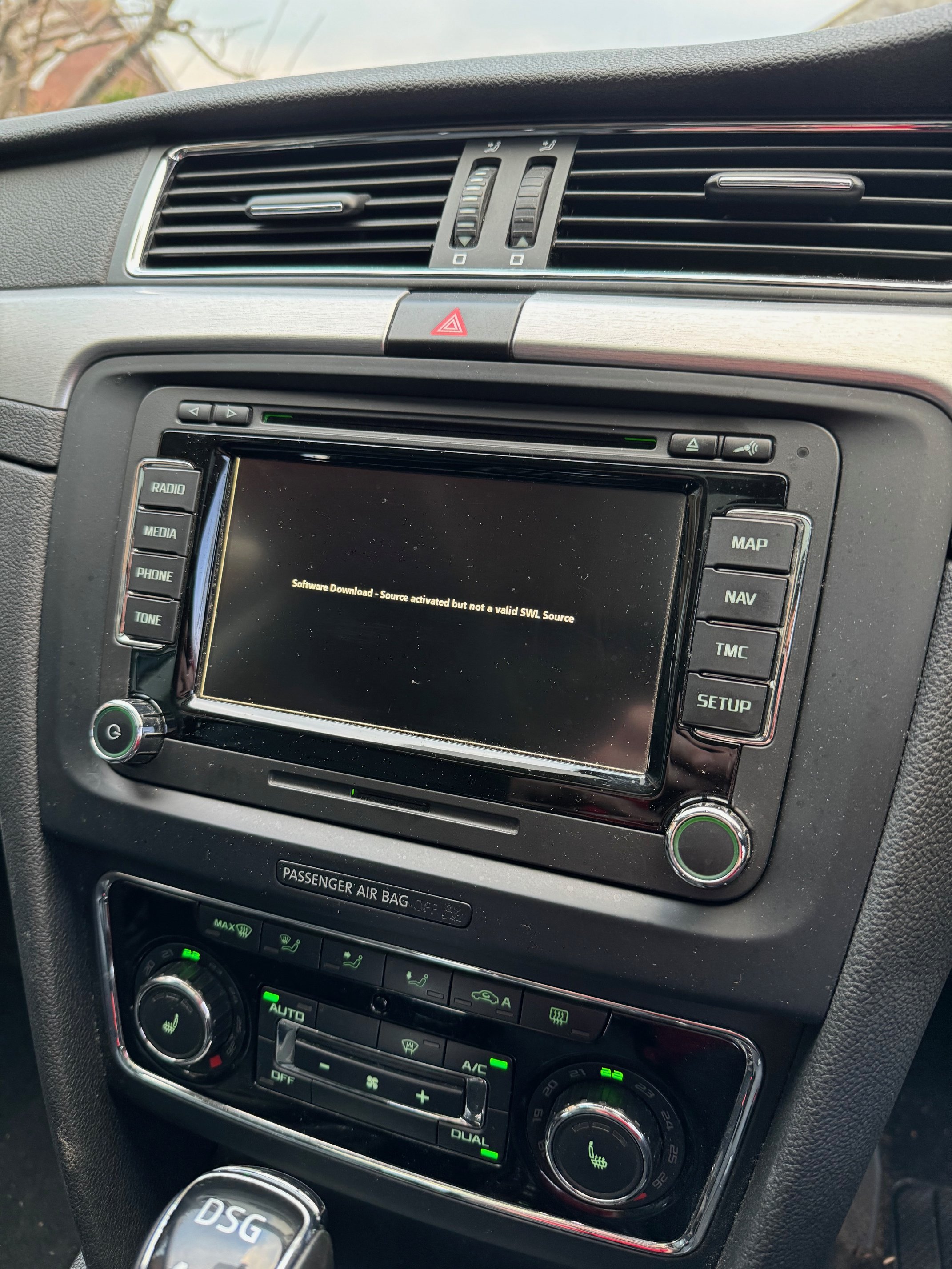

  6. Yeah, it's definitely either the CD or the copy of 5238 I downloaded. Found a copy of 5382 (which I know will probably not be compatible) and it booted up the installed straight away; albeit to an error message but it is working with the installation cds.
  7. Gave it a go earlier. Windows 10 & 11 refused to recognise the blank disc for me so had to write it with a Mac. Downloaded 5238 from a link on the forum, burned it to the disc, loaded it into the headunit, initialised all well and good but I am now presented with this screen. I am assuming it's not liking the disc as I've had nothing but problems with them.

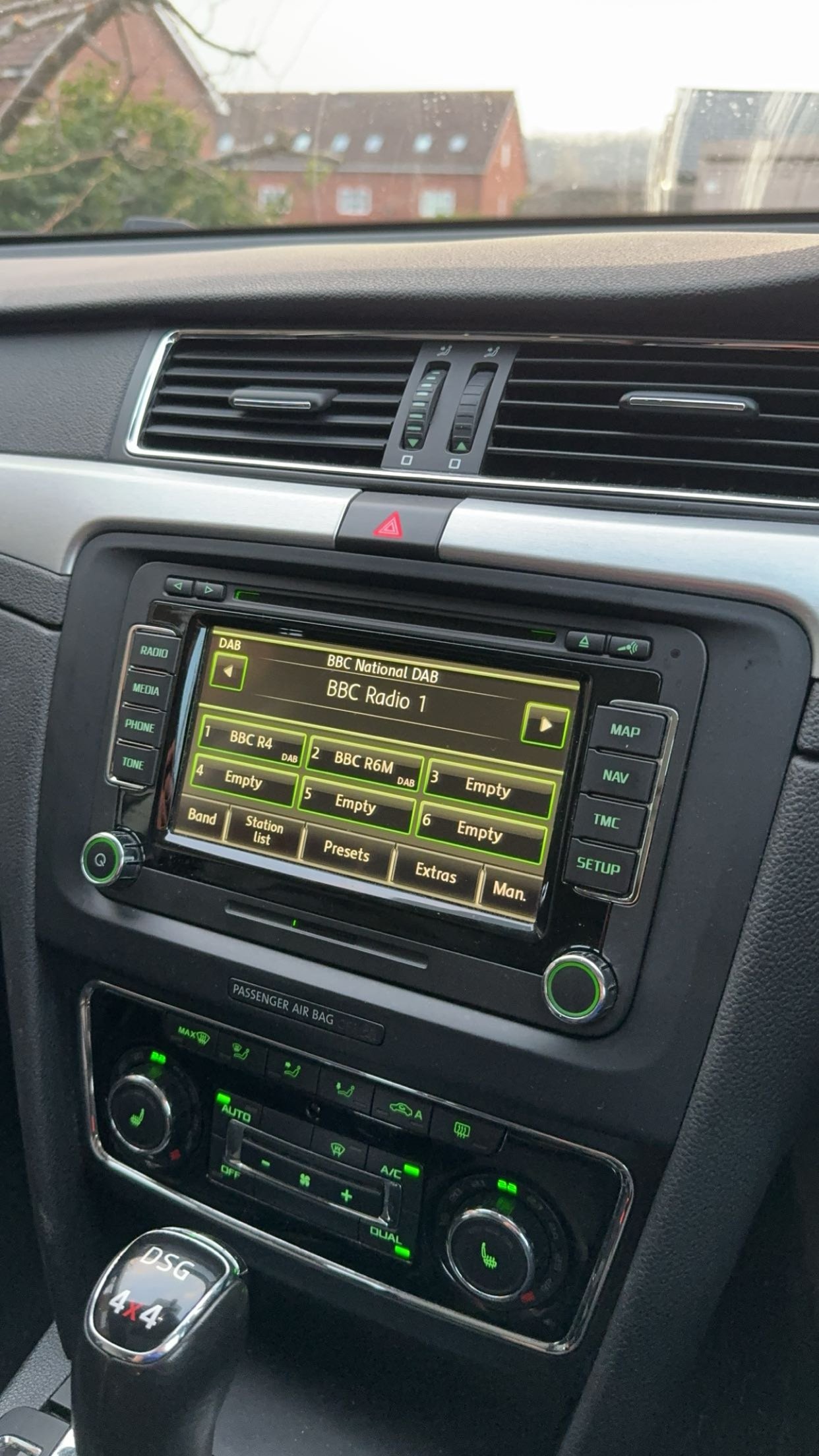

  10. Hi all, first post on the forum. I recently picked up a 3.6 Superb Estate and I'm rather enjoying it. When I bought it knew it had a faulty head unit, and was always going to take a look at it. I know they are a very common failure point so thought I'd document my 2024 experience with it. Whilst I don't have any experience with OEM head-units (outside of 3rd party Chinese ones), I do with PC electronics, I'll try to pull the unit sometime this week and test the various parts. I'll attached a video below, it either does this in a loop, or just stays on the Skoda loading screen; which I'd assume is possibly some sort of CPU/motherboard failure but I am holding in hope that it could just be a faulty drive. I'd certainly take and appreciate any suggestions/tips from someone more experienced though. 😅 -Laszlo headunit failure.mp4
