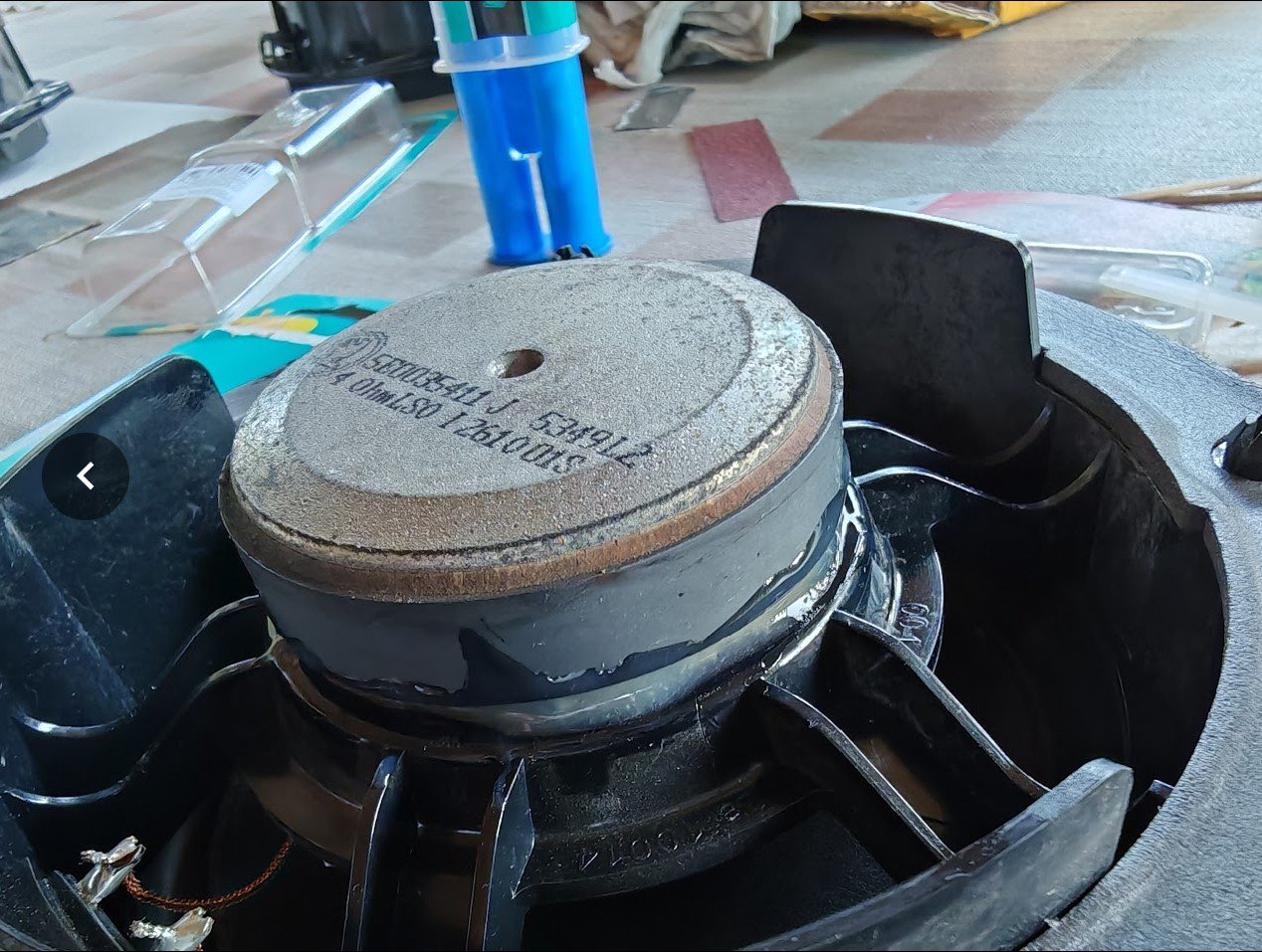

I did some research on this topic — the Russians are the best at it, especially on the drive2.ru forum. Newer Octavia 3 models mostly have speakers with the part number 5E0035411J. They have a large magnet compared to older series and sound good. However, they have an issue with the magnet shifting or coming off. When the magnet moves slightly, it presses against the voice coil, and the speaker can no longer play, or the coil scrapes against the magnet, producing a crackling noise. This seems to be a common problem with this speaker series. If the magnet shifts or falls off, a special centering tool is required to realign it. It can be fixed, but it’s difficult. I didn’t want to buy aftermarket speakers (Hertz, Pioneer, Ground Zero, etc.) because I believe that the cheaper series without an amplifier wouldn’t sound any better, and I’d have a hard time with installation, spacers, adapters, and so on. I ordered a used pair of 5E0035411J speakers for my Škoda, €40 per pair. I applied Bison two-component epoxy adhesive around the magnet, and I hope it can no longer shift. The sound is back to its usual good quality — there’s a nice amount of bass, nothing premium, but perfectly satisfactory for a car

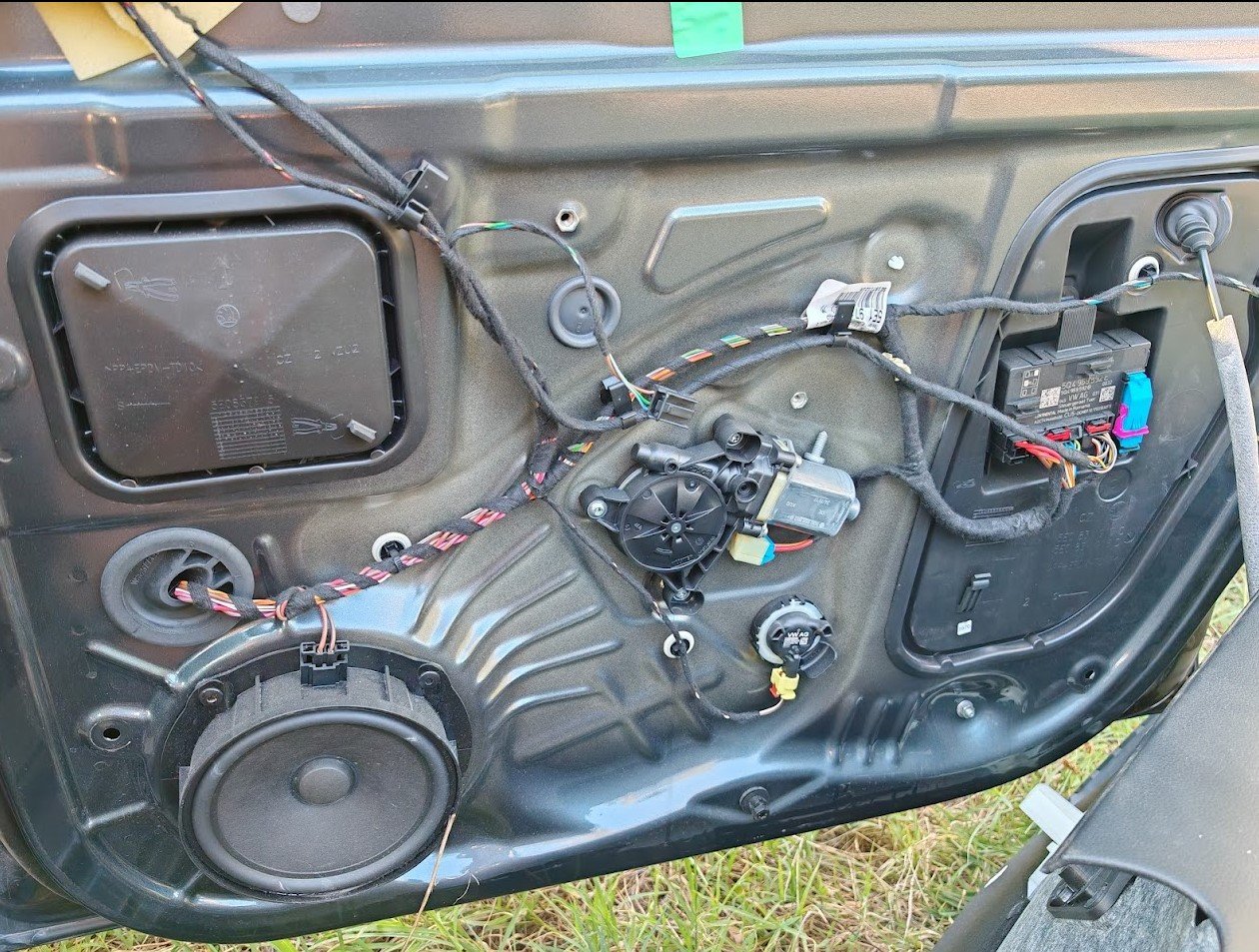

Hi everyone, I drive a Škoda Octavia Mk3 and have generally been quite happy with the factory audio system – it's not high-end, but it delivers decent sound for everyday use. Recently, however, my front door speakers started failing. The left one crackles badly, and on the right side, only the tweeter still works. No idea how it happened – maybe the kids played something too loud... Now I’m considering replacing the OEM speakers with something like these: 🔗 Hertz Uno K 165 – 300W Component Speakers On paper, they look good: 93.5 dB sensitivity, decent power handling, and Hertz is generally a respected brand. My question is: Would these offer a noticeable improvement over the factory speakers? Or would it make more sense to simply source used OEM replacements? The originals have basic paper cones and small neodymium magnets – they look underwhelming, but surprisingly, they sound pretty good, with decent bass response too. Has anyone here replaced the stock speakers in a newer Octavia (Mk3 or Mk4)? I'd really appreciate any feedback or recommendations based on your experience. Thanks in advance!
