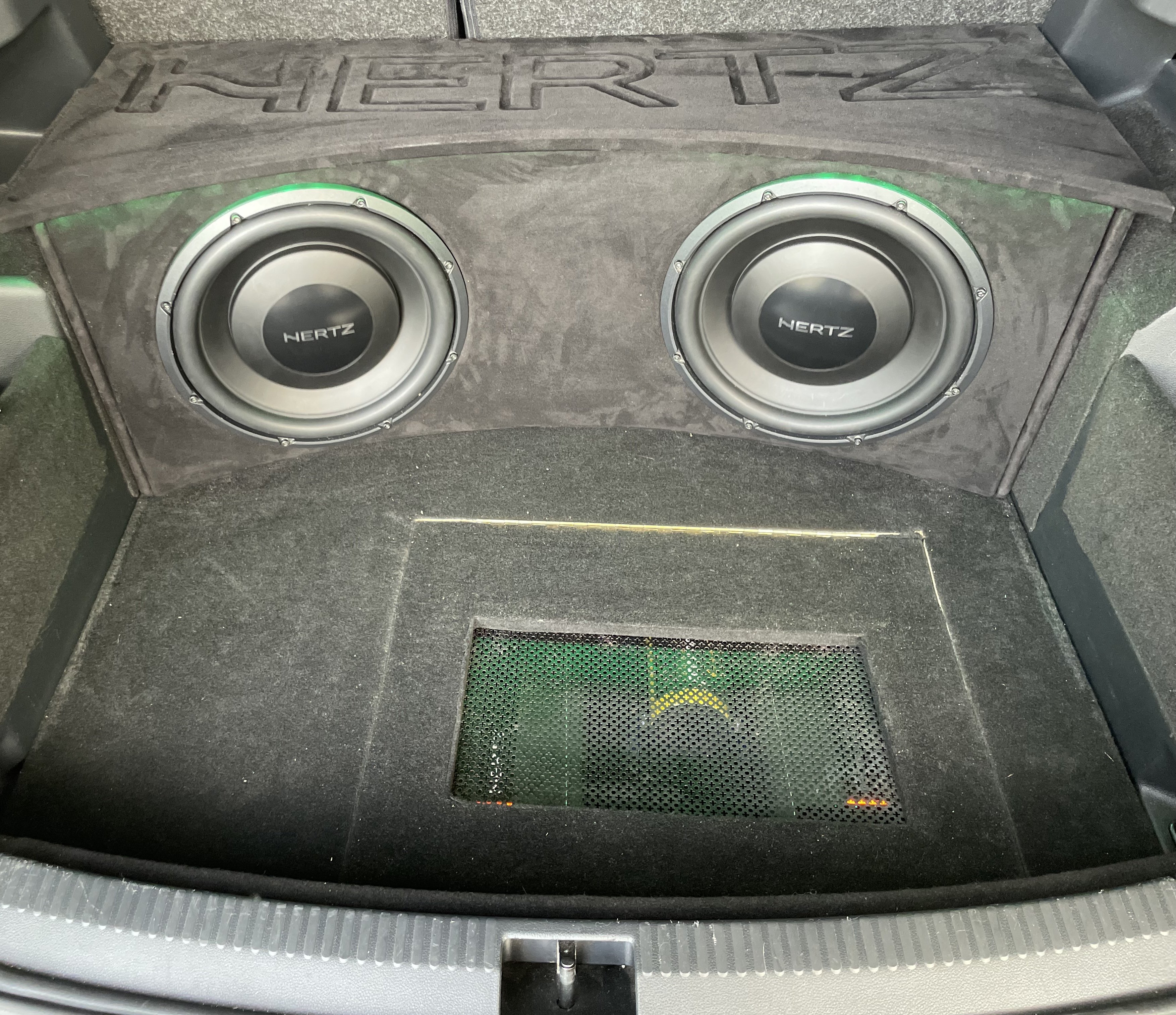

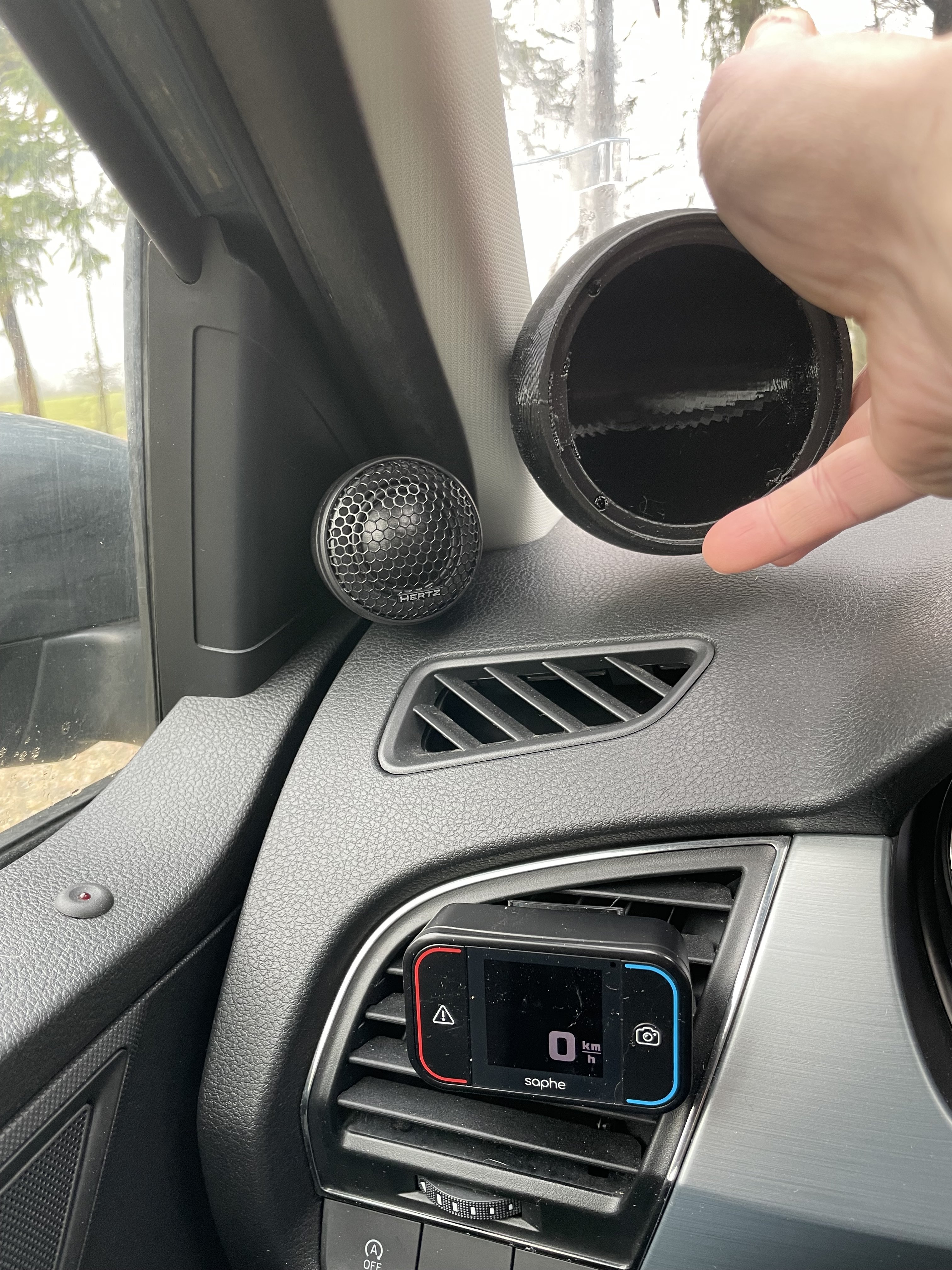

i have full hertz system in my fabia combi. 165 midway dot front. tweeter near mirror 165 full tone back. 2x hertz mps300 s2 in the back and 2 x heartz mono blok 1000 rms each. and match pp62d dsp with build in amp also for front. its sound amazing. all is hertz pro series.
u have to drill the speakers out and buy adaptors to new speakers and a an adaptor to wire for vw.

Nice setup too! Vibe is a power monster! I have switch the original battery to a 90 amp and then bridge in the back and 100 amp more.
It’s hard to find a headunit that matches the size instead of admunsen mib2.
My future plans is those midways 70.3 and more sound isolation.
Back seat is my trunk! Nothing allowed in the real trunk because of all that electronic
