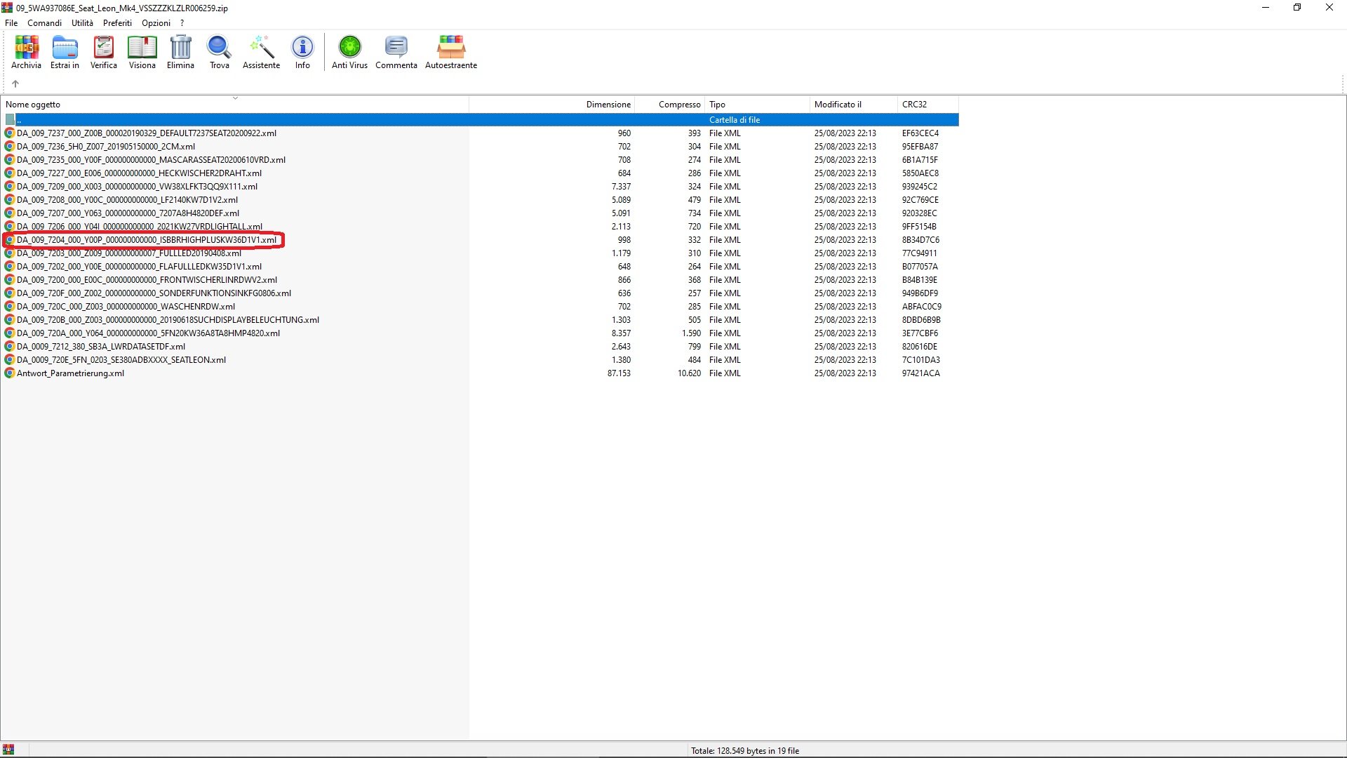

  6. Hello everyone. A friend with an Octavia SW my 2021 asked me for an upgrade from the low version rear lights (PR 8VG) to the high ones (pr 8VQ). I would need the BCM dataset of both the high and low versions. I attach the photo of a dataset (obtained on another forum) with PR 8VQ, but from a Seat Leon. I need the one circled in red. Thank you so much and great respect to whoever will be able to help me!
