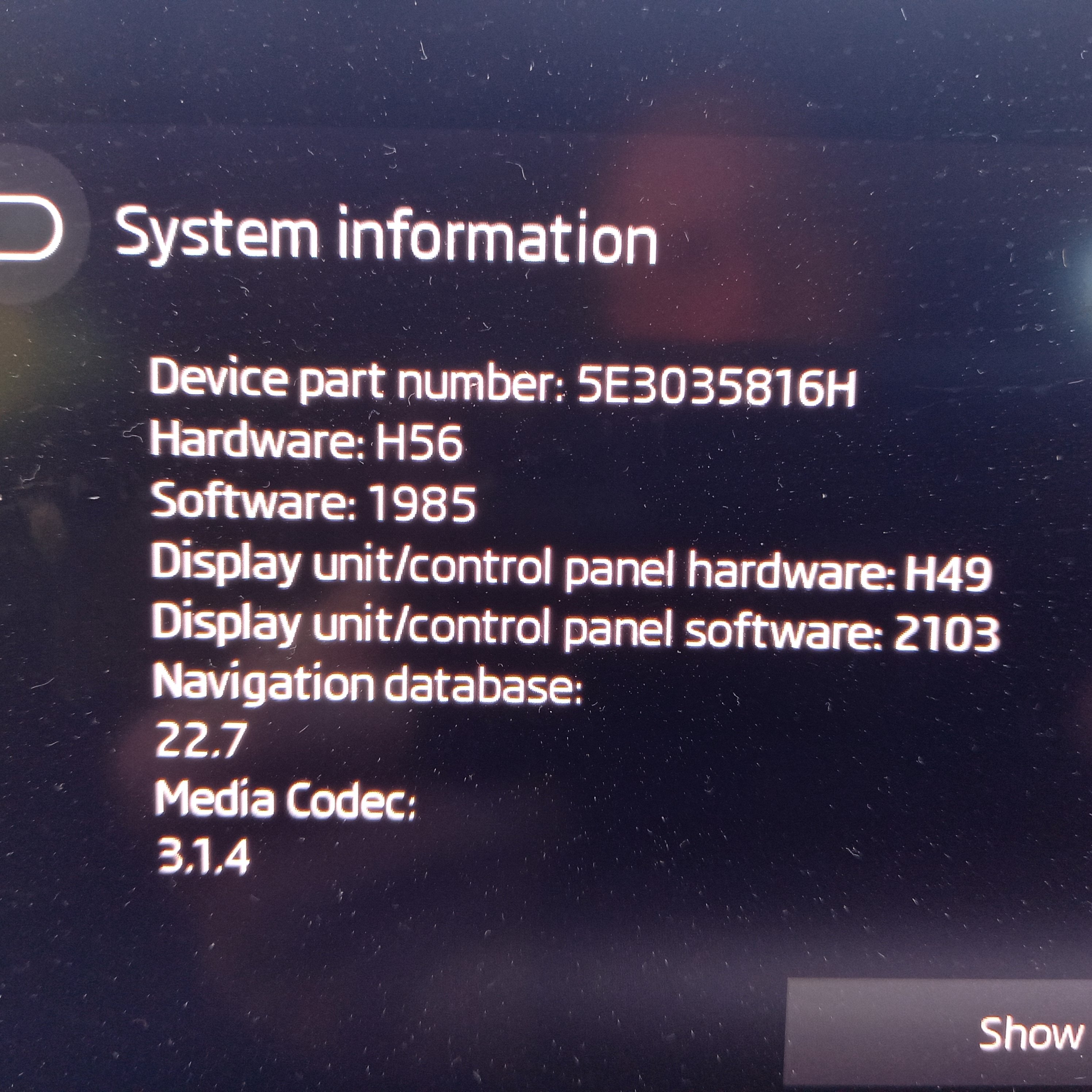

  2. I had the PDC issue and it was fixed by the dealership in January 2025 with a TPI software patch that was released in December 2024. This work was carried out before the OTA 1985 software update was done. Maybe worth asking if your vehicle has had this TPI implemented before replacing the battery or sensors. Prior to the TPI being actioned the dealership was chasing (for several months) a poptentially high current draw from the battery, which was suspectedly caused by the infotainment display not going to sleep when the vehicle was switched off. The battery, alternator and infotainment display were all changed to reduce current draw but this didn't help the PDC issue. I believe my PDC problems started with a previous software update (1981 from memory), but the dealership didn't wan't to consider this. Switching on the ignition a few seconds before clutching and cranking the engine also worked for me and others. The dealership's technician told me that the TPI mentioned this sequencing. If all relevant software patches have definitely been done and fault persists, then I'd personally be checking the battery condition or battery current draw in standby mode (if possible), before replacing all sensors. Has a load test been done on the battery? Might not be of any help, but the attached scope plot shows my new 59Ah battery terminal voltage dipping to around 8.3V from 12.2V during cold cranking. I only experienced the PDC issue during colder conditions.

  4. The Skoda dealer applied a TPI software update to my vehicle 3 weeks ago to rectify the PDC issue. I don't have any other info, but assume PDC unit upgraded to SW581/582, as mentioned above by andreiro221). I've not experienced any PDC errors since. I also had an OTA update a couple of weeks ago for the MIB - now on version SW1985.
  5. Skoda recently released a software update to fix the PDC issue. My car had the update done last week by the dealership - so far so good. An OTA MIB software update is pending to fix some instability issues with the infotainment system.

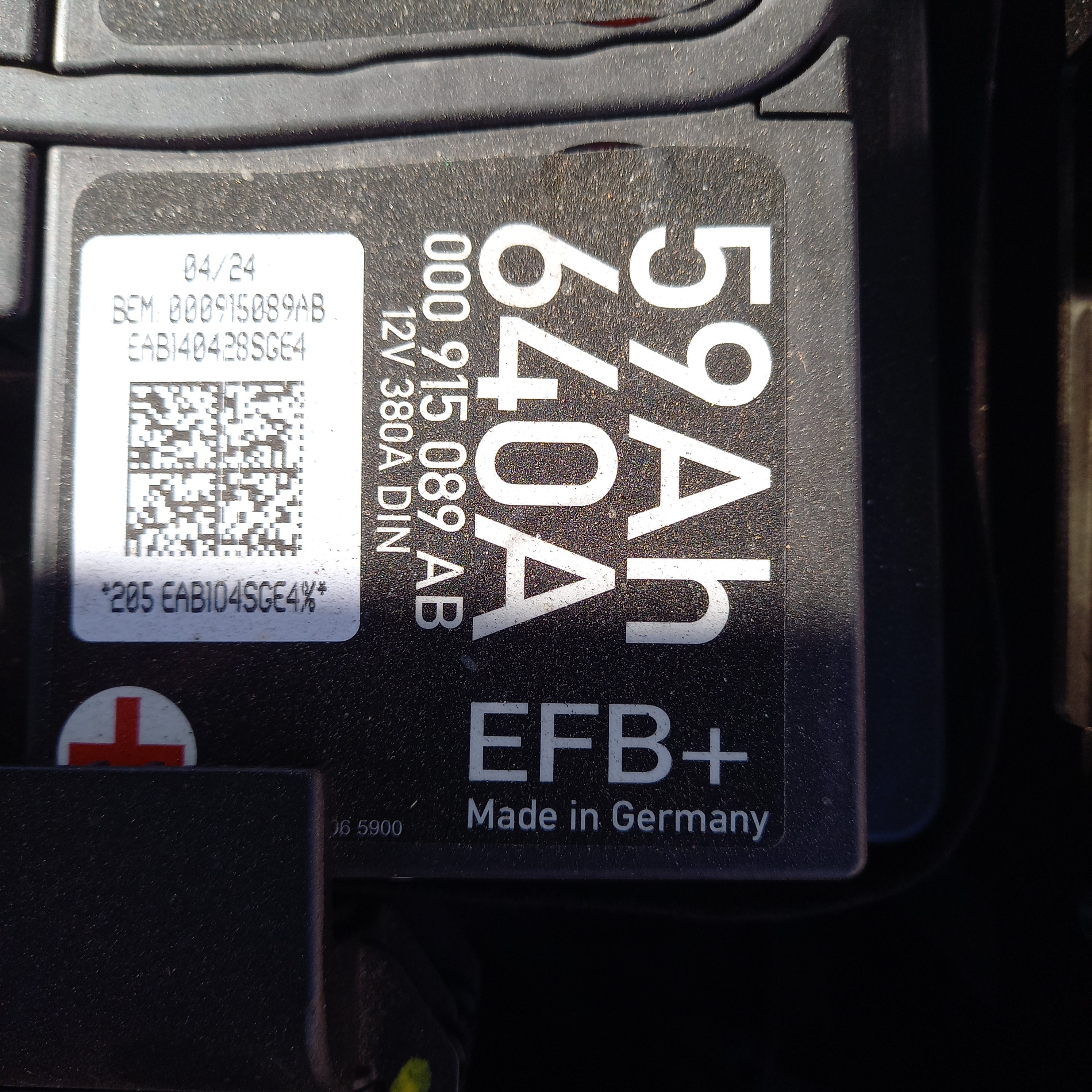

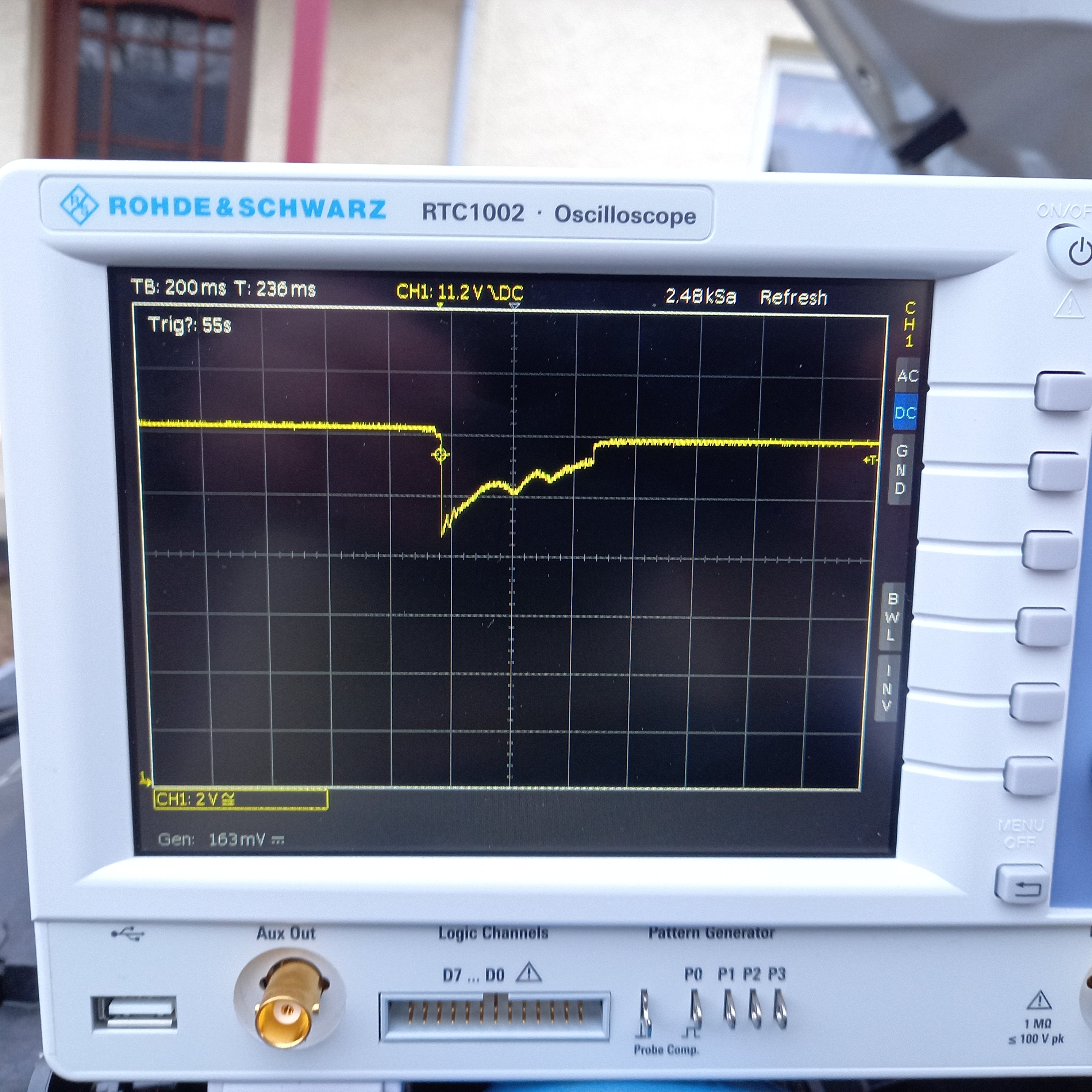

  6. My intermittent PDC error returned about 4 weeks after the dealership replaced the infotainment display unit, battery and alternator, and updated the software to 1969. The fault is still occurring more frequently during cold weather. The battery terminal voltage dips to 8.4V during cold cranking, which seems acceptable. Anyone else still having the same PDC issue or had it fixed by the dealership?

  10. Thanks for your replies. I'm now thinking that the PDC could be malfunctioning due to a brownout condition in some electronic circuit, caused by a normal drop in battery voltage during vehicle cranking. The voltage drop would be made worse by cold conditions/battery somewhat discharged/unhealthy battery. Initialising the PDC before starting the vehicle should get around this, as we have seen. I'm not saying that the issue isn't somehow related to software as I also started experiencing the problem a few weeks after getting the 1941 upgrade - a parameter migh have been changed, or a supply line sequenced differently, which is making the system more sensitive to battery voltage dips. Just a thought at this stage.
