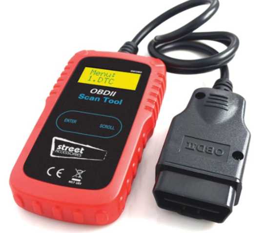

  5. I've scanned the car (Ancel BM700) but no fault codes. Display says actually says "sensor impaired" so presume its got something over the radar. I'll look at checking it when it stops raining!

  9. For info, the 1st scanner was like the attached and the 2nd a Bluetooth one with Torque app
