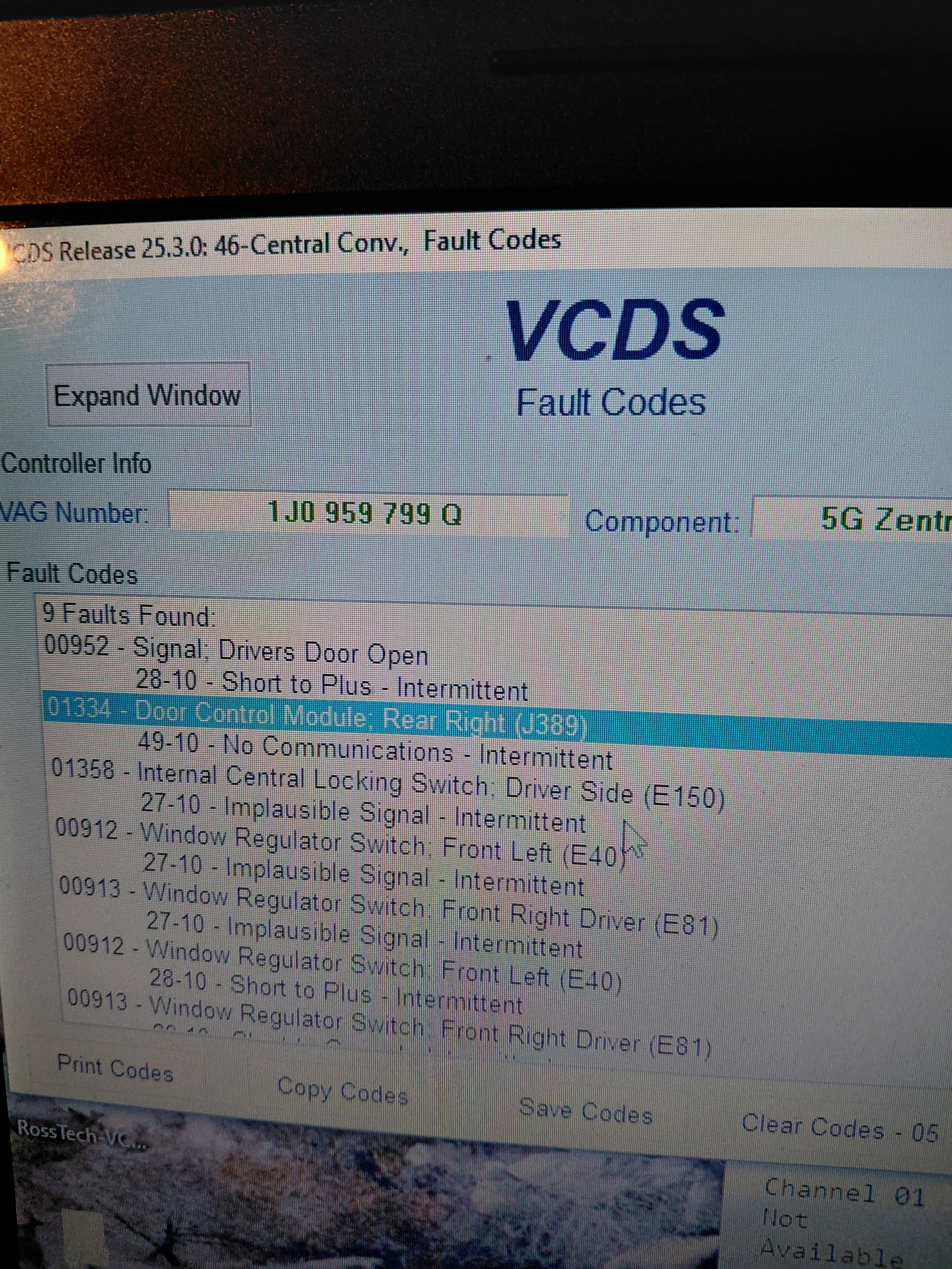

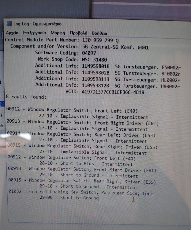

  1. Hello! Sorry for the late update, the weather wasn't on my side. I checked all the wires and they all seem fine, even the one on the driver's side that had broken off and fixed it a few months ago. The only thing that I didn't check was the ground for the CCM. Is it a standalone wire that bolts into the chassis or does it go back to battery? I rescanned the faults so you have a better idea. I'll remove all the panels this weekend as I will be off work, to make sure it's not hidden behind the panels.
  2. Thank you both of you for your help. I'll trace the wires and grounds tomorrow and I'll update you.
  3. Okay I'll check the wires. I had issues with the driver's loom before and couldn't unlock the car, but I have fixed, so I'm quite familiar with it. Somewhat out of topic. Could this cause vcds to show central lock not available?
  4. Everything works, locks, windows. Sometimes the rear right lock doesn't work and I have to close it manually. The windows sometimes go up and down when I try to lower them, but I am pretty sure it's because of the main window buttons
  5. Hello everyone! I was trying to code remote controls on a key that I bought, but it showed on [46] central convenience, adaption, the first option that is not available. So I scanned faulty codes on the [46] and all these popped up. Unfortunately I can't send the logs, as I cleared the codes, but they pop up slowly again as I drive it more. Could this be a CCM problem? Or is it something else?

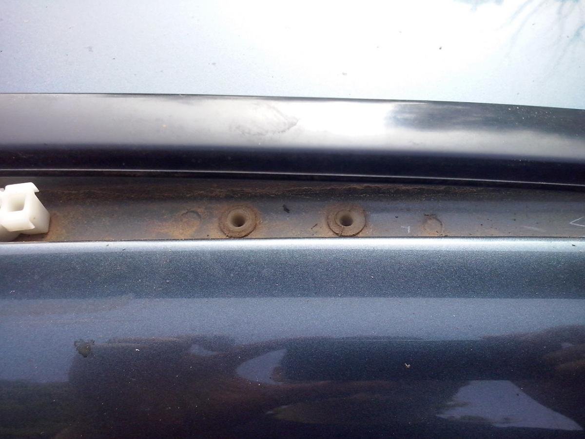

  6. Update, its the roof rack holes, the plastic thingies are missing. And water was getting in, between the A-B pillars and B-C pillars, and also the water was following the metal guide and was going to the trunk. Can I find the original plastic inserts anywhere, in order not to use silicon? (not my picture, took it from a member of this site, using it as an example for the others to know)
  7. Just checked, the water doesn't get in from there.

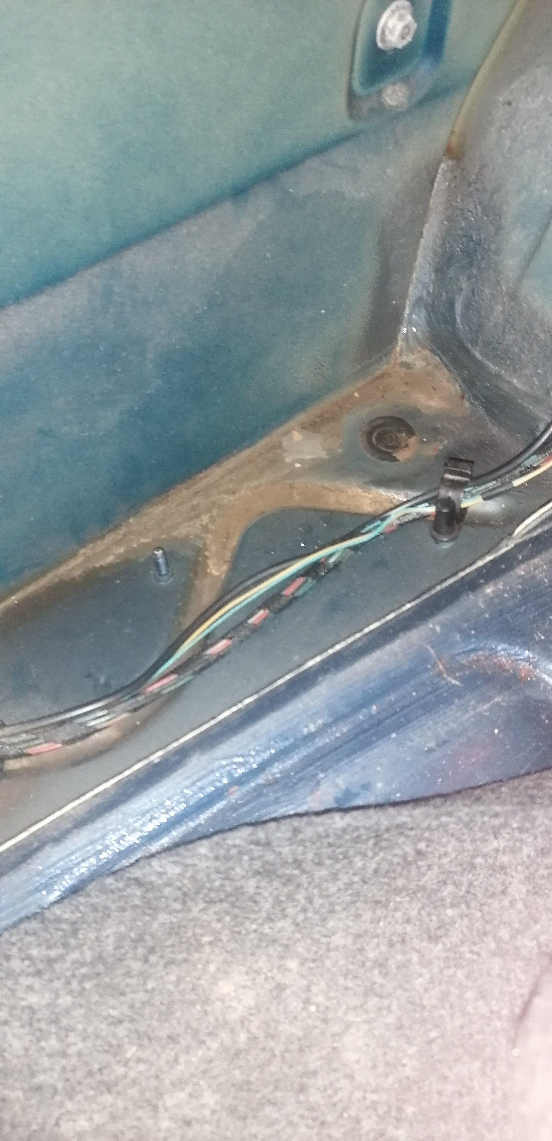

  10. Is there a possibility that the water comes in from the outside roof trim? The plastic trims that goes from the front to the back on both sides, because there is water coming from both, left and right side. I've checked the seals on the boot and doors all seems good, so it's probably not that. Even if it was that how does it get wet above the a-b pillar. Anyone that has any idea, would be very helpful! Thank you!
