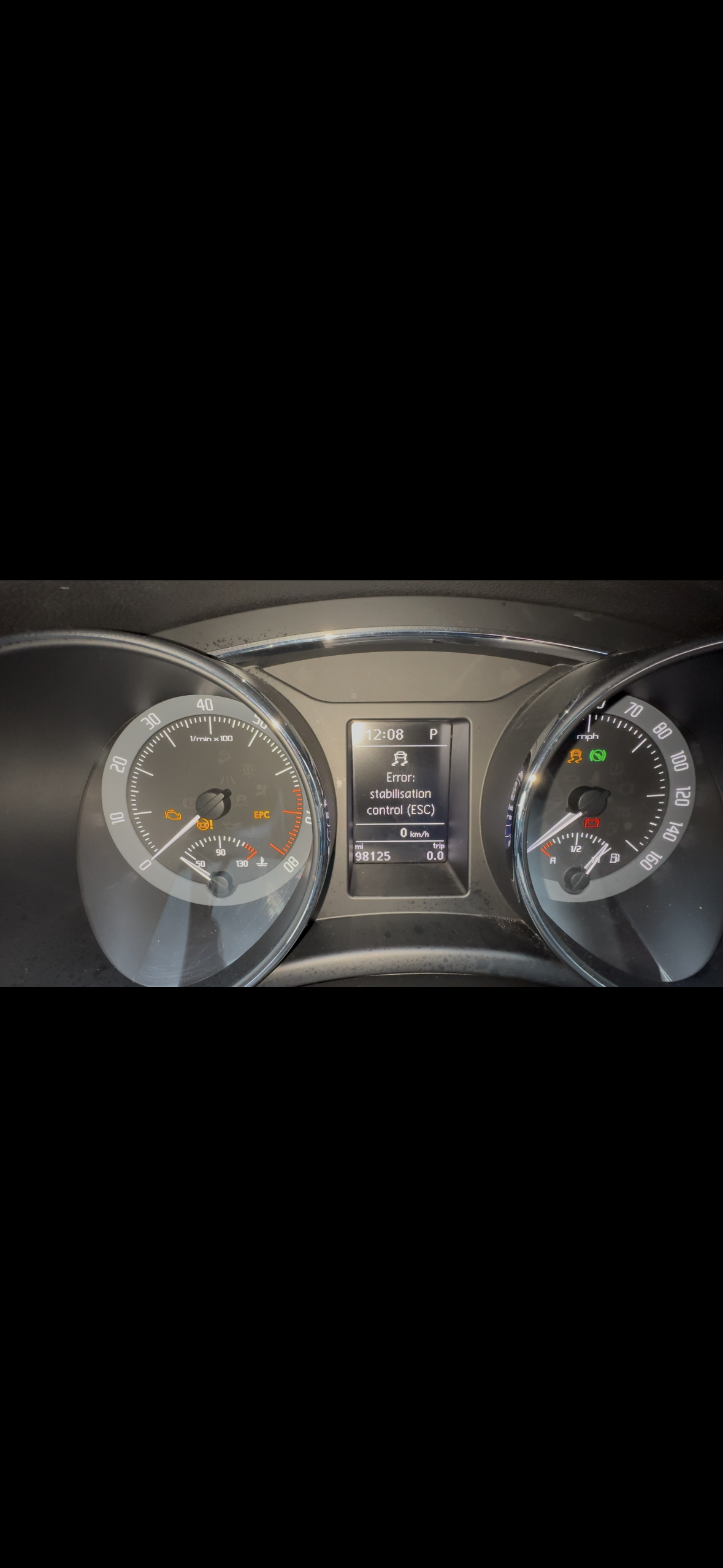

  1. Hi, having a bit of a nightmare, car just stopped dead. When ignition is turned on fan is running with engine management light and epc illuminated and flashing also ESC fault shown. when connected to diagnostic, getting 01166 Engine torque signal fault, 02391 Terminal 30 fault. I have started at the fuse box and working back, would anyone have a wiring diagram showing the terminal 30 path. I’m not getting any voltage through the terminal L on the fuse box. any help is greatly appreciated.
