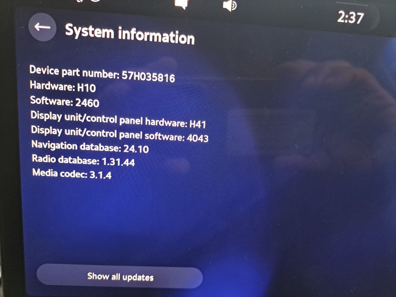

  3. My car has software 2460, I picked it up in July. It had the terrible software faults, I picked it up on Friday, returned it on Monday, it took 5 months to sort it out. There were 9 major software faults that had to have the software completely rewritten. My theory, no proof, is Skoda knew the faults, they were too major to ignore, but had the British Leyland attitude of sell the car and sort them out after. That saying the do seem to be sorted, I have had the car back for 8 months and all seems OK. My main niggles now is the interior lights have a mind of their own. They sometimes come on by them, I turn them off and they come back on. On, off, on off until they decide to work or the system crashes Hopefully the dealer will sort it at next week's service

  10. My update in the beginning of December seems to have sorted out the problems. The car is permanently online, Skoda have a server in Germany, the cars talk t that. There are updates on line but this update is very large affecting various safety systems and has to be done at the dealers. I have had no problems with doors. Mysoftware version is 2460 it was one of the the first cars apparently, the software update doesn't seem to alter the software version number Hope that helps
