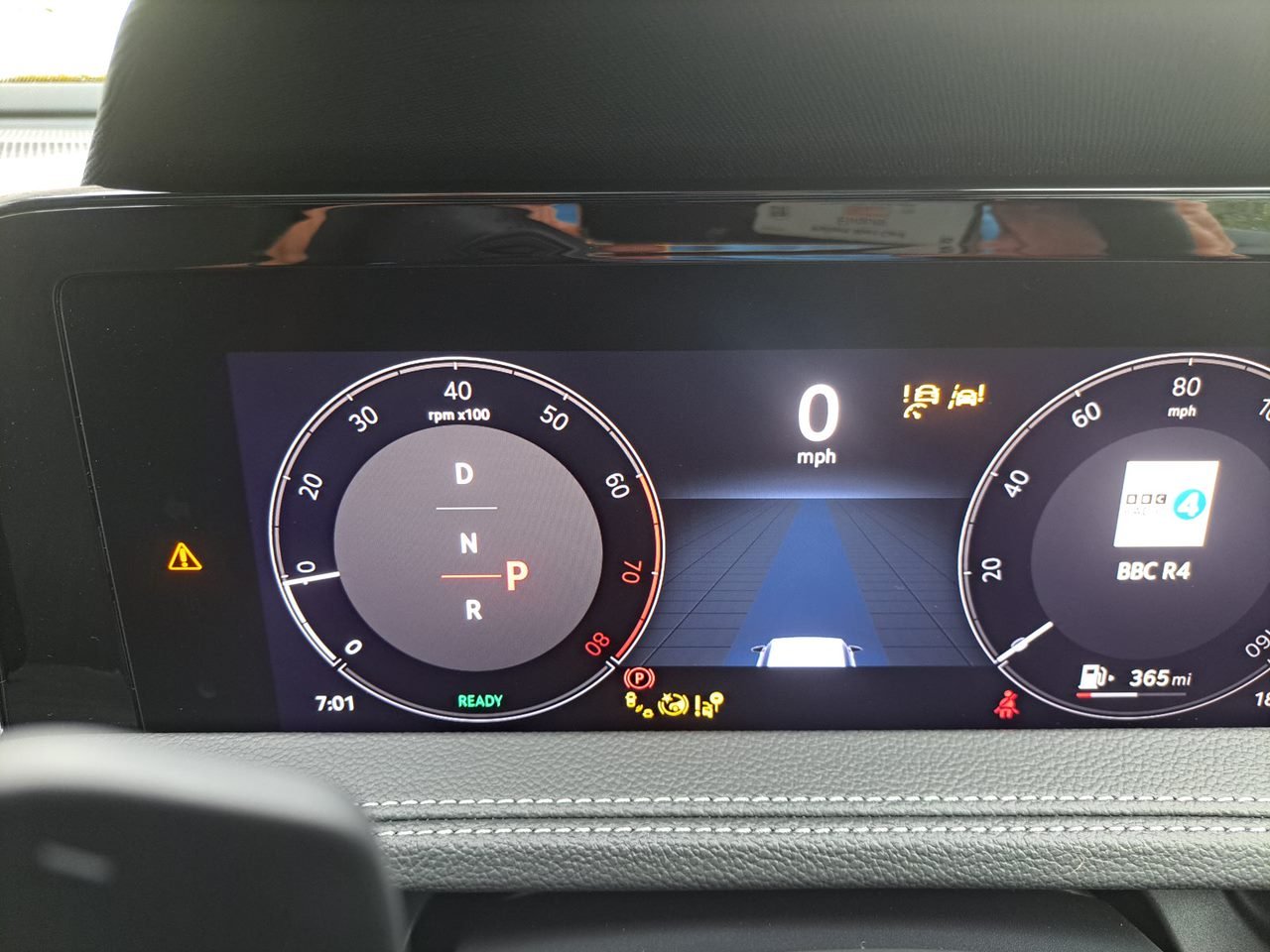

My brand new superb has a software failure :
Side assist unavailable
Lane assist unavailable
Front assist unavailable
Travel assist unavailable
Protective occupant unavailable
Dynamic sign unavailable
Dynamic cornering light unavailable
it has only done10 miles and am told there is no fix as of yet and  has been in the dealership since I picked it up  5 weeks ago.
anyone else have this problem?

As the car is brand new, I have returned it to the dealership.  They say there is a general software fault,  the factory know about the problem and are working on a software fix.
I don't know if the systems are working but faulty warning lights or if the systems are not working
I have a feeling this is a software fault and I think there is also a battery problem as mine has twice suffered a low battery for no real reason other than sitting in the car adjusting the settings.
A reboot seemed to cure my car but if it happens again I will take it to the dealers.
btw, the dealer new my car had had errors as they emailed the next day to ask if everything was ok, as a reboot had fixed it I did not need to take it in.
The radar definitely worked as it adjusted the recuperation based on the distance to the vehicle in front, but the assistance features were totally off. I am happy they are working on a fix.

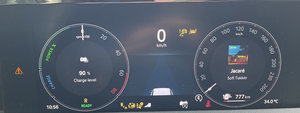

Hi,
I purchases a new Skoda Superb Combi 2.0 dsl (sel Model) on Aug 8th.
On Aug 23rd (last Friday) with approx. 2000 km I  got exactly the same issue as you
  1. Side Assist is currently unavailable.
  2. Lane Assist is unavailable. Please consult owners manual.
  3. Front assist is unavailable.
  4. Proactive occupant protection system is restricted
The car is driving fine. I have it booked into the dealer to run diagnostics/fix.
I will post an update here if I get any additional info. from them.
rgds
mno101

Hi all, I am just back from the dealer.
They did a software update and the issues are now resolved.
The update took approx. 2.5 hours including a test drive.
Not sure why this was not done as part of the sale 3 weeks ago. I could not get a straight answer on that.

I had the same errors come up again last week. Turned everything off and got out and locked the car.
Left it 30 minutes and started it up again, some errors were still there but after a short distance they disappeared.
Seems a reboot fixes it,for me.
