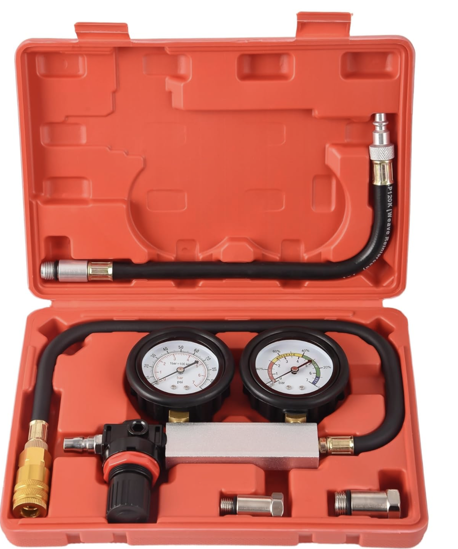

  6. Is this the same thing? I can get one of these or one like yours for tomorrow, this one is £23. (just thinking it may be more idiot proof for someone like me, or then again more technical? The description for the one in the photo is as follows Automotive engine cylinder leakage test kit:Cylinder leak gauge set is designed to detect a variety of common engine faults such as worn piston rings, cylinder head cracks, worn valves and blown head gaskets. It checks the amount of leakage in an engine cylinder and helps determine the source. The cylinder leak tester is suitable for detecting whether the air-tightness of the cylinder of the automobile engine is within the allowable air leakage range. It can also further judge the leakage location and cause from the analysis of the failure phenomenon, so as to take measures to eliminate the failure. Double scale compression testers with measuring range of 0-7bar and 0-100psi, suit for any petrol engines fitted with 12mm or 14mm spark plugs. For use with most makes and models of vehicle with petrol engines (12 and 14 mm spark plug thread), the measurement range up to 7 bar / 100 psi is measured with an accuracy of ± 2.5 %, flexible hose with quick connector and dual pressure gauge. Car leak tester kit detector tool is designed with rubber protective cover on the pressure gauge, anti-drop, anti-scratch, ensure the safety use.

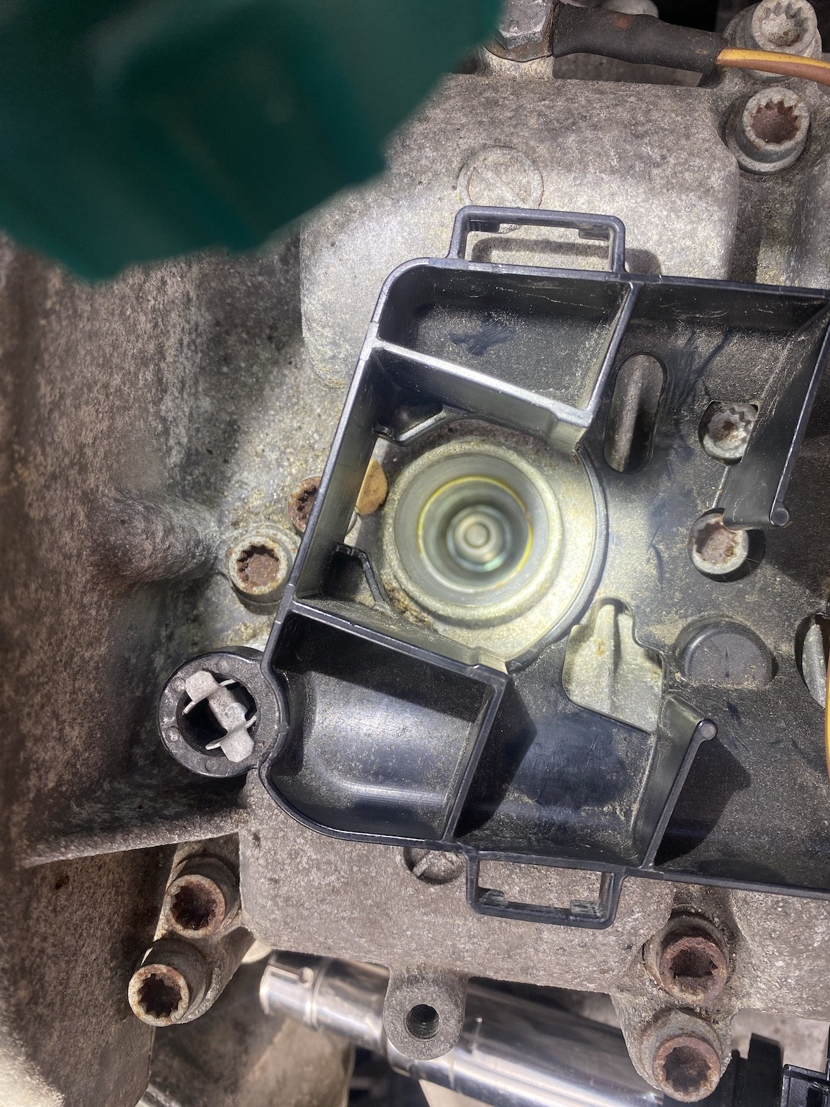

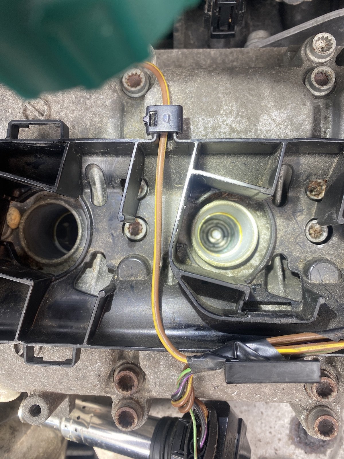

  7. I’ll keep trying to get the other two plugs out if i can work out why there is a rubber surround on them making plug socket impossible to get on, I couldn’t see any damage on the one piston, as in if it’s smacked into the valves, i’d have thought if they had even a light tap they’d be some metal damage viewable. I have no idea what these rubber surrounds are doing as photos of the coil packs/spark plugs don’t appear to show any inserts/covers

  9. I enclose a photo of the plugs in situ, but one has the rubber surround, the other which i first took out and left some rubber debris when taken out has no longer got any rubber around it? I have tried to remove the second plug but cannot get the socket round it due to the rubber shield, on the first one it was sort of prised off a little with a long handled screwdriver by the initial recover guy who then managed to get on the socket to get it out, alas when it went back in some of the rubber was still around the shaft and fell into the block, which i then managed to get back out via some stickytape wrapped securely inside out mainly round a long pices of hard wire which lifted it out. I guess the valve timing is to check the chain hasn’t broke? Thats beyond me at this point
  10. Thanks again for the replies, still stuck on the drive. I can confirm there is a spark from the plug, I have took a plug out and placed it against the block whilst my daugther turned the ignition, the spark was there. I can hear the fuel pump engage when first turning the ignition on, or at least I think it’s that, it comes on for a second or so as if priming and then stops. Thanks re the rubber in the plug, think thats it (from a socket that was applied from a lawn mower long reach one. In edit to the above, I’ve took off the coli pack to a second plug and that two has a rubber sheath around the top of the plug which makes it impossible to get the plug out with a conventional socket, i’ll put up a pic if i can get one from my phone How does one compression test it? I’ve stuck it in gear and pushed it a little, seems to be as normal when you trying pushing a car say for jump starting, it engages/jolts a little?

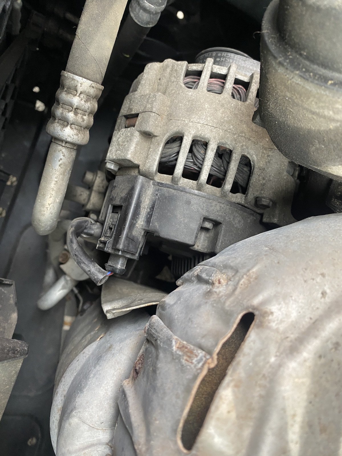

  11. Apologies for the delay, I was away at the weekend with zero internet which was a pain. Thankyou for your input Alasdair1 / Warrior193 / Breeze Pete On returning home earlier today it was noted in the cylinder that was open via removal of the plug that when the person removed the plug for me there was an amount of rubber on the top of the plug which came off, when he removed the plug some of the rubber went into the opening, I've fished it out luckily but I have a notion they tried to start the engine with that bit of rubber in there? I confess to being a little out of it with engines, I'm struggling to get anyone to take a look, although it won't start I'm told that a compression test would help diagnose further. I'll be fully checking the alternator wires tomorrow, I've checked every fuse under the steering wheel, the only error code I can find on my icarplus obd is the camshaft sensor which as stated previous my daughter had replaced roadside before it was recovered back to our address, didn't make ay difference. I can't even tow it to a reasonably local garage that I sometimes use (they stated they'd have a go at diagnosing it if I got it to them) because the power steering isn't working due to my not being able to get it started, making it pretty heavy on turning the steering wheel. I'm at a loss as to what to do, my daughter is fretting as she has Uni restarting real soon and no car at her disposal, I don't want to write it off as prior to this issue it really has been flawless and she has really gotten on well with it. If anyone has an idea/ can come take a look, give me a reputable garage in the east mids (I'm near Ashby de la Zouch) or can come speng a bit of time on it at my address to at least get it diagnoses (expenses paid). failing that I don't have a clue. Thanks anyway for your input, it's much appreciated.

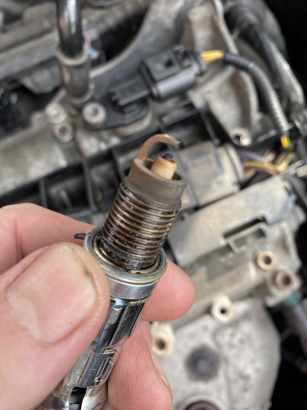

  12. Hello Alasdair, thanks for your input. I checked the wiring, there are two wires, red and blue that go to the top, they appear intact? I’ve since managed to remove one of the spark plugs and turned the engine over via the ignition and although it wont fire/start the piston was moving freely inside the barrel of the spark plug. One thing i did notice was the plug that came out seemed a little dry but came out ok, but the gap seems artificially wide but maybe thats me, does the plug look healthy/unhealthy? I checked the spark on the plug (placed it against the engine) and no problem with that either.

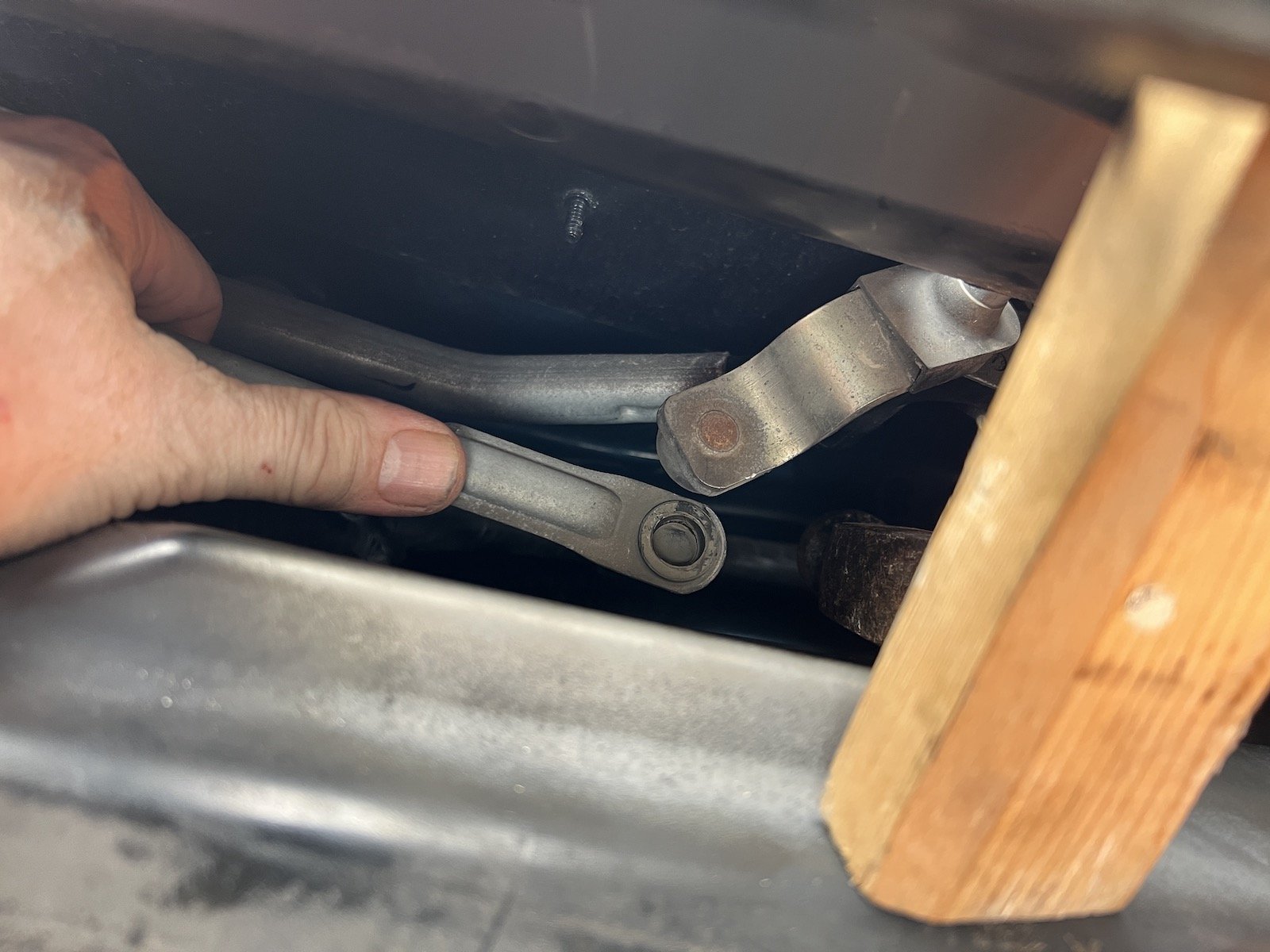

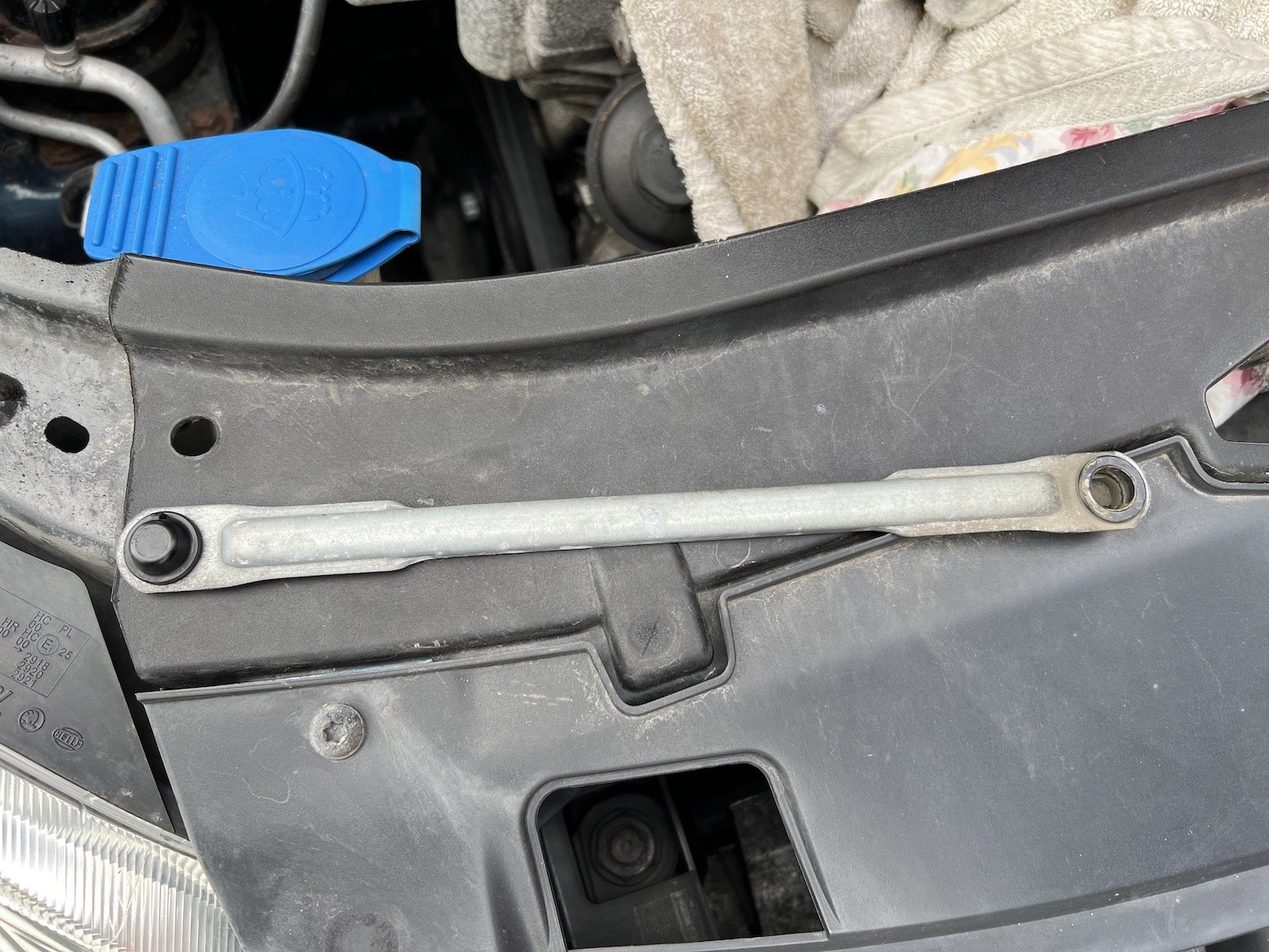

  14. I can buy just the arm, for about a £5 but how do they actually fit? there are no bolts/threads just a bush.... Burt yes may just buy the whole thing if it's not too much of a faff to fit. I note they sell a set of repair clips that hold it on once attached, presumably this would be a short term fix.
  15. Ok, have gotten a bit further and it looks like the bushes on the arm that goes to the passenger side is goosed It look like one of the rubber bushes has dried of any grease it may have, do I need to grease it and try and 'pop' it back on or is it a complete new wiper linkage that is required as presumably the rubber bushes are not available separately?
