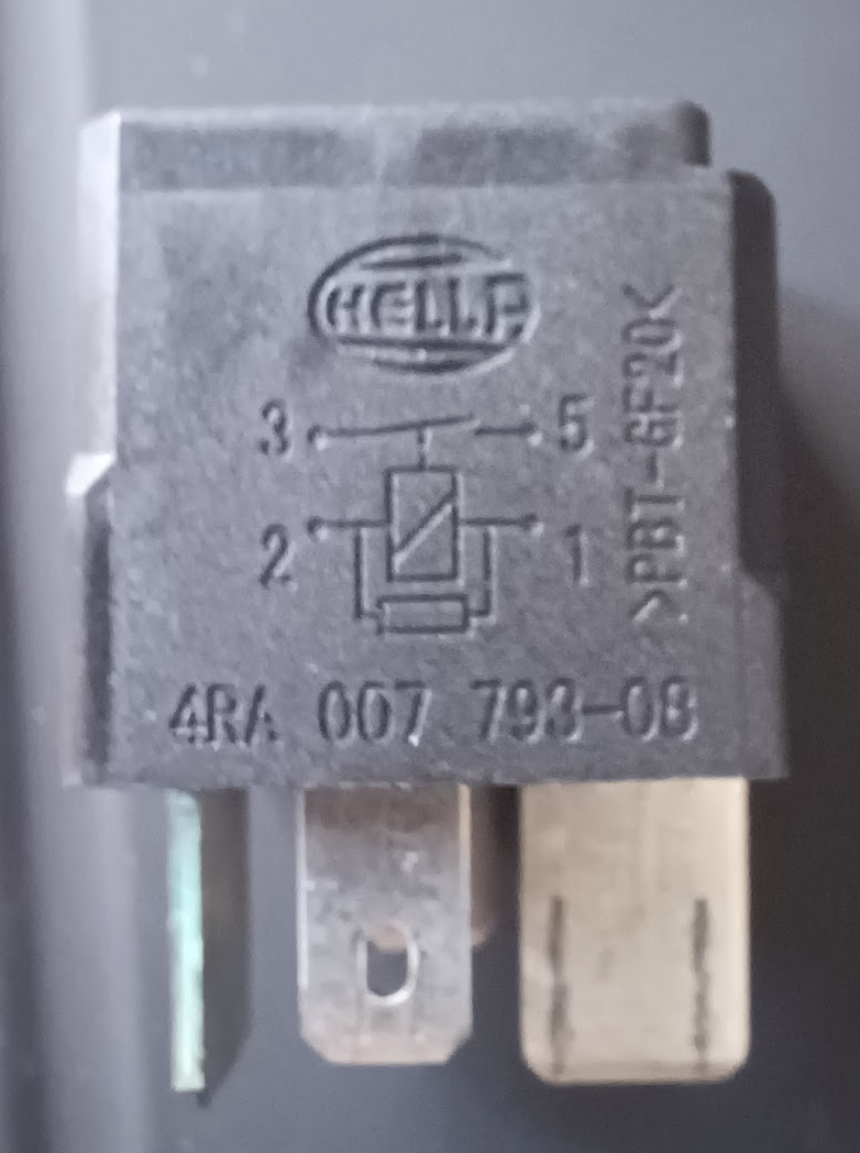

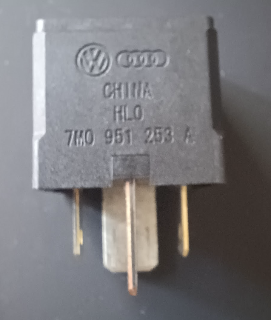

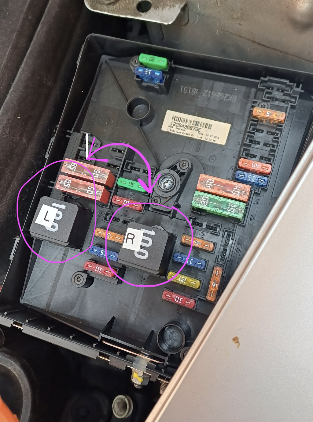

  1. I sent the car to https://www.votexltd.co.uk/ who recommended replacing the R1 and R2 relays. As a test, I swapped the R1 and R2 relays with each other and have not a problem since! Clearly one of them is faulty and needs replacing, just need to figure which one Does anyone know which relay is responsible for ignition?

  4. Update: Issue was investigated by Medlicott Motors (CW12 1NJ, Congleton) and eventually found some evidence of copper oxidisation on contacts inside the engine compartment fuse box. Cleaned up and put back together. So far the error has not repeated so this may be the root cause. 👏😃

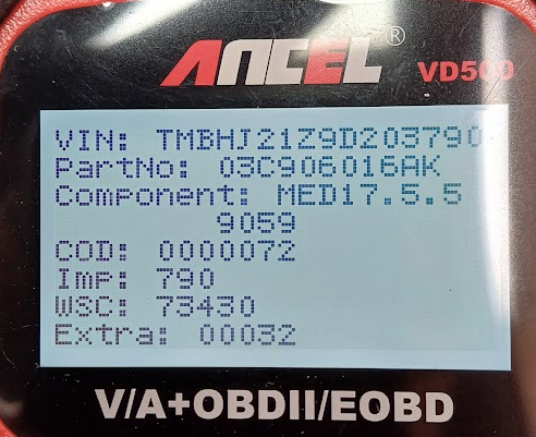

  5. Update: This condition occurs in a range of temperatures and not always in the morning, but always when starting. ANCEL VD500 V/A Diagnostics run on the ECU (MED17.5.5) reveals error code 01674 "ECM/PCM Power Relay De-Energized Perfromance - Too" (attached)

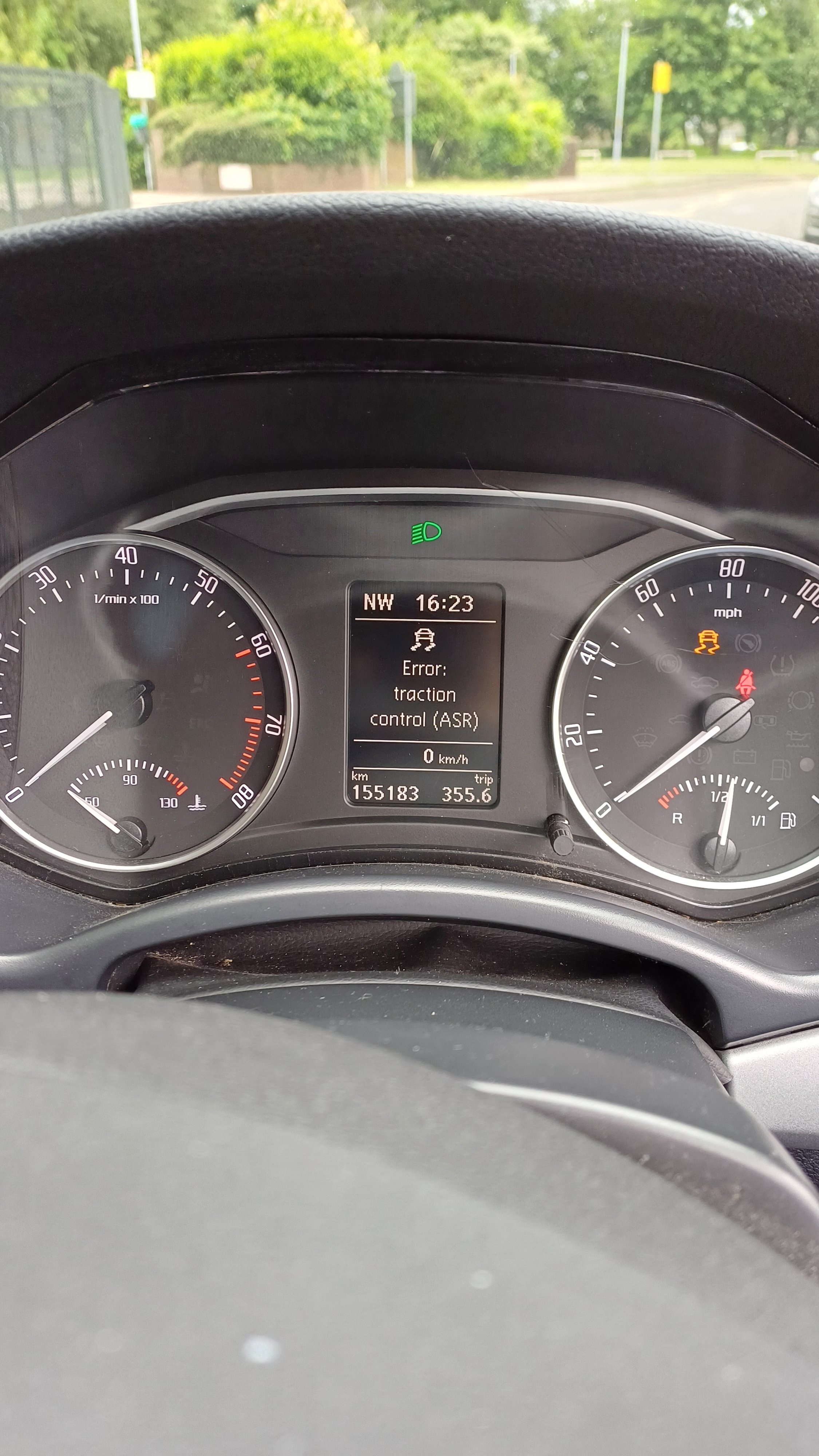

  9. I check the battery with Bosch diagnostics at Kwik-Fit - no issues, fully charged and able to handle the load - so doesn't look like it is battery related. Below is a shot of the MFD error from this morning's start. It eventually started after 10 attempts.

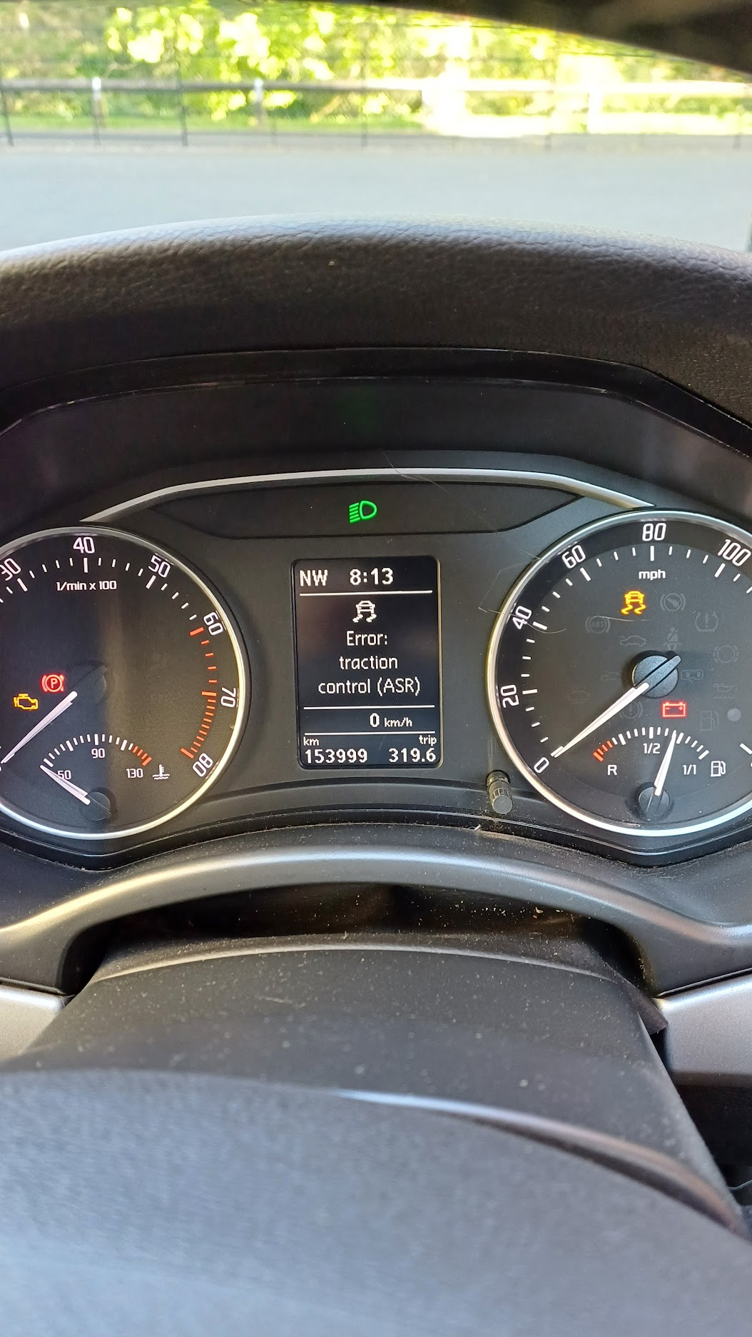

  10. Request for advice: ASR Error when starting in the morning. I have an Octavia SE TSI 1.4 MkII 2012 that often gets an ASR Error when I turn the ignition to start, mostly on a cold morning, below 4C. The engine does not start while the ASR lamp is on. It take a few tries to clear the error and the solution is never consistent and includes, remove the ignition key, replacing it, releasing the handbrake, putting a foot on the brake pedal. Simulating a full lock and unlocking of the vehicle. Or any combination of those. Once the started there are no issues and the vehicle starts fine during the day. My guess is it may be related to a sensor that feeds the ASR control. Or perhaps a mechanic issue on the handbrake or brakes. Has anyone had this and provide some tips for determining the root cause? Regards Jeremy
