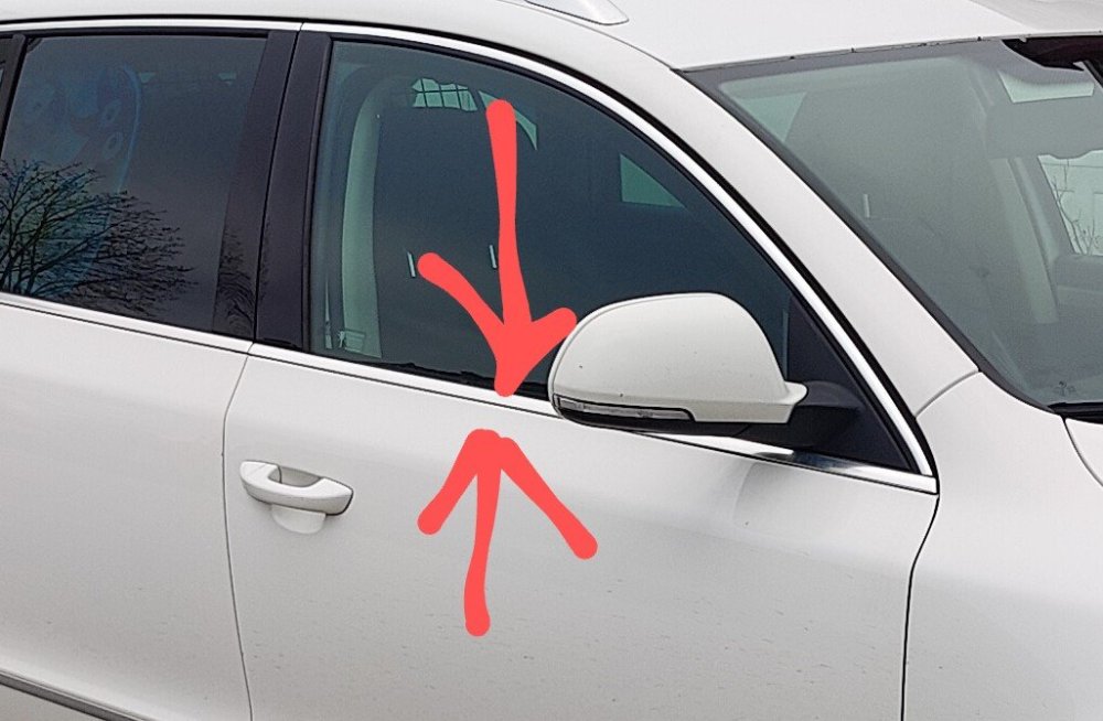

  1. Yeah, I bought new ones and changed them in 30min, pry with a plastic butter knife or something, or buy specialized tool but for one change it seemed unnecessary in my case. Found them on http://skoda-parts.com/ 3T0 837 475 A 3T9 839 475 3T9 839 476 3T0 837 476 A But make sure they fit your model of course
  2. Im looking to replace this trim/window seal. I know its a combined part, unfortunately. The seal is dried up and starts to crumble and streak the windows. But I can't find replacement parts anywhere! Does anybody know? Part number or link to store would be much appreciated!
  3. Easy to remove trim and seal, but I don't know the part number and where to find it, could anyone help? Superb mk2
