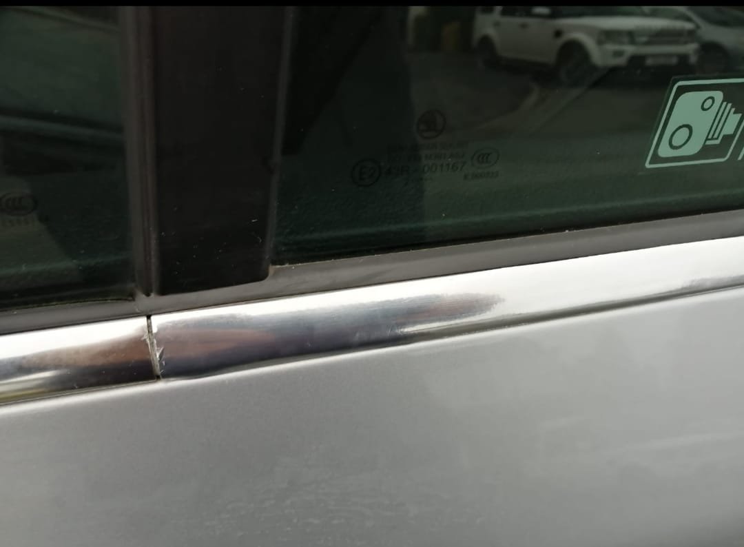

Not only an issue on the Superb.
This affects all Skoda trim, and the trim from many other manufacturers too.
It is mostly caused by cheap acidic chemicals (TFR - Traffic Film Remover, often referred to as truck wash) used by the £6 hand car wash outfits. Use them at your peril.

On 05/11/2019 at 17:46, lichfielddriver said:
I need to fix it paint it or hide it to pass a council taxi test...
quick fix, assuming you're where your username suggests?....pop down to Hexis nr Tippers Builders merchants and get some Silver Vinyl, cut into strips and cover up, trim with a sharp blade along the edges but not too near the paint work at a 45deg angle.
dangerous i know but if you get stuck.....PM me
actually found some chrome wrap sticky stuff that is an almost perfect match £3
but thanks for the "Tip"

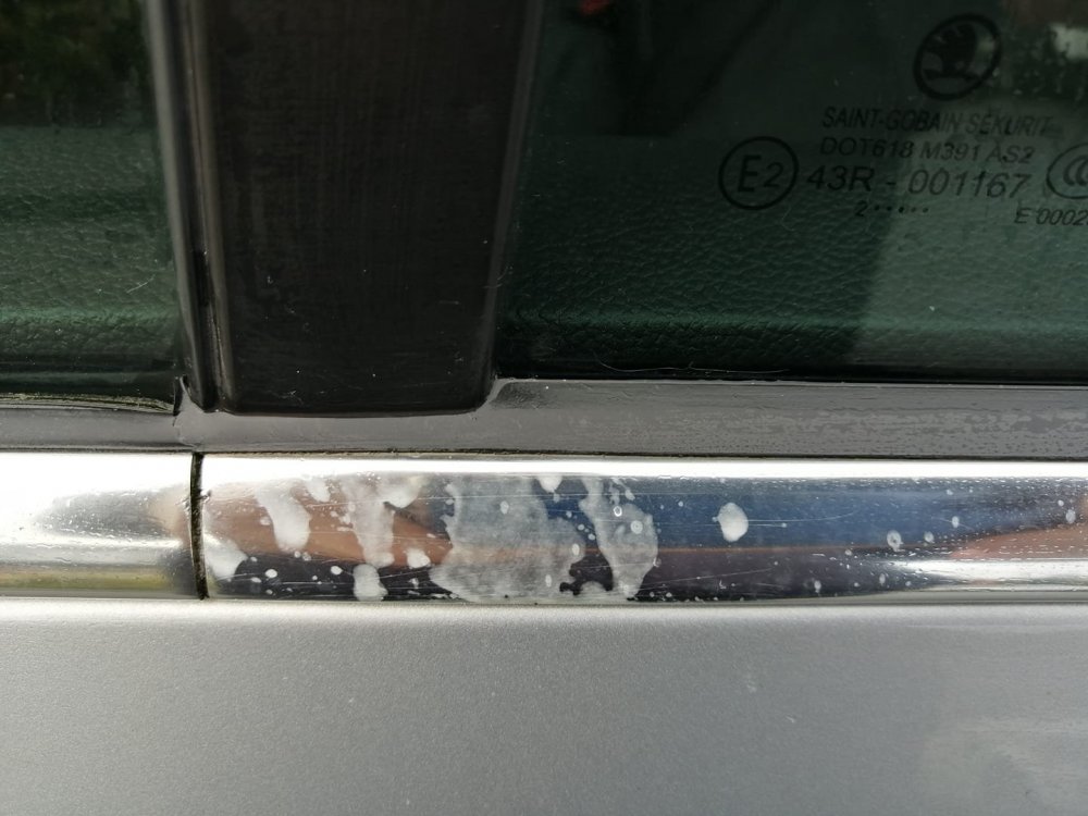

just had a quick go at the 'ghetto' fix....too cold for a proper go 😃
my trim isn't quite as bad as some but generally milky all over including the roof rails. bit of Silver vinyl from the cupboard.......
long term i'm erring towards Black for the windows and possibly Silver around the rear/front chrome trims.

On 05/11/2019 at 22:08, silver1011 said:
Tainted chrome trim is a genuine cause to fail a council taxi test!? 😮
This is not chrome trim, it is plastic chrome effect trim so that should be a way out of it, I tried to claim it on my warranty but Skoda came back and said as it was trim and not part of the body it wasn't covered after 1 year, pay over £32K for a car and the trim is not covered !!!!!!
