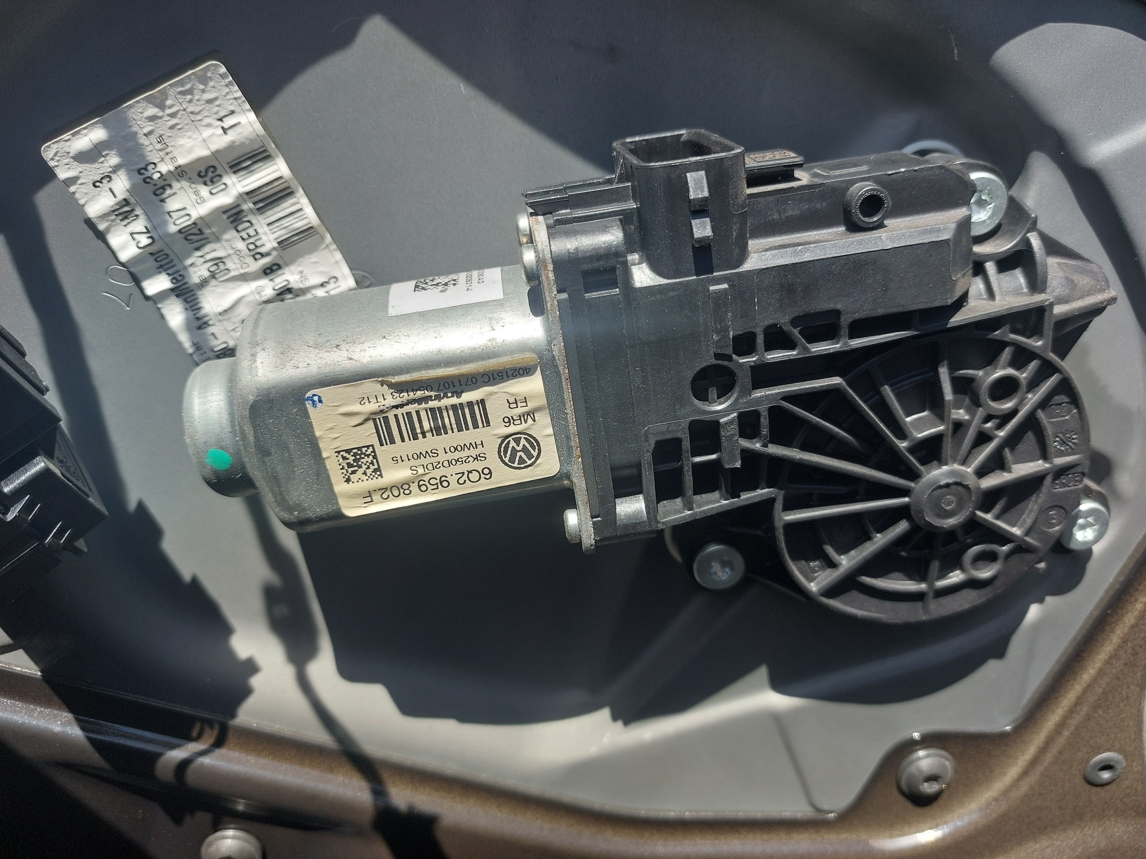

  1. Hi! I found a 6Q2959802G. I installed it and both windows work again! Thanks a los for supporting. Very useful. BR
  2. Thanks a lot for the advise!!
  3. Thanks a lot for your support!! Very usefull! I am having problems to find the same reference 6Q2959802F... and I think I can try to find other 6Q2959802 - (F,G,H,J)! I found this one but the provider told me that there is no reference in the piece. It seems the same I have... But not sure if it can be a different part number from the four above mentioned... this is why I saked about the QR code. This is for one Skoda Fabia III Combi 1.0 2014.... what do you think? Thanks a lot!!
  4. Thanks for the reply! Very clear! So I'm worse case I do it find same reference 6Q2959802F the best choice is 6Q2959802H that would need only connector adaptation, right? Second question... is it possible to identify the reference without label? There is any link between the reference number 6Q295... and the QR code? Thanks a lot!!!
  5. I see there are different type of window motor in the Skoda. Also, the one with this reference 6Q2959802 has three different letters: 6Q2959802A, 6Q2959802F and 6Q2959802J... Do 6ou know what is the difference between them? Are they compatible? Thanks!!
  6. Hi! I have exaclty same problem... windows worked randomly. When I removed battery and put it again it start to work again. Now when I remove battery... nothing work! I removed the motor in the driver side (6Q2959802F) and when I remove battery and put it again the passanger windows work for 10 minutes ONLY. If I trun the car on, the time is not extended... If during the 10 min period (with the passanger windows working) I connect the driver windows motor, the passanger windows doesn't work anymore... this make me think the problem is in this unit: 6Q2.959.802.F... Thanks for your comments!!
