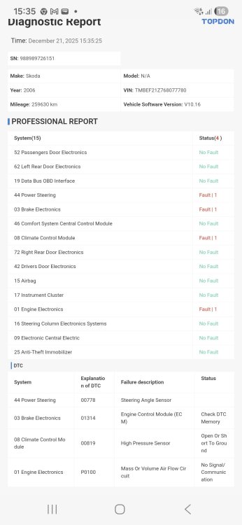

  3. Right update: Changed sterring angle sensor and also abs sensor again, still have the abs sensor pass front coming on now 2 being faulty i can't see happening .. steering angle sensor is not coming up with degrees on old part or new calibration manual and through obdII have been done light doesnt come off... This code for 01314 seems to be the main issue that is stopping me from clearing dtcs I have had a look over the wiring and can't see anything out of the ordinary contact cleaner on all pins and push fits im just really at a lost end ... I brought the car cheap with the faults on dash and alternator not charging battery so changed the alternator and sorted the power issue its just this now ... I don't have vcds and I know garages will replace everything and be like didnt work here's your bill sorry can't help ... If I cannot fix I will be parting the car out if anyone needs parts

  5. Hi there, I have have a weird issue with me vrs octavia 2006 ... To start it has lights on the dash abs traction control steering wheel (amber) and tire pressure warning light ... Used top don diagnostics bt800 comes up : Abs front nearside Steering angle sensor Ecm 03 brakes 01314 The 3 codes that I cannot seem to shift I have replaced abs sensor and checked the pickup in hub and all is fine cleared code drive 2 ft comes back on .. Changed steering angle sensor after calibration failed recalibrated new sensor can't clean .. Ecm 03 brakes 01314 not sure if this is the main issues does anyone have a soliyltion or had this issue before ? Any help will be appreciated Codes listed below Abs isn't on there as tried to clear codes and didnt drive but its there !
