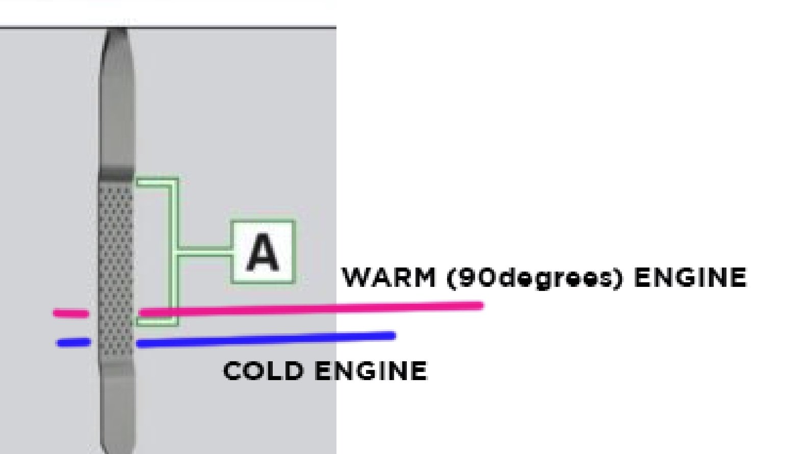

  19. Yes, it is very hard to read the oil level - I need to stare like an idiot to see the level but I am 99% sure it is where I pointed on the picture above. That doesn't answer the question - where it is gone? I will leave the car on Monday for the repairs and ask the mechanic what to do also. My old Kia that is 300000km doesn't touch a single mm of oil. Strange... Might be OCD, might be real problem, no idea.
  20. Update, check picture for measuring my levels. No warning lights, no oil smell, no blue smoke, no nothing. Should I top up or wait for the light?
  21. Thanks for the reply. Now the oil level is at the bottom end of B based on your diagram. I check it only on cold engine. I have never checked it on hot/operating temperature engine. Do I do it correctly? Do I need to top up now or wait for the light? If no light comes so it doesn't burn oil?
