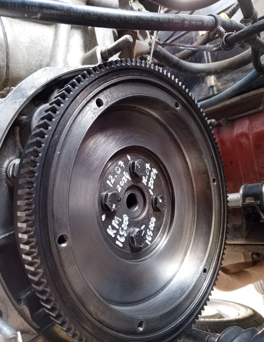

Today I had my vehicle's own flywheel turned to 0.8 mm on the lathe, and in the same way the contact surface of the pressure plate was turned to 0.8. The craftsman who did the lathe made the measurement and decided to take 0.8 mm. I currently have a second-hand flywheel on my vehicle, I will reattach my own flywheel as soon as possible, I will share the developments here.

You may have said it was damaged because it looks a little shiny, but there is no wear and tear, it is smooth.

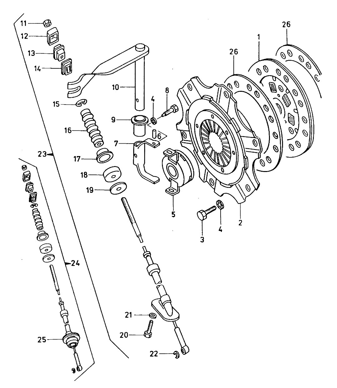

There is no adjustment mechanism on the fork. When the bearing is not installed, it slides down a little as in the photo, but when it is installed on the bearing, it aligns anyway. When you check it in neutral without installing the gearbox, the bearing moves easily onto the socket pole shaft without getting stuck at all.

clutch release system as seen in the picture, after installing everything, when I move the iron to which the rope is attached with my hand, I feel that the bearing is in contact with the pressure spring, when I install the rope in its place, I only tighten it to close the gap, I do not do extra tension

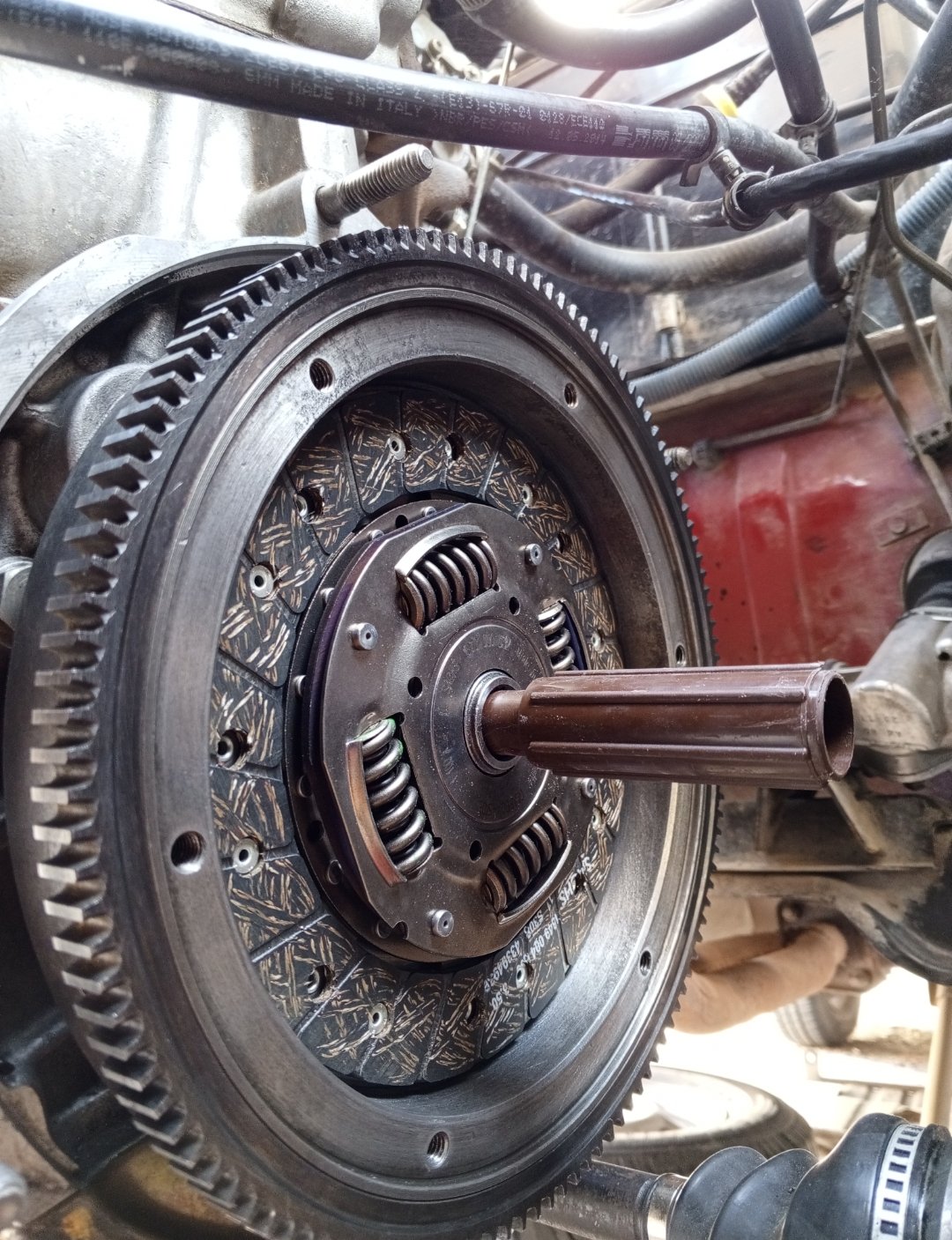

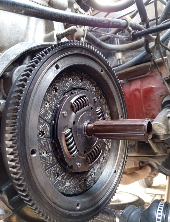

Hello, I installed the new clutch pad set and now I went on a long journey. I traveled 1200 km. The clutch slips again while driving. 1.2. The gears accelerate without shifting unless the road is too steep. 3.4.5. In gears, it slips when you give sudden gas on slight hills, but when you press the gas pedal slowly, the slip decreases. When I first set out on the road, I was hoping that the brake pad would get used to the flywheel after 1200 km, but it did not happen. I hope the pad gets used to the flywheel on the return of the same road. By the way, there is a situation that I cannot understand, for example, when going downhill in 5th gear without pressing the accelerator pedal, the revs go up to 5000-6000, with a slight touch of the accelerator pedal, it reaches 3000 revs, while it continues like this for a while, the revs go up to 5000-6000 again, by pressing the brake, the revs decrease. I want to see it, but it doesn't decrease proportionally with the braking, it decreases very late. I wonder if I should look for the clutch slipping somewhere else. I think there might be a problem in the gearbox. I can't find out how the gearbox could cause this. As I mentioned above, when going downhill, I think the increase in speed may be due to the ignition system malfunction, but in normal driving, everything is normal. I hope I can get a solution as soon as possible.
New clutch slipping
The new clutch was sold as a set and the code on it confirms that it belongs to this vehicle. There is no way to install the friction disc upside down, I tried it, the middle protrusion part touches the flywheel bolts and you cannot replace the pressure plate in this way, it is immediately obvious that something is wrong. I am about to receive the Sacsh brand clutch set. I will replace all of them again this weekend. The friction disc, pressure plate and pressure bearing. I hope it will not slip this time. I have a travel plan of approximately 2500 km. If it slips, I have to go uphill in 1st and 2nd gear. Fuel consumption also increases considerably.

It is just a cable that allows adjusting the pedal gap. As I tighten the screw on it, the release bearing starts to come into tighter contact with the diaphragm spring. I just let it touch and stop tightening the screw when the gap runs out.
