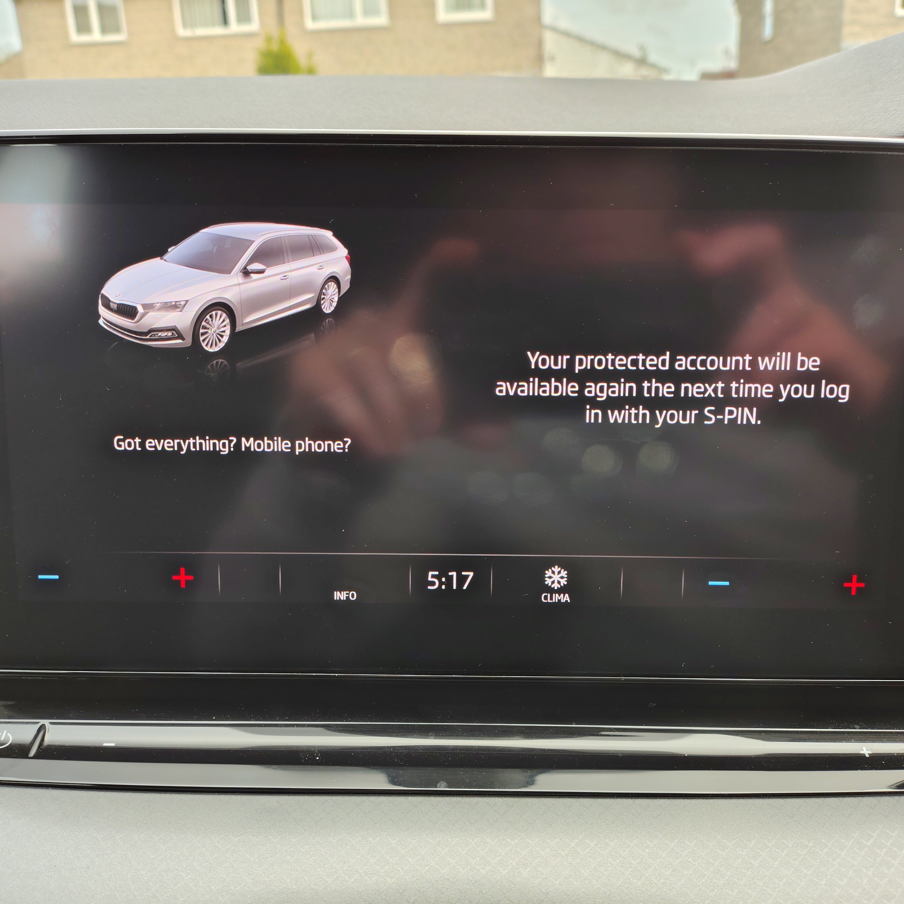

  1. Hi, many thanks for the reply and suggestion. I found the fix to my particular issue however. Some more internet digging threw up my issue as a common problem and it was resolved by removing fuse No.19 from behind the glovebox and waiting a couple of minutes. This forced a hard reboot of the infotainment and SOS telemetrics and sorted the issue. It appears that the two systems sometimes lose connection with eachother and looks like the car can't download your profile from the servers. Thanks again for your suggestion though, much appreciated 👍
  2. Thanks for the suggestion. I've subsequently found (by accident!), that when you turn the ignition off I can access all the normal menus, but as soon as the ignition is turned on, it's back to the 'loading setting' screen. I did some more digging on the internet and it does seem to be a common issue to do with the head unit not communicating with the SOS module and I'm guessing therefore the internet/Skoda servers. Many find that removing the fuse No.19 for a bit does a proper hard boot and often resorted the connection. Others do as you've suggested and disconnect the battery to achieve the same thing. I'll give it a go later tomorrow and report back!
  3. I've got a 1.0 TSI Technology and it's had the recent system update which went Ok, with the exception of having to reset the users etc. and has been fine since that was done a couple of weeks ago. Today I started the system and it started to boot up with the usual 'Loading Settings' and spinning wheel. That normally only takes a few seconds but this went on for the whole 30 min journey to work. The same thing on the way home too, despite several reboots by holding the button down for 10 secs. The Climate control works, as do the parking sensor displays and I can turn off the bloody annoying Lane Control and Start/Stop system but no radio, navigation or any other menus! When switching off I get the message attached? I tried my wife's key when I got home and had exactly the same issues. Has anyone had similar and found a cure or is it just a glitch with the Skoda servers? It's way out of warranty now and I'm extremely reluctant to pay main steeler prices and then have them shrug and say I need a new system.
