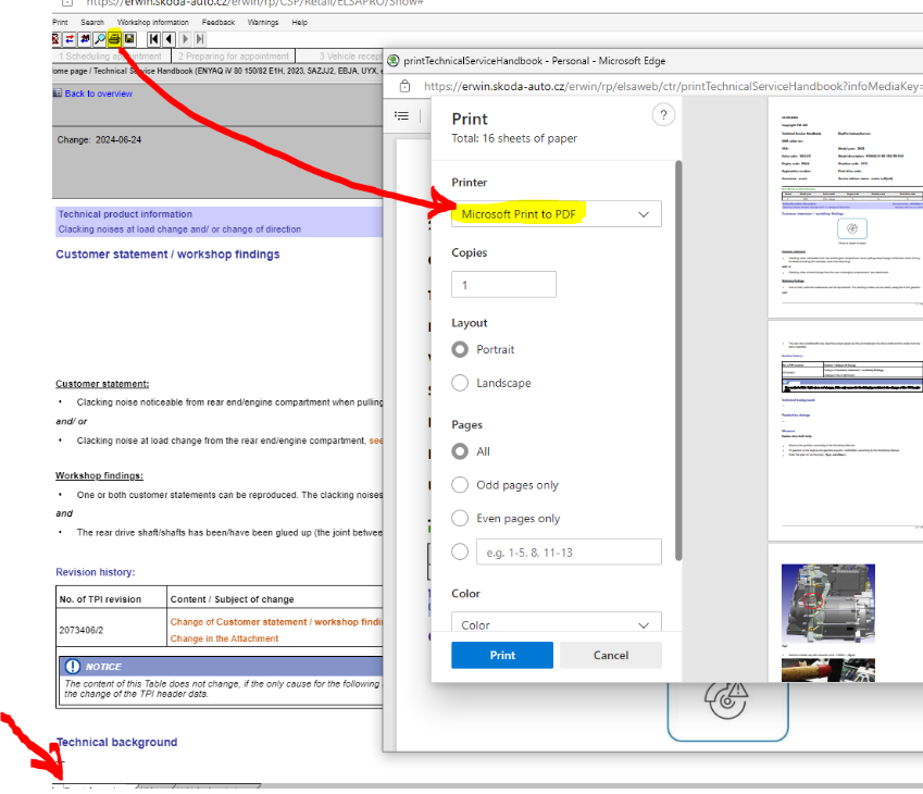

  1. For some stupid reason I can no longer edit my last post (fix this forum admin). Sorry for the double screenshot in the bottom of the post and maybe some spelling errors 🙂

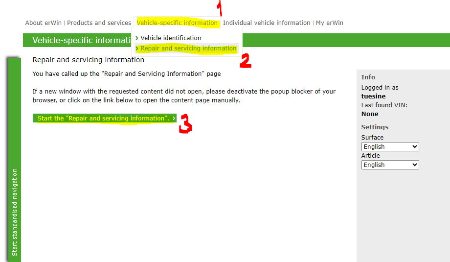

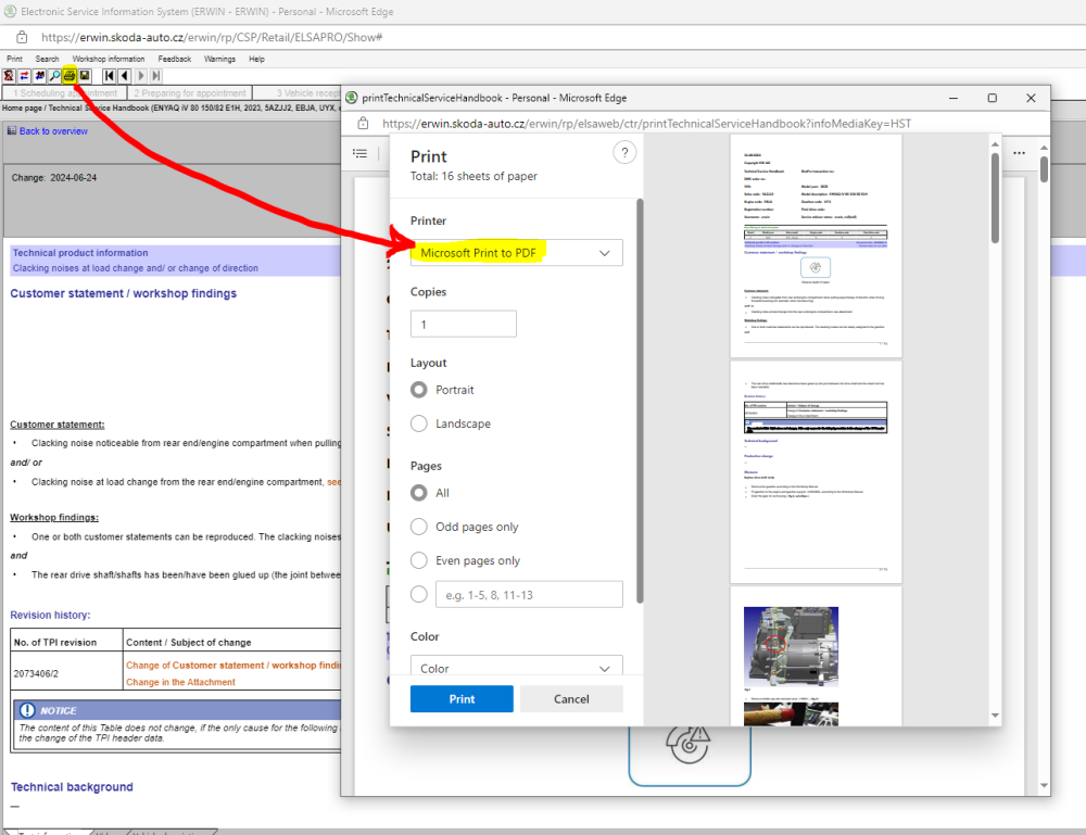

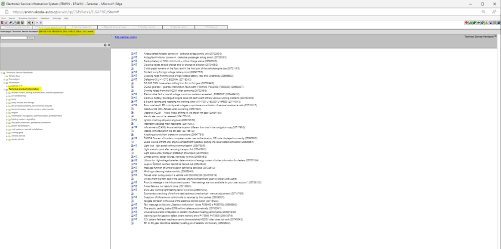

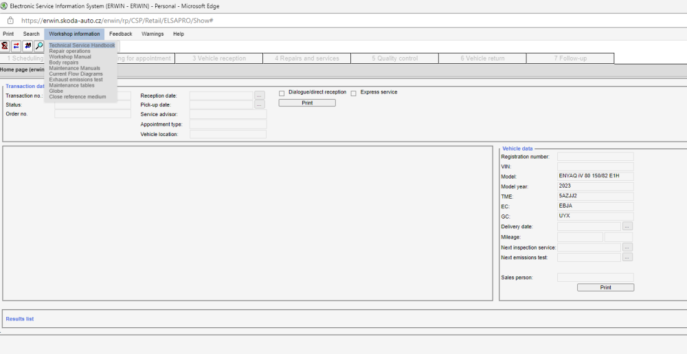

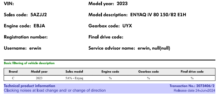

  2. LOL I see that it has been 6 years since Rybu79 wrote last time, so he is probably not going to reply to my posts 😀 Anyway someone might find this useful. I finally found all TPI's related to my Skoda ENYAQ iV 80 (2023) using erWin. The TPI title related to my specific problem is: Clacking noises at load changes and/or change of direction Transaction No: 2073406/2 There is even a video illustrating the problem (clicking/clacking noise). I will not post either PDF or video because of the copyrights, so if you want to read the TPI and watch the video, you are going to have to pay for at least an hour on erWin. Sorry 😉 It's really hard to figure out how to download the TPI's but watching a Czech video tutorial i finally figured out how it works. From erWin (using Microsoft Edge browser) you can open another online app from where the TPI's are available. Note: You have to enter your vehicle VIN or car make and mode before doing so. From that app you click "Technical Service Handbook" in the "Workshop information" drop-down as shown below. You can then see all the TPI's related to your specific vehicle Remember to select the right tab in the bottom of the window. One shows just some additional information and one shows the actual TPI. Note also that some of the TPI's have a video tab and some an attachment tab (sorry for the screenshot below. You can just make out that there is a tab bar at the bottom of the image).

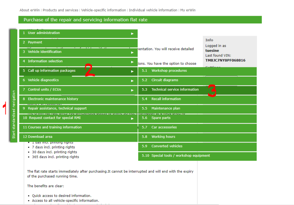

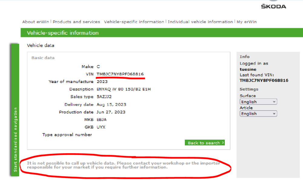

  3. Nice that you found TPI's, but I have now spent €7.00 and found repair manuals etc. but where do I find the TPI's? When I enter my VIN I get the message "Not possible to call up vehicle data ..." (see screenshot), so I have to enter the car make manually (maybe this is why I do not get any TPI's). From other forums I know that there should be at least one TPI regarding the problem I see on my car, and next week my car is going to the workshop, so I would REALLY like to find the related TPI before handing over my car. Please help. From the attached screenshot you can see that I try to search for TPI's under the "Technical Service Information", and I have tried just about everything else, but no TPI's found. Can you please show/tell me exactly where you downloaded the TPI's? Thanks 🙂
