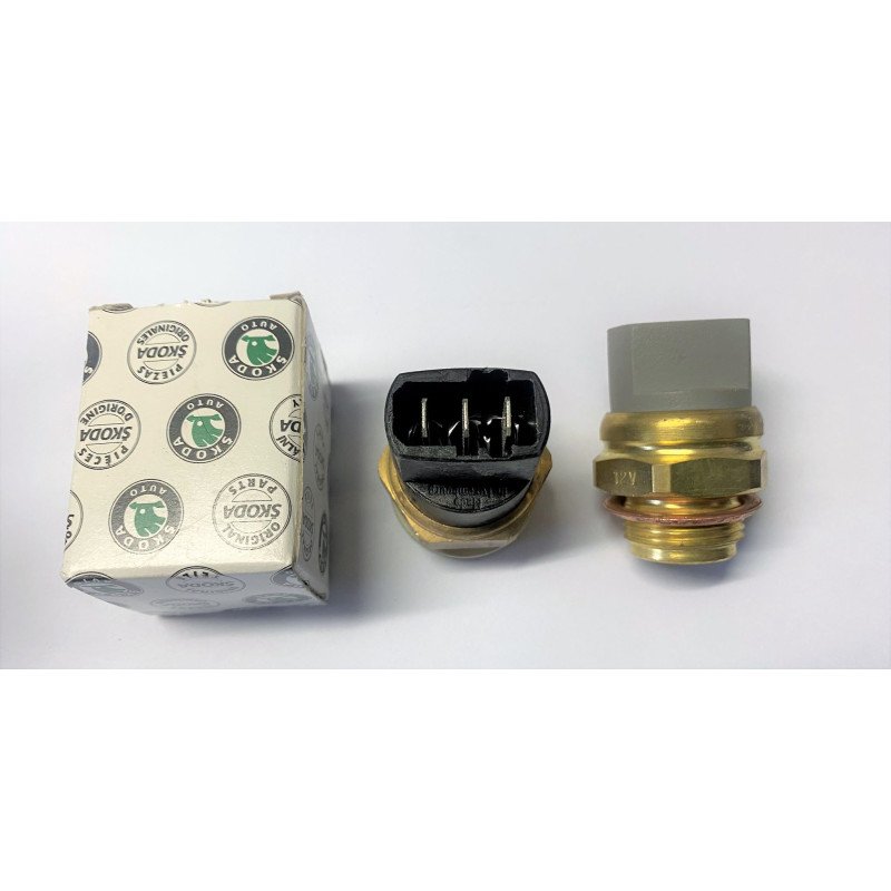

  6. Yup, so I just checked it, and the 3-pin thermoswitch in the Å koda branded box (presumably Wahler then according to the book I mentioned) indeed does include a very nice copper washer.
  7. Many thanks for this heads up, @D.FYLAKTOS, I think there might've been a copper washer in the original set for the 3-pin. I'll check the box though, and if it is not, I'll make sure to order the right one. The fairly detailed Czech book by Mario René Cedrych that I have checked states, that unlike the 2-pin variants, which were truly made by Metra Šumperk, the 3-pin version was supposedly manufactured in Germany by Wahler (it did look and feel very high quality as well, which caught me by surprise when I got it). As for the wiring, I'll take a good look on the donor car when we'll be disassembling the unit and related parts, and of course document everything carefully with pictures so that there's a much smaller chance of messing up during the reassembly. I might initially reuse the fan from that car just to make sure that everything's fine, and replace it later on in the process of fine tuning everything. Perhaps while trying the intelligent fan wiring setup proposed by @Thefeliciahacker.

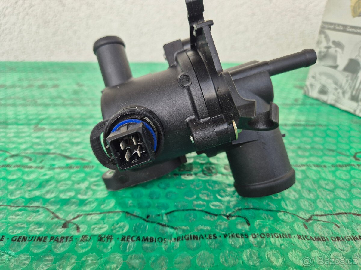

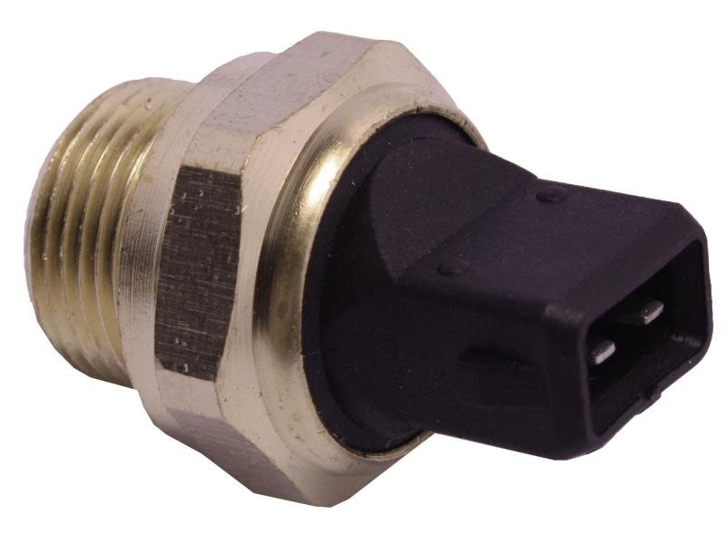

  8. Hello, guys, wishing you all a nice day, once again, I would first like to thank each and every one of you for all of the feedback provided for the topic of this post so far. It's been immensely valuable and insightful for me. I wanted to ask you all about one more thing I'm not entirely sure about, which would be the thermoswitch for the fan. Now, at the moment, I do know that there were at least 2 different types of the 2-pin switch, each one tuned for a different climate that the car is to be driven in. At the moment, on my car, I have a brand new original one with the higher activation temperature of about 95°C on the temperature sensor, and the car's been running just fine with it. You can see that one in the 1st attached picture. However, from what I know, all original air conditioner equipped cars (and diesel-engined Felicias for that matter) got an entirely different, 3-pin variant (please see the 2nd attached picture), presumably because of the 2-step fan activation. I actually have a brand new original one in that version available for my car as well. But the official Alex installation manual does not mention that the switch would need to be changed, and as it was designed to be installed by a dealer on an originally non-A/C car, I presume, that the wiring there may still be designed for the 2-pin switch. As such, my question is, which one of the two general types is compatible with the wiring of the Alex A/C unit. Again, thank you all very much.
  9. Okay, that makes sense, I'll try the original Å koda blue thermostat, and we'll see how she'll run when that one's on there. If it's not ideal for me, going back to the yellow one is always possible anyway. Thank you all for the insight.
  10. Very well, then, since there's an actual difference, I'll try to source that blue original one. The non-original thermostat housing on my car is starting to sweat ever so slightly from the outside anyway, so that part is definitely due for a change very soon, and the A/C installation process might be a really good chance to proceed with it. Thank you very much for this valuable piece of info.

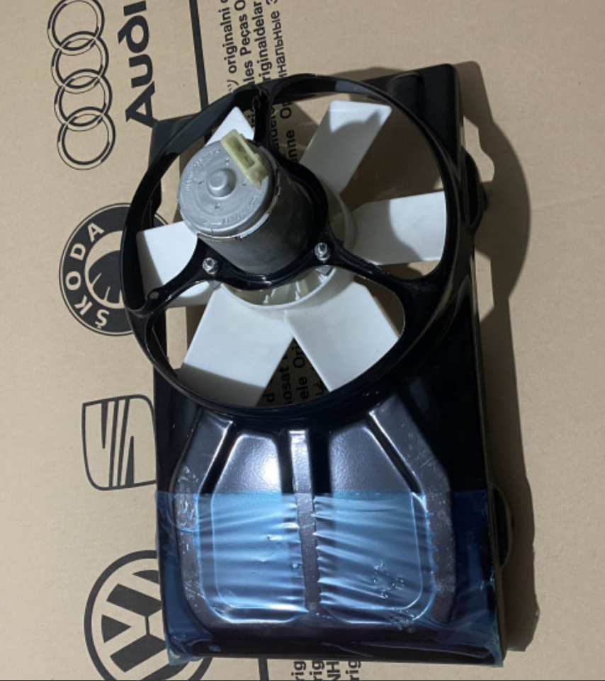

  12. According to a quick research of these 2 part numbers, it would seem that there is a mistake in the description of the 2 fans. The "0130107262" seems to be the OEM non A/C, 2-pin variant (no middle pin) used by Å koda for warm climate Felicia models. The "0130109237" should be the dual-speed, 3-pin variant used with A/C equipped cars. Both variants tend to come up when searching for one or the other, but this is what seems to be the case there.
  13. Thank you very much for the answers, guys. I really appreciate all the suggestions, as well as the extensive documentation provided by @Thefeliciahacker. That really will help a lot during the removal from the donor car. As the A/C will be going into the car at some point before next summer (probably at the end of the next winter season, I will give all of the details about the fan a good thought first, and get everything prepared with as much precision as possible. But seeing that I already have the nice OEM shroud and Autopal radiator, I will probably go with the "MAHLE CFF 7 000S" 150W/250W fan (in the picture), as that one should be sufficient for this use in our climate, and should fit the shroud that I have perfectly.

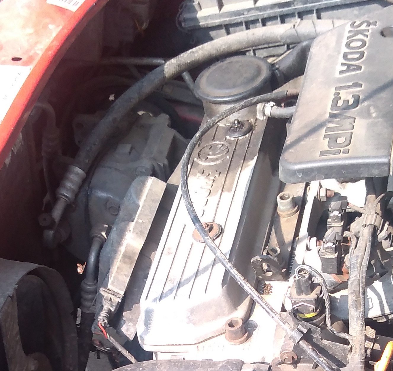

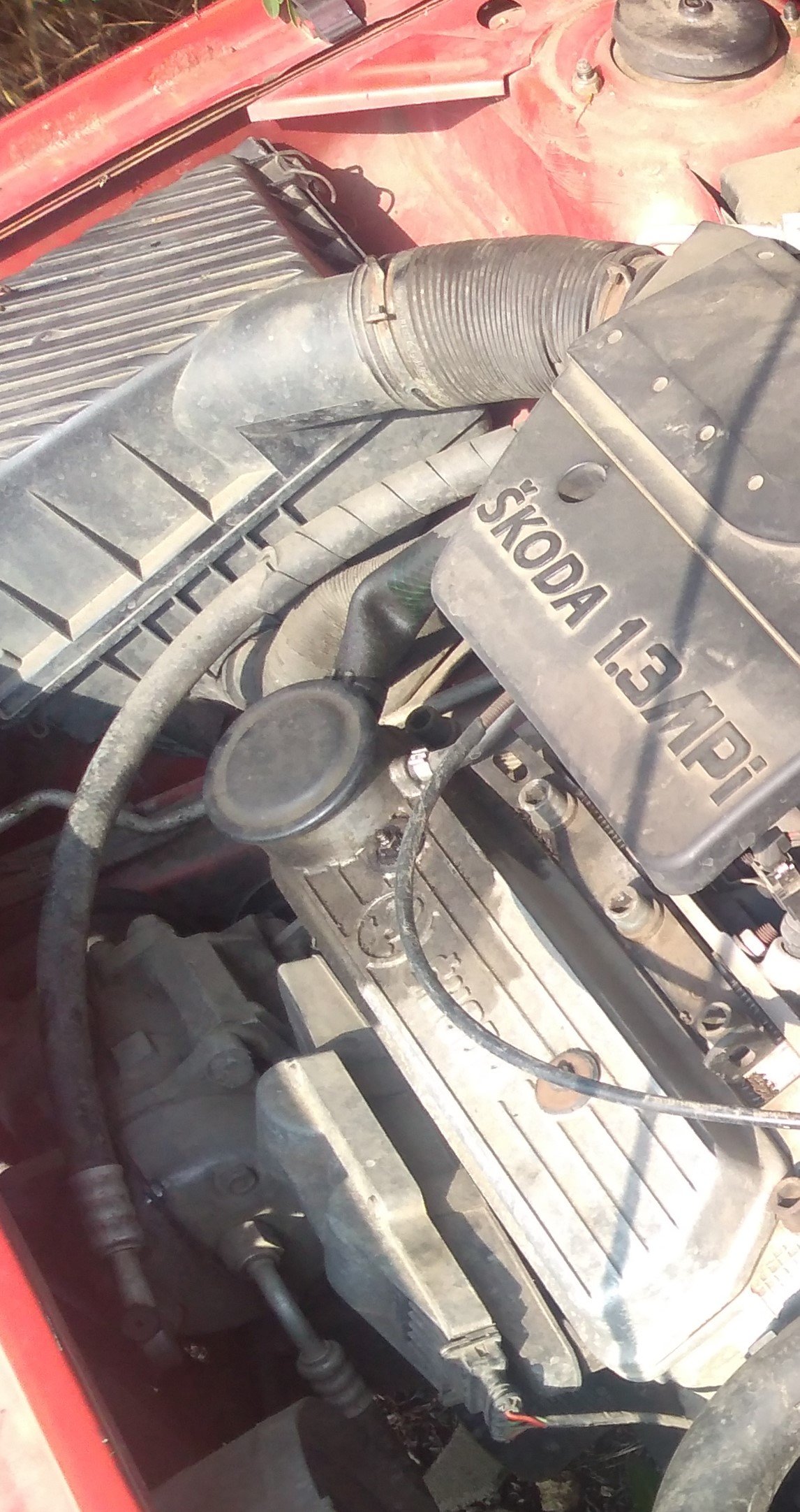

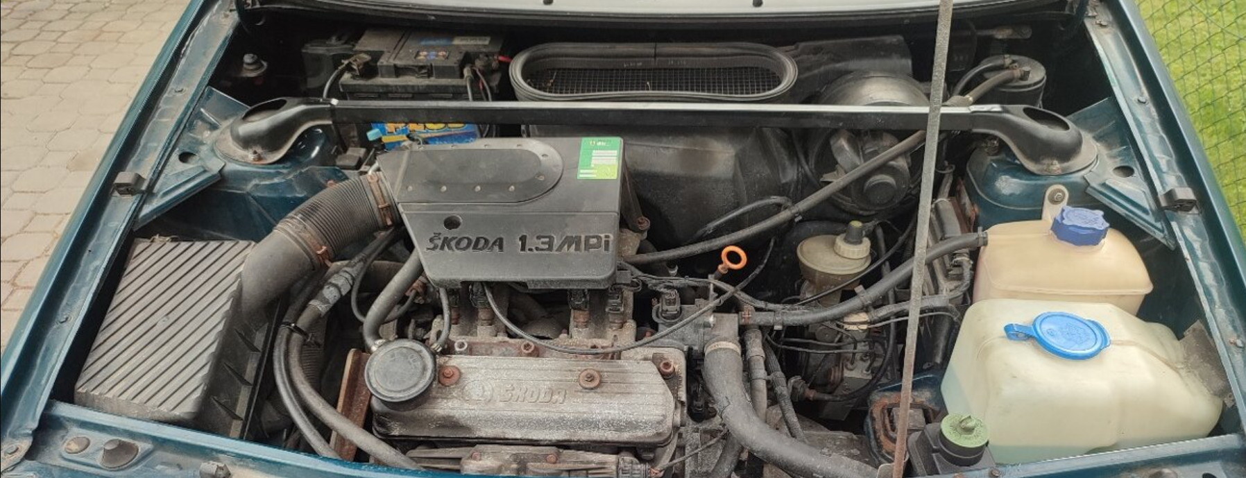

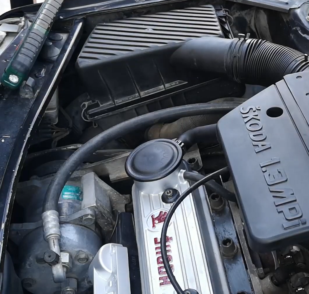

  14. Hello, everyone, I am currently in the process of purchasing an Alex air conditioner (which, if I am not mistaken, was an optional set offered by Škoda dealers back in the day). It is a complete working set for the 1.3 MPi engine, very much like the one you see on the car in the first 2 pictures below (although in seemingly better condition), with the only difference being that the version I am about to buy was most likely used for cars without power steering, as the donor car which it is currently in does not have it (just like mine). Which gets me to the biggest problem, as I am about to be removing the complete set from the donor car myself in the coming weeks. As such, I decided to ask all of you experienced enthusiasts out there. Do you have any tips or tricks that I should know before removing the system from the donor car and then installing it into my own Felicia? Or perhaps any original schematics for the Alex unit that I could use? I tried to look for such documents on various forums before, but it seems that the files are fairly hard to come by nowadays, and the schematics for the OEM A/C unit are of course unfortunately not very helpful in this case. 😔 And possibly one more question. Can this type of air conditioner work with the "warm climate" 2-pin fan (6U0 959 455C, probably identical to the 165 959 455S fan for the 1.6 engine), in the 3rd picture below) or the late model 3-pin fan (6U0 959 453B) which were supposedly used with the OEM unit? Or does the fan motor included with the set have a proprietary connector or any special characteristics? It may be different on the donor car for me of course (there's a very large fan with a thin motor and a simple circular shroud on that one, kind of similar to the 1.9D OEM fan, but with a simpler shroud), but I would like to know, which connector your radiator fan motor on the Alex unit uses, as I already own a brand new OEM fan shroud (also in the 3rd picture), as well as the OEM Autopal radiator (6U0 121 251C) for the A/C equipped model that the shroud mounts onto very nicely. Thank you all very much for your help. 😄
