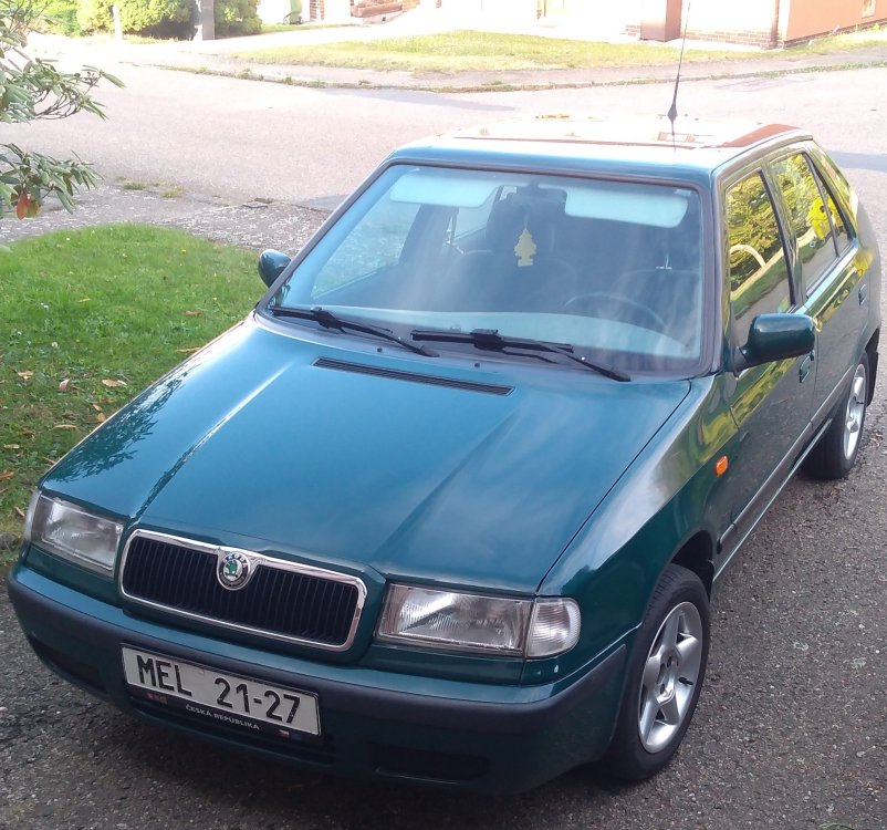

  15. Hello, everyone, let me extend my greetings to all of you, the wonderful members of this forum. My name is Ondra, I'm 23 years old and I come from the very home of most Å koda cars, the Central-Bohemian Region of the Czech Republic. My car is the one found in the attached picture, a petrol green 2001 Å koda Felicia LXi ("Trumf" edition), which is powered by the 781.136M engine (AKA 1.3 MPi 50kW / AMH). It's been nicknamed "Mel" because of the original license plate combination. I'm looking forward to learning something new from you all, as well as perhaps using some of my own knowledge to help some of you in return.
