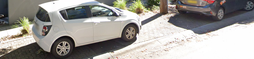

  3. Hello, Another question I have in relation to my recently purchased Superb. I have noticed that when I am trying to parallel park in a parking spot that is at a slight incline in reverse gear, I have to use the accelerator quite aggressively. I have attached an image showing the type of incline I am describing. It seems that if I try to go slow and precise, the car will not reverse. Obviously this is quite concerning as I am worried that I will use too much accelerator and potentially hit the car or object parked behind me. Is this normal behavior in a DSG equipped vehicle or is this something I should be concerned about? Thanks in advance.
