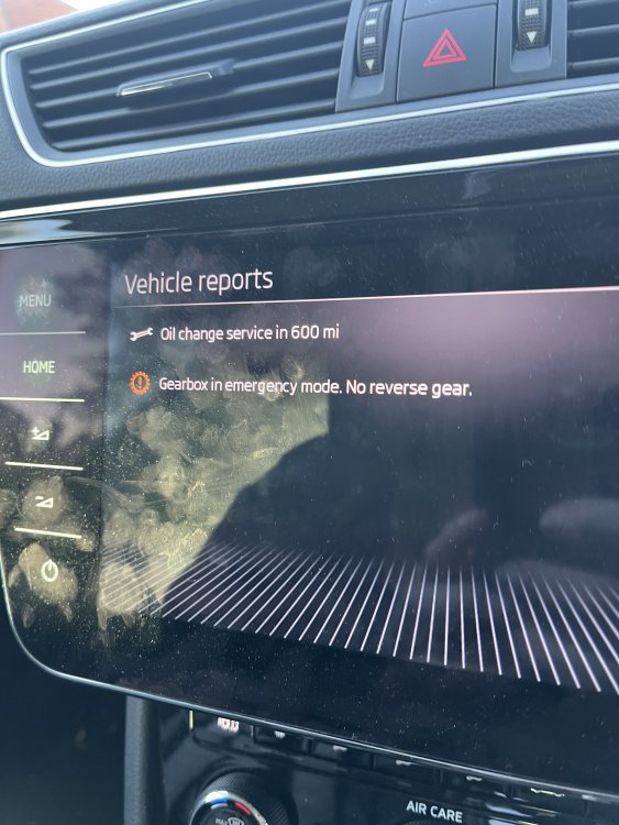

Hi all, 67 plate DSG7. Gpot to about 200 yards of being home and “gearbox in emergency mode: no reverse gear” flashed up, and at the same time “oil change service in 1200 miles”. Only appeared to have 1st gear, wouldn’t shift up but with only a short distance to home, it probably wouldn’t have gone above 2nd anyway. Switched off and left for 5 mins, switched back on and all ok again, with only the “service” message staying. A bit strange how both messages came on at the exact same time. Anyone had similar? Praying it’s just a glitch, but not confident for driving it too far now! Thanks

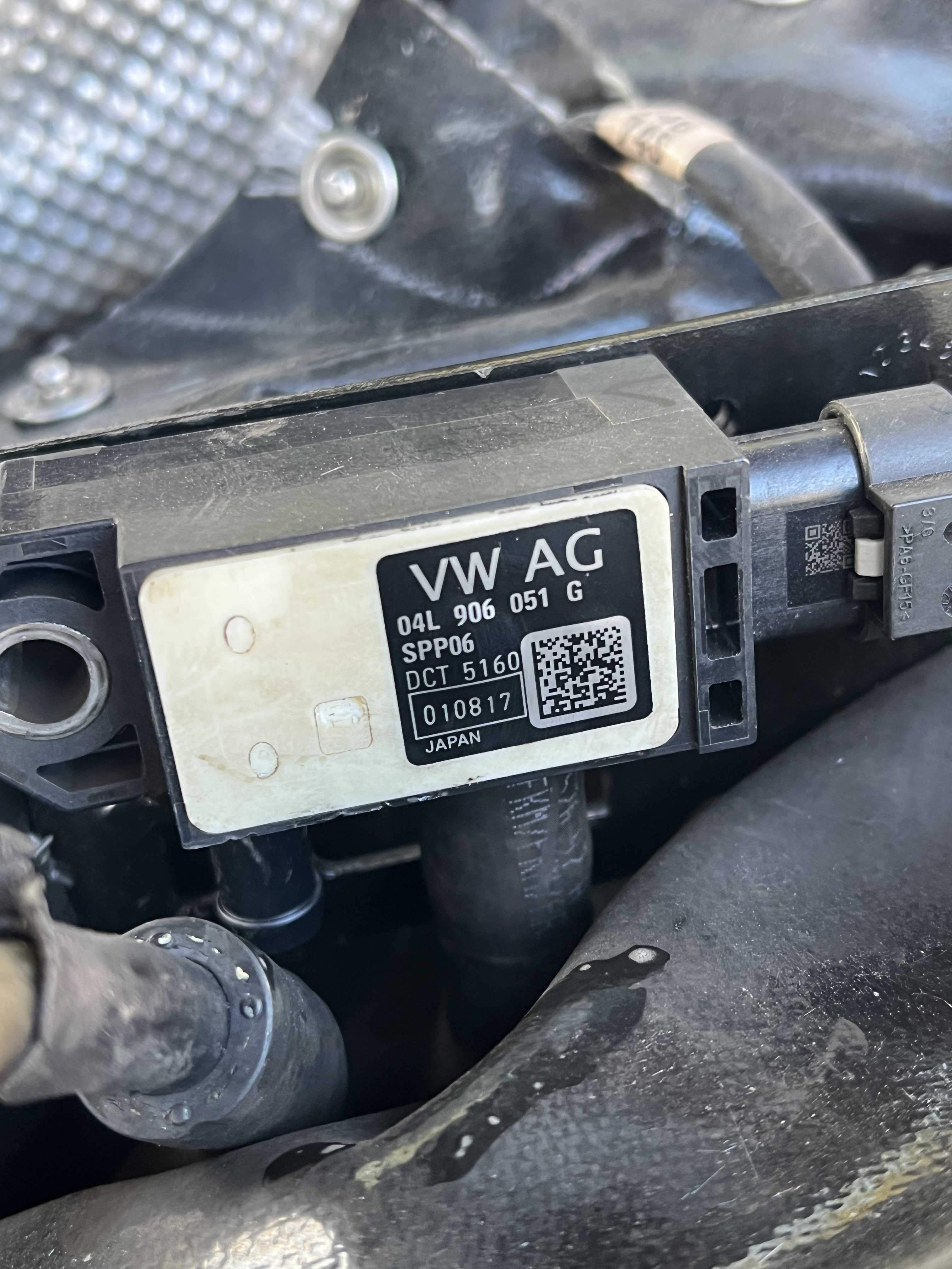

Hi all, Have a P2453 DPF sensor malfunction, and a P154B DPF sensor faulty on my 2.0 TDI Superb. Recently had a DPF clean and the technician confirmed the electrical reading and actual reading (pipe off) are loads different. DPF not knowing when to regenerate so starting to clog. Seeing as the part is easy to replace myself, does anyone in the Bristol area have VCDS or similar to adapt the new sensor. Willing to pay, but saving me a trip to a garage for extra ££! Thanks in advance!

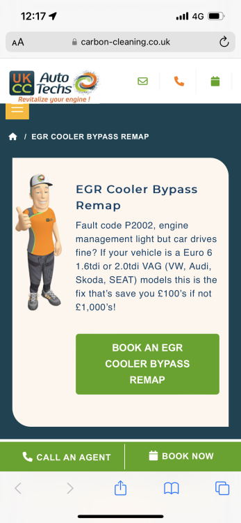

Thanks for the info. Do you have the egr cooler bypass remap?

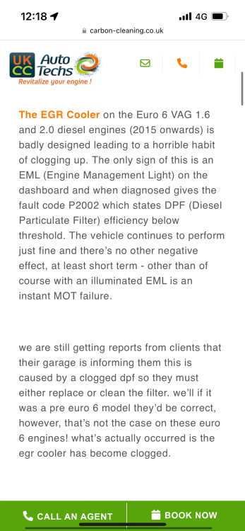

I don’t think it’s an EGR delete as the EGR isn’t being blanked off. From what I can tell, it’s just a remap that tells the ECU to ignore the temperature on the output of the EGR cooler. Just wondering if the higher temperature gases being passed through would cause a problem as they obviously aren’t being cooled enough.

Cool thanks. I came across this, anyone know if bypassing the egr cooler would cause any issues further down the line?
