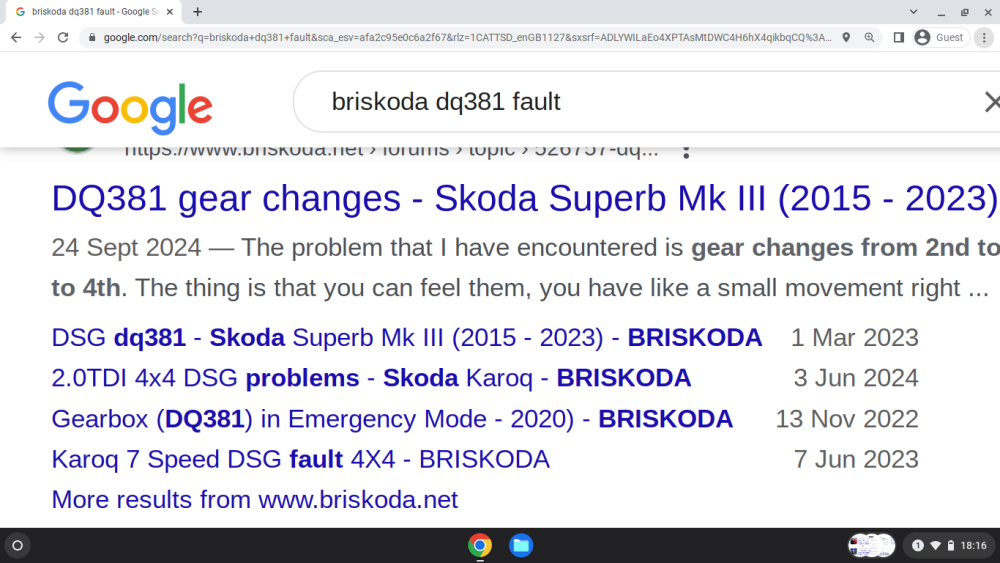

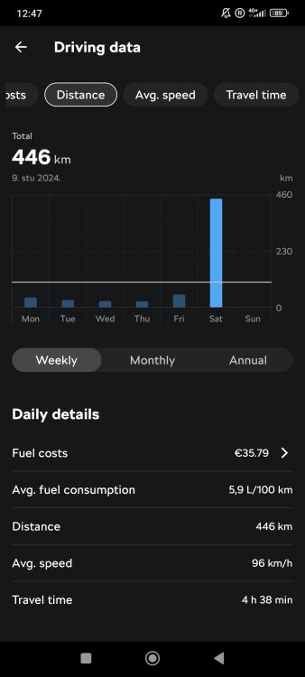

Still driving since then, without errors. Tomorrow will do 500km trip and report.
Done around 5000km since August when error randomly appeared.
The error came up once and hasn’t come back since?
Hit it few times that day until battery changed during the trip because was dead. Might be faulty mechatronic since it's well known problem, easly.
Without problems.
Update! Error is back! Time to repair mechatronic unit, one day went without problems today after 10 min of driving error came back, luckly I came home safe with manual changing..
