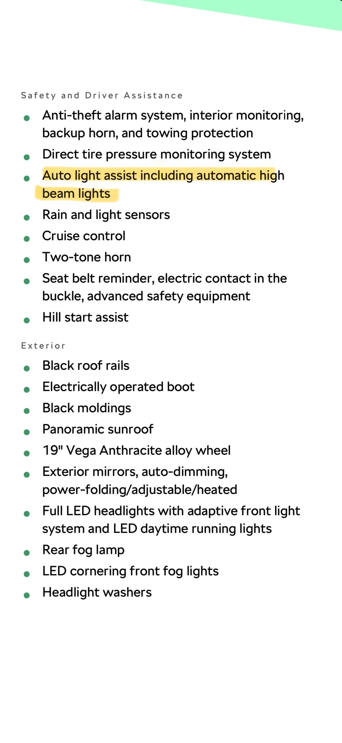

  1. I was looking at my digital certificate on the ŠKODA app and it specifies automatic high beam lights. Is this different to high beam assist? Yeah I’ve been quoted about £1200 for the work. That includes replacement windscreen and high beam assist, TSR and lane assist
  2. That’s for the info. I’ve been advised my sport line 2020 doesn’t have the camera in the windscreen so it would be a replacement windscreen with the camera fitted to have TSR and HBA retrofitted. I checked out Hazzydayz page but they’re quite a distance for me I’m based Cheshire. Found someone closer to me called East Yorkshire retrofits
