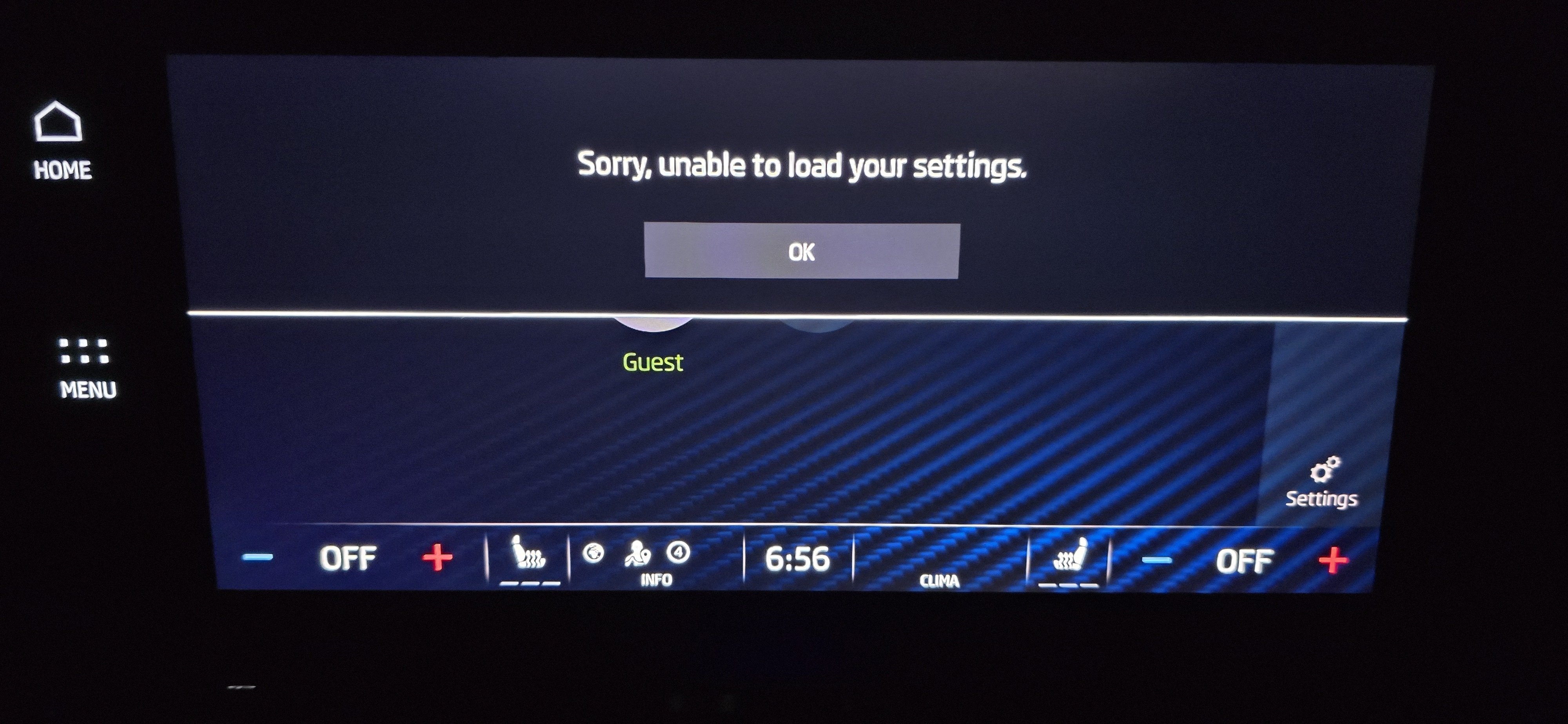

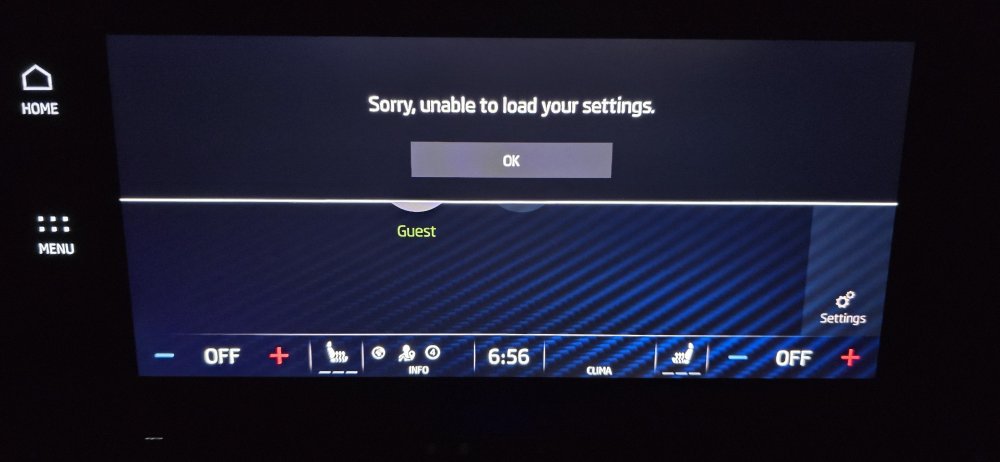

  10. **Update** I connected my car to my house wifi and....... nada, stiil the same message, 'sorry, unable to load your settings'! I tried a few times with the same result. Unfortunately I am not willing to pay £140 for Skoda to 'diagnose' the problem and then to charge me to re-code both my keys just so I can access my car through the app 🤷🏾‍♂️😔
  11. @campbell24 I will try the 'cheaper' option 1st of the home Wifi but as mine is out of warranty, god only nos how much they will charge for both keys to be recoded!! But thank you 😊
  12. Hi @Neily03 Brilliant, thank you 😊 Is the Wifi setting in one of the menus? I've not seen that anywhere yet. Just looked at the online manual and found it!! I'll try tonight, watch this space!! 🙌🏾
  13. Yo guys, I also have this issue on a 2020 mk4 VRS! I emailed Skoda Support and they suggested a factory reset on the infotainment system, uninstall the app, reinstall the app, delete my car, readd my car, stand on one leg, all of which did **** all! They then said book it in with a local Skoda dealer and let them know who it was and when it was and they would contact them to provide what needs to be done. My local Skoda dealer wants £140 to look at the issue before anything is done!!! As far as I can see, all my software is up to date bar my sat nav data base (19.7) I've had the car 10 weeks and I'm thinking that I dont need the extra cost to be a user/primary user if all it enables you to do is use the app and online shop 🤷🏾‍♂️
