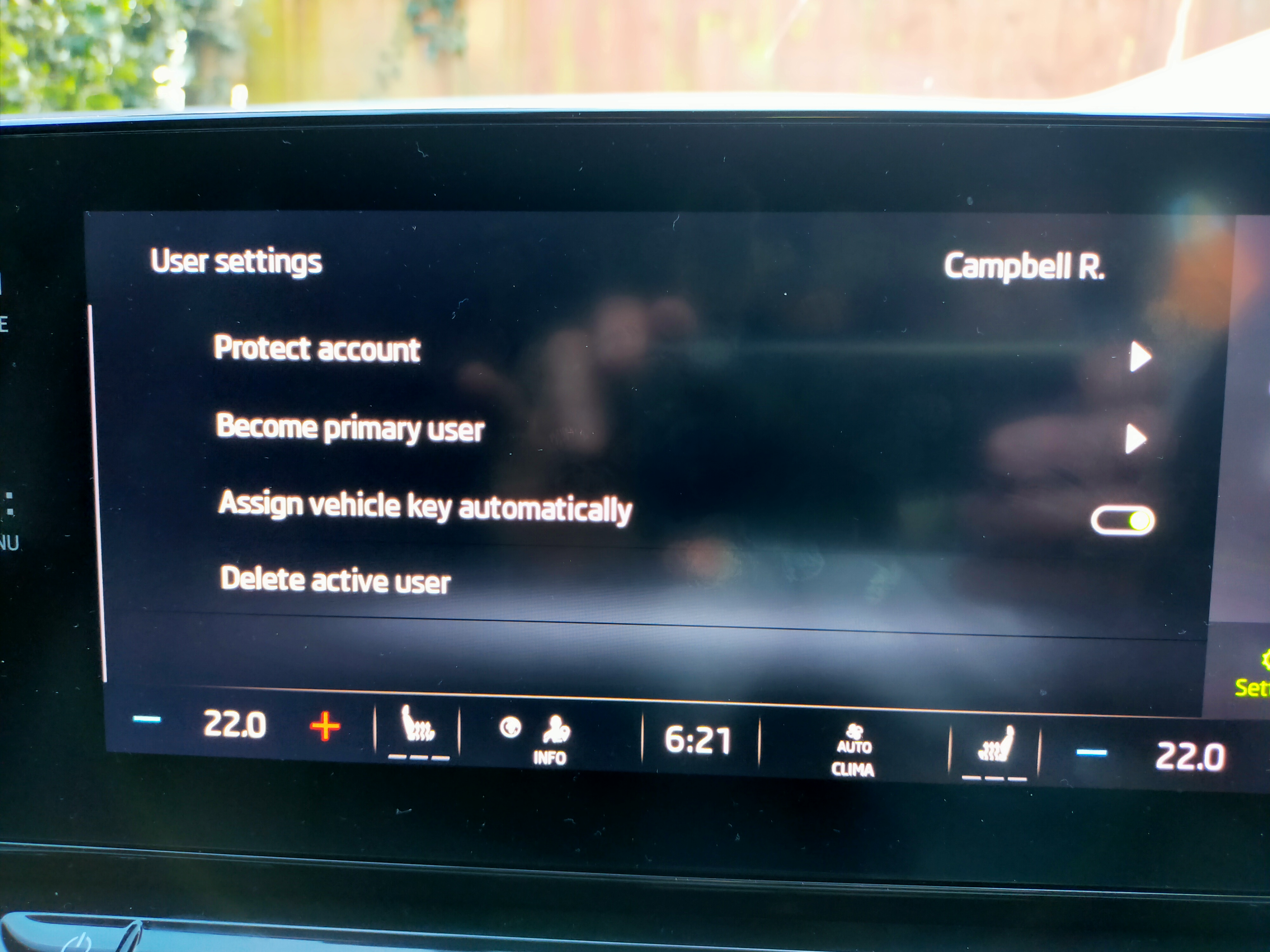

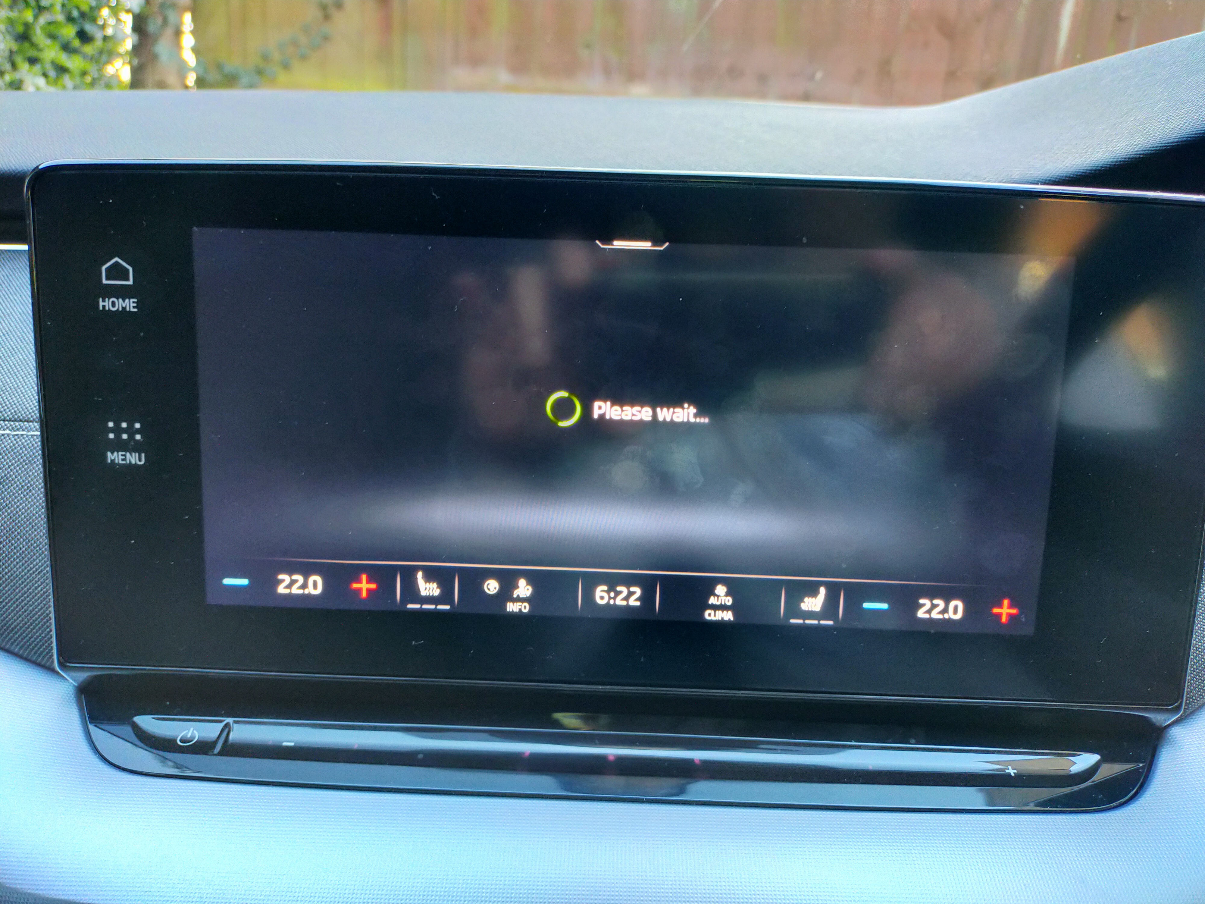

I have 1 2020 Octavia IV. I've downloaded and installed and registered the MYSkoda app. I'm recognised as a user on the infotainment screen having removed the previous owner as the primary user. I now need to set myself as the primary user  I need to verify myself as the primary user for the car. When I do this I just get the rotating green wheel for, even waiting 10 minutes so I seem to be stuck in an endless lop. I've tried reinstalling the app on my phone but no improvement. Any suggestions?

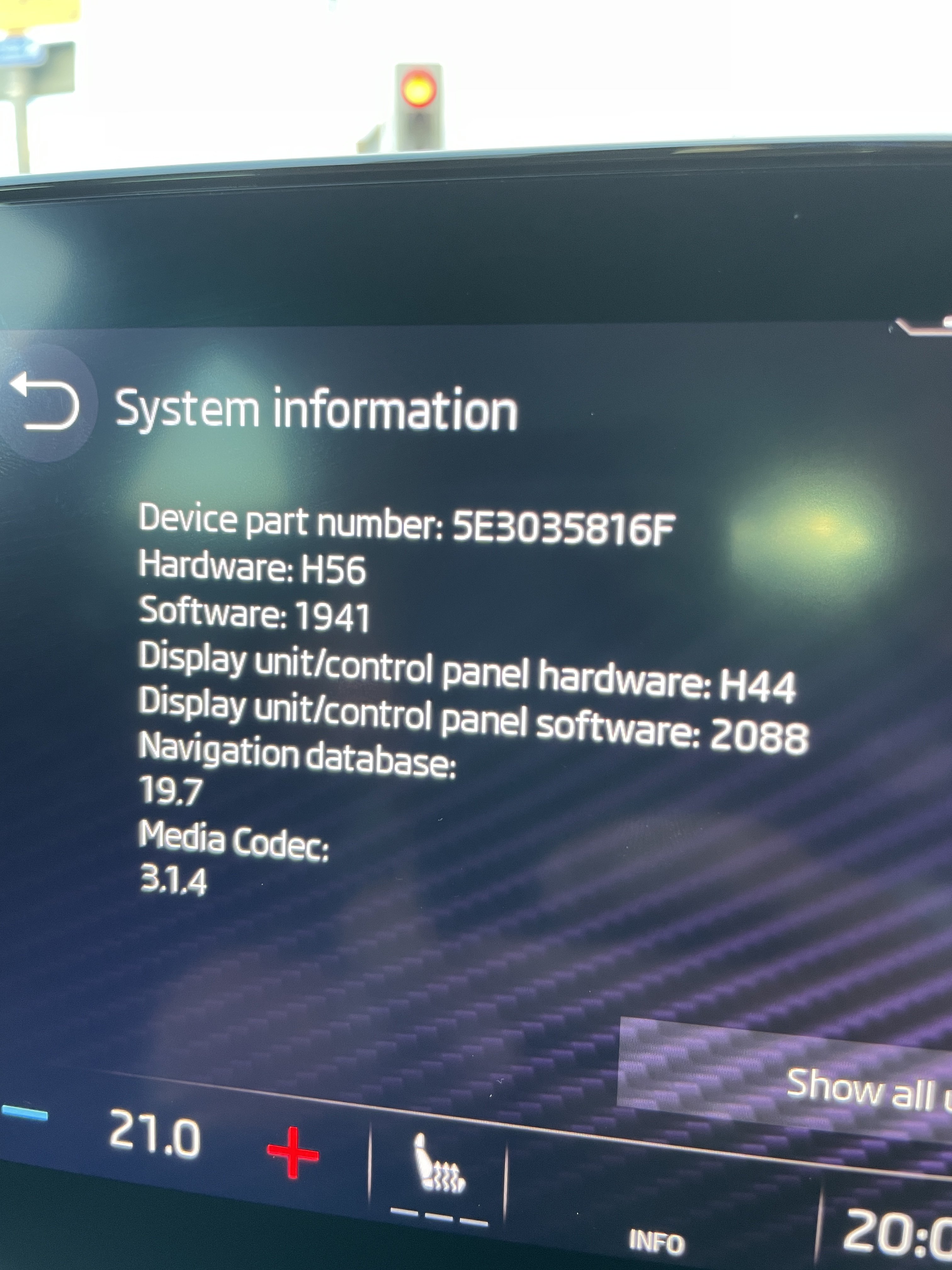

There's a suggestion that the 1941 SW resolves this issue. Do you know if this is the update they did?
I really can’t remember, I should have made a note. However, the update notes for todays update said that one of the fixes is “user registration” as well as the standard bugs and stability fixes. I’d have to go out and check my current version
SW 1941 is the latest update, so they DID install a SW update on your car. Updating OTA is normal after the installation of 1941, it's been mentioned several times on the other topic ("Infotainment reboot").
Since you have the latest SW, it would also be a good idea to update the Maps - yours are more than 3 years old; latest version is 22.12, released 23.06.
How do you go about updating the maps, my version is still 21.7

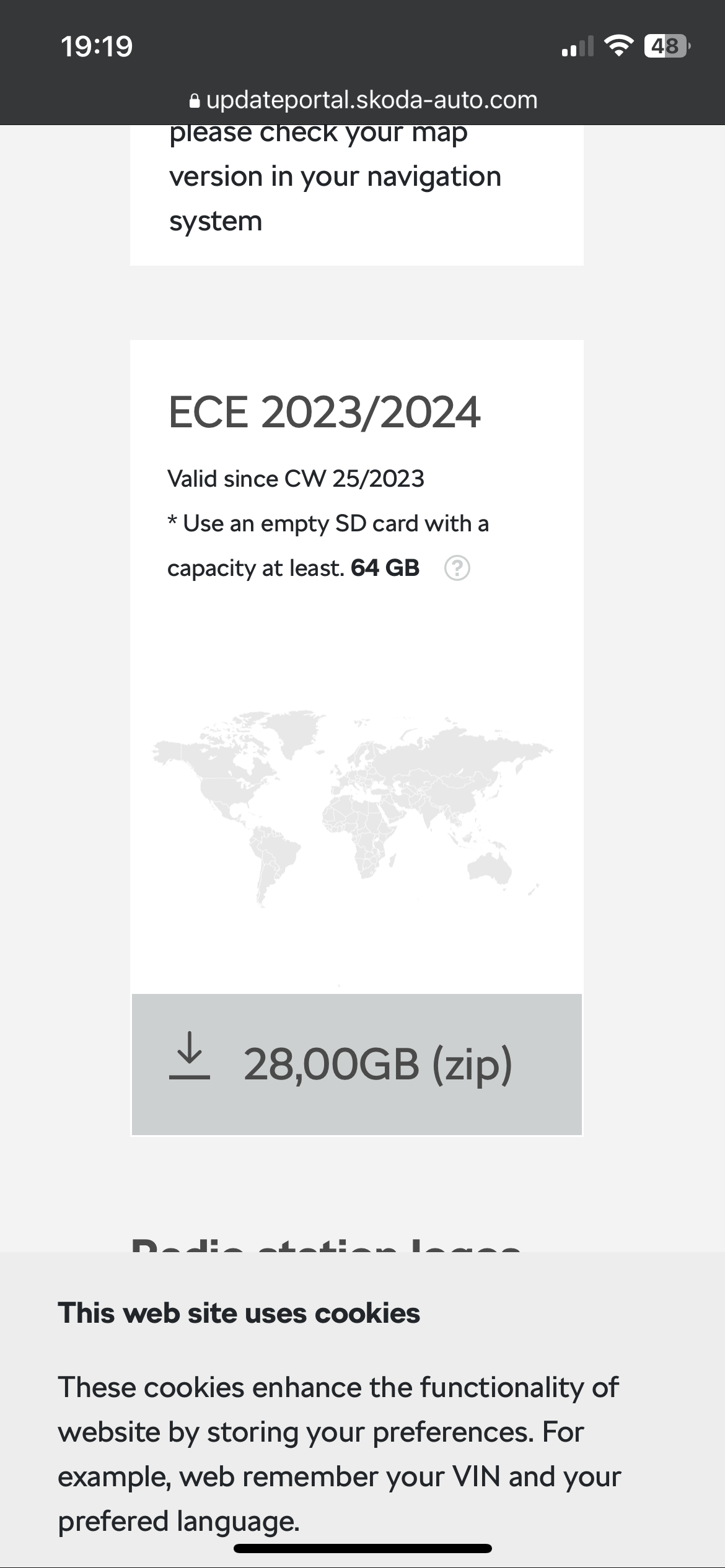

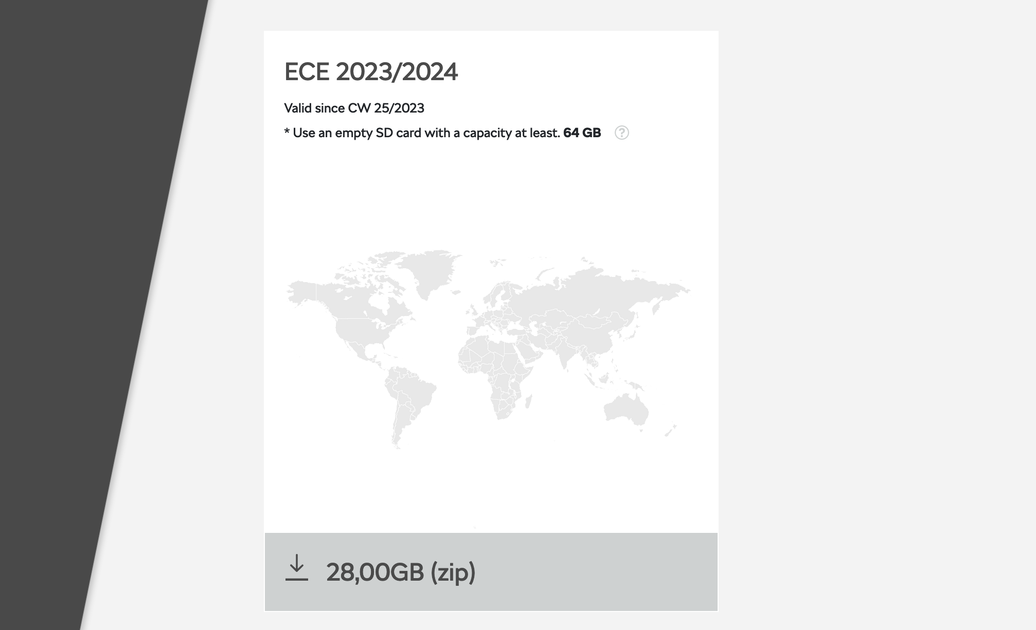

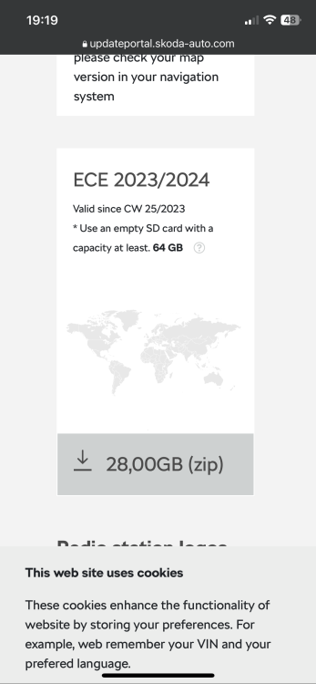

However, if your old version was 19.7 and now it's 21.something, it means the update was performed. But I'm puzzled why you didn't get 22.12 as most of us. What was the name of the map-archive you downloaded? Or the files after archive-extraction - map version should be inferred in the filename.
L.E. have a look at the image - when I try to download the maps it shows "Valid since" week 25.2023 - which actually means map version 22.12. Can you check what's yours?

I put my vin into the portal and downloaded the file it suggested;
I’ll try leaving the usb in longer and see what happens
Just gone out to check and it’s 22.12 now
